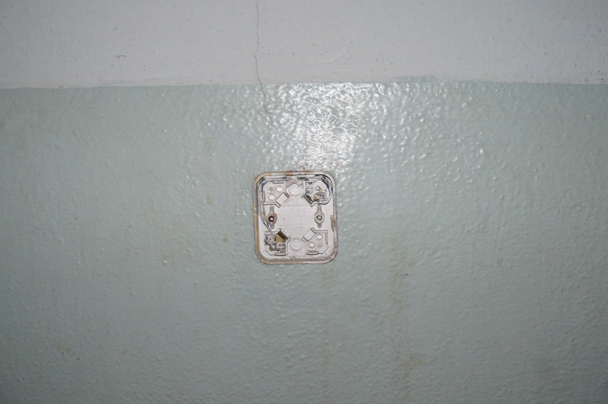

  • #35 14238687
    Łukasz-O
    Admin of electroenergetics
    Posts: 21786
    Help: 654
    Rate: 4286
    Drill without housing - button light:
    Pass-through Sockets Wiring: Safely Connecting 3x2.5mm² Wires for Daisy-Chaining
    PS
    It is a hardware in a large plate :D
