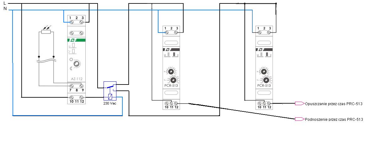

How can I automatically lower 16 roller shutters at dusk and raise them at dawn using momentary NO contacts that stay active for about one minute?
Use a small microcontroller or PLC with a twilight sensor and timed relay outputs so it can energize the lower/raise circuit for about one minute at dusk and dawn. One suggestion is a microcontroller reading a twilight sensor on an ADC and driving relays through transistors, with the output held for one minute [#14416529] Another is a small PLC with an analog input using a photoresistor voltage divider and relay outputs, or a commercial twilight automaton plus two timer relays set to delayed-off, one for lowering and one for lifting [#14418013] The key is that the control device should generate the short NO pulse and then release it automatically, so the shutter relays do not remain active. A ready-made twilight switch with a relay output was also suggested as a simpler off-the-shelf option [#14420058]

    Hello, and please help me to solve the problem of automatic switching on and off the external roll-down shutters depending on the time of day. I need an automatic twilight or similar system which would lower the roller-blinds in the whole house at night (there are 16 of them) using a NO contact which should hold for approx. 1 minute (this is the time of lowering the roller-blinds), after which the contact should disconnect. The problem is that at daybreak the second NO contact is to be switched on and should also hold for about 1 minute (this is the time for raising the shutters) and should also switch off after this minute. The whole system for lowering and raising the roll-down shutters is made up of relays. One part of the relays raises the roller shutters and the other part lowers the roller shutters and if any of the contacts were in the active state, there is no way to activate the opposite option. Thank you in advance for your advice.

    A second solution could be to use a twilight automaton, e.g. AZ112, and two time relays, e.g. PCA512; function: delayed off (one=lowering, the other =lifting....

    pafciowaw
    Automation specialist
    Posts: 2439
    Help: 480
    Rate: 365
    And something like this:
    What kind of system to use for automatic raising and lowering of roller blinds in the house j
    On F&F components.
