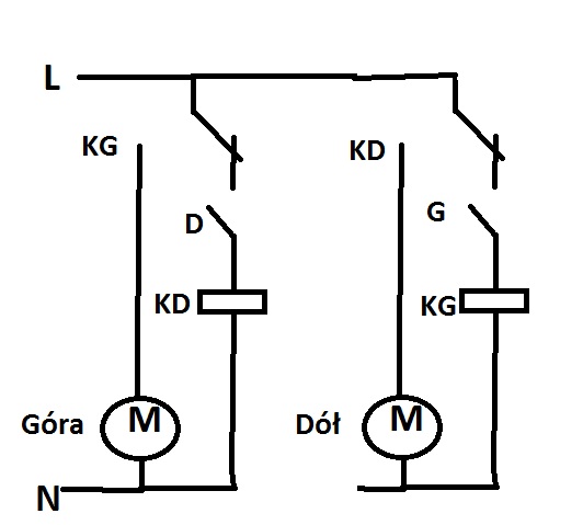

    I have started to design the installation with a roller shutter control system, however I have encountered a few problems here:
    - i would like the control to be possible using both pushbuttons on the wall and the raspberry, however I would like to prevent short-circuiting or overloading when current is applied to the opposite direction of rotation of the motor. (I have come up with a workaround - please give your opinion - fig.1)
    -I would like to somehow get information through the raspberry when the roller shutter is actuated by a physical button (so I would have control over the position of the roller shutter) - maybe you have some ideas ?

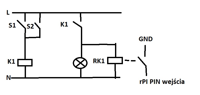

    Lighting control (led tapes and bulbs) I would like to do on relays (available with optoisolation protection on a popular auction site) here also a similar question arises - how to determine the current state of the bulb (on/off) so that it would be possible to control with wall switches at the same time ?
    Is it possible to solve this on standard wall switches, or do we need bell switches and bistable relays?

  • #2 14566271
    bi3dron
    Posts: 254
    Help: 24
    Rate: 22
    If you design the circuit well (hardware and software) then I think you could dispense with the manual/tiny control. You can always run all the cables to a single point and leave some small provisions there, then even from such a tiny one you will be able to convert everything to manual control without forging in the walls (just have to remember to have enough space).
    But as I write this post I am getting more ideas :P
    As protection for the roller shutters in the switchboard it is with NO-NC relays that you use a small safety loop (fig.1).
    Legend:
    KG, KD - relay (monostable) up/down (contacts and coils)
    G, D - keys for up/down control (in parallel to these you can add relays controlled by the raspberryPI).
    Raspberry PI - Home automation: Control of roller shutters, light, temperature and audio
    As for getting information to the rPI about manual activation of the roller shutters - you add another relay in parallel to the one from the roller shutter, which makes a shorted contact for the rPI (unless you are using contactors - then you only need an auxiliary contact).
    As for lighting - bell and bistable. Except that in order for the rPI to have information about whether the light is on, you will get this with the following drawing:
    Legend:
    S1 - bell button by the door
    S2 - bedside bell button
    K1 - lighting relay (bistable)
    rK1 - relay for feeding information to rPI (monostable) (makes contact for rPI input, I don't know if by shorting to ground, I used the arduino :P )
    And here, of course, you can also insert in parallel to S1 a relay from rPI (monostable e.g. for 1/2sec switched on e.g. for control via WWW/bluetooth etc).
    As for the display - I think it shouldn't be too much of a problem to even let it run on a twisted pair - IMO it will work.
    Only with the above junctions you lose such possibilities as e.g. distinguishing between long and short key presses etc.
