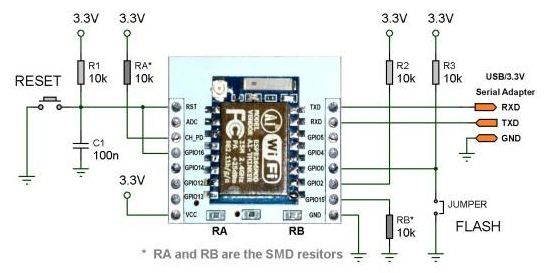

    Hello, I have purchased an ESP8266 model 07
    ESP8266-07 - why can't I connect to the ESP8266-07 via UART flasher?
    I can't bloody find a wiring diagram for it so I'm relying on wiring diagrams from other varieties of ESP8266.
    On the drawing I've drawn how I've connected it, in green there are elements connected alternatively e.g. (GPIO0 - for flashing, reset once with a resistor once without, CH_PD to 3.3v once directly once through a resistor).

    "Pinology" you have got right, ESP-07 certainly has the leads as you have drawn.
    But:
    1.Reset is active high state, so don't connect it at all ( or give it to ground).
    2.TXd and Rxd are the physical signals of the module, I hope you connected this adapter "crosswise".
    3. Leave GPIO0 unconnected, low state on it is only needed for programming 0 it is internally pulled up to Vcc.
    4. You may have set different speed of internal UART: 115200, 9600, or some other: depending on firmware. Give AT+RST - the module should respond.
    5. For your first attempts, use either a terminal, some simple one like Putty for example, or ESP8286Config - quite a friendly software.
    Regards, QuadMna.
    You are searching poorly...
    esp8266-esp-0712-full-io-breadboard-adapter
    Reset is active high state, so don't connect it at all ( or put it to ground).
    High? Since when? The Chinese vulture on resistors, so the RST must be externally pulled up to +.[/quote]

    Hello!!!
    Mate instead of connecting the Reset connect +3,3 on GPIO2...it starts immediately!!!

    I used this Chinese diagram and it certainly worked the version with the white antenna.

    The ESP8266-07 is quite specific when it comes to connecting. I also waged war with it for probably two days, but finally got it right. The best thing is that how to connect in a specific mode is not too much on the net. So yes: 07 is connected differently if you want to program and differently if you want it to work with already uploaded soft. In programming mode, the software will load and run, but after a reset, the program will not get up but the chip will wait for the software to load.
    If you want to upload the soft, you connect:
    (ESP) RX -------- TX (FT232)
    (ESP) TX -------- RX (FT232)
    (ESP) GND ------- GND (FT232)
    (ESP) VCC ------- VCC 3.3V (FT232)
    (ESP) EN -------- VCC 3.3V (FT232)
    (ESP) GPIO0 ----- GND (FT232)
    (ESP) GPIO15 ---- GND (FT232)
    If you want to run in normal mode i.e. run the program from memory:
    (ESP) GPIO0 ----- VCC 3.3V
    (ESP) GPIO2 ----- VCC 3.3V
    Obviously the EN (i.e. CH_PD) should be connected via a resistor, although give it directly to start with, as I found it could go crazy with a resistor.

    Flashing without 3.3V on GPIO2 doesn't get things going....
  • #17 16978742
    m.biruta
    Posts: 479
    Rate: 32
    That's right, you still need VCC on GPIO02!
