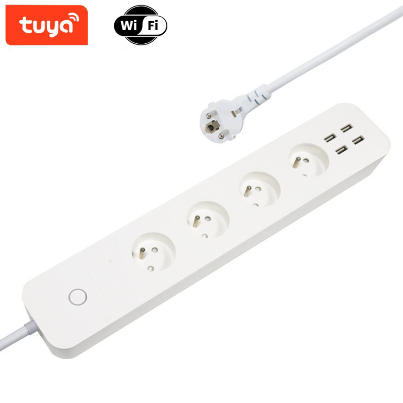

Not sure this is the right way to submit, but I would like to report that I successfully converted the Immax NEO Lite Smart Plug:
It uses the WR3E (RTL8710B) with the BL0937 for power measuring.
The config is the same as this other similar plug: https://www.elektroda.com/rtvforum/topic4157661.html
The only issue I currently have is the LEDs (one per plug plus the 2 generic ones) not working, I think at least.

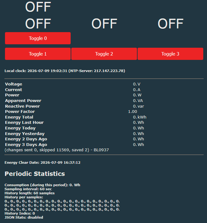

The default UI is slightly bugged:

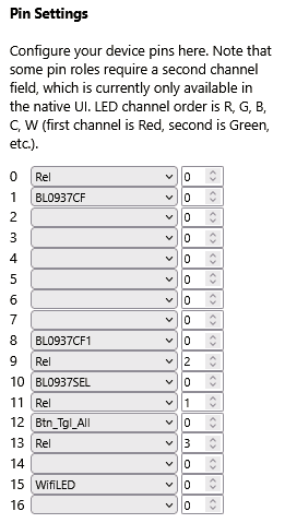

Can you post your current OpenBKN template/GPIO config, including the roles assigned for relays, buttons, BL0937 pins, and all LED pins?
"vendor": "Immax",
"bDetailed": "NeoLite",
"name": "Immax NEO LITE Smart Plug 4AC + 4USB, WiFi, TUYA",
"model": "Neo Lite",
"chip": "RTL8710B",
"board": "WR3E",
"flags": "1024",
"keywords": [
"RTL8710B",
"Smart_Plug",
"4AC"
"pins": {
"0": "Rel;0",
"1": "BL0937CF;0",
"8": "BL0937CF1;0",
"9": "Rel;2",
"10": "BL0937SEL;0",
"11": "Rel;1",
"12": "Btn_Tgl_All;0",
"13": "Rel;3",
"15": "WifiLED;0"
"command": "backlog startDriver BL0937; startDriver NTP; SetupEnergyStats 1 60 60; PowerSave 0",
Which OpenBKN build/version are you using, and can you share a screenshot or short description of what exactly is bugged in the default UI / how the LEDs behave?
OpenRTL8710B_1.8.298.bin.
