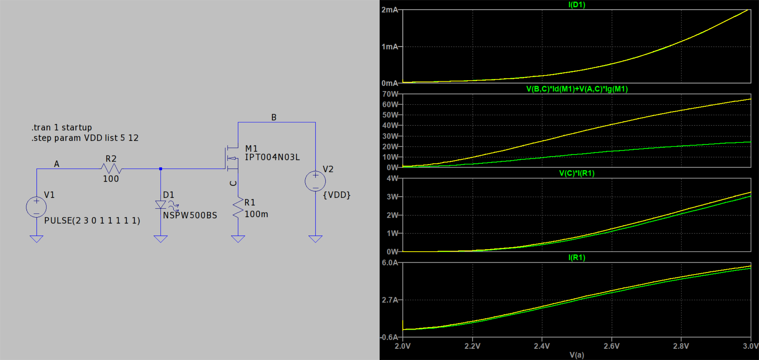

  • MOSFET-based active load with ESP32 current control
    #3 21936366
    gklub
    Posts: 1782
    Help: 306
    Rate: 762
    uasic wrote:
    This is about regulating the maximum current supplied by the step-down converter
    It couldn’t be simpler ;)
    It’s not a very precise load, but combined with an ammeter it should be sufficient.
    LTspice schematic with IPT004N03L MOSFET and plots of current and power for VDD 5 and 12 V
    Essentially, you need a variable resistor and an ammeter.
    You can’t buy a 100W potentiometer, but a MOSFET can act as a substitute.
    Its ‘resistance’ is controlled by the gate voltage.
    Note how little the current depends on the supply voltage – here 5 and 12V.
    In such a circuit, the permissible supply voltage (of the converter under test) is limited by the permissible gate voltage – see the catalogue.
    The transistor used here, with a suitable heat sink, will handle 300W.
    A source resistor, e.g. 100 mΩ/10 W – theoretically, it could be omitted, but it makes control much easier.
    Resistor R2 and the diode limit the gate voltage and thus the power transistor’s current to safe levels, even in the event of incorrect voltage control at point A.
    You supply the control voltage from the ESP to point A, replacing V2 in the converter.
    You can use a different, similar transistor, but you’ll need to set the control voltage range for the specific unit you’re using.
    If you want a better solution – see Howlwnd’s source.
    There’s been quite a lot on the forum, including in recent weeks.
