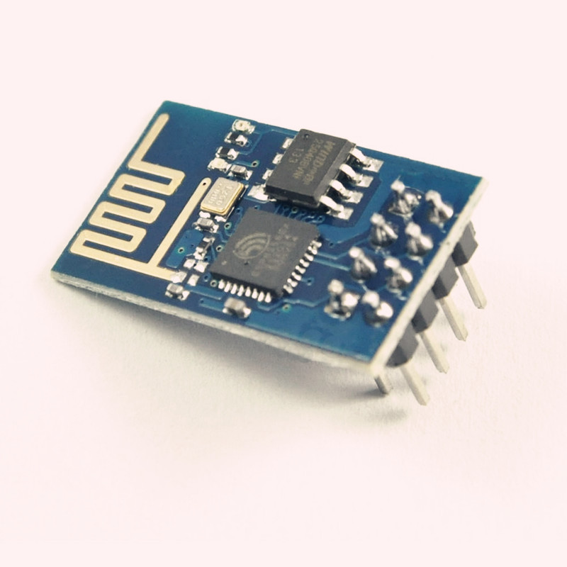

    Just as an incentive, I'd like to show a mini tutorial on how to start creating your own IoT using the RPi and ESP8266.
    I purchased some ESP-01, ESP-12 modules from a well-known non-native portal ($2-4). The example is based on the ESP-01. Important to remember that ESP does not like a power supply above 3.3V and thus appropriate voltage levels on the serial port are required.... voltage matching is automatically provided by the Raspberry RPi - hence the adventure should start by connecting the ESP to the Raspberry.
    It looks like this:
    How to get started creating IoT with ESP8266 and Raspberry Pi? A mini tutorial for beginners

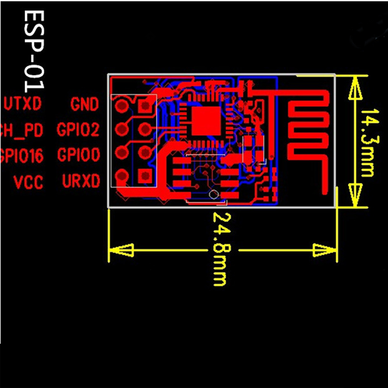

    Module pinout:

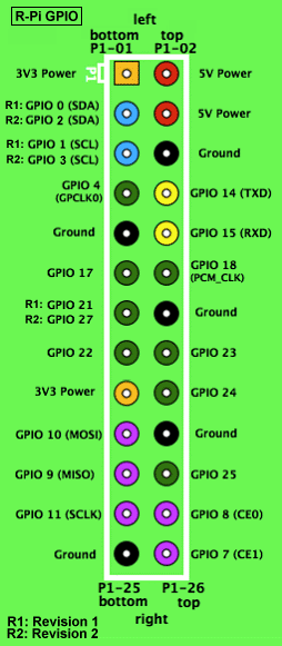

    Now it's time to connect the ESP8266 to the Raspberry.
    The connection is trivial, we connect respectively RX, TX, GND, 3V3 Power from RPi side to UTXD, URXD, GND and UCC ESP chip, it is still necessary to connect permanently CH_PD to UCC and take care to temporarily connect GPIO0 to GND - we will need this in the ESP flashing process.
    Pinout of the Raspberry's P1 port:
