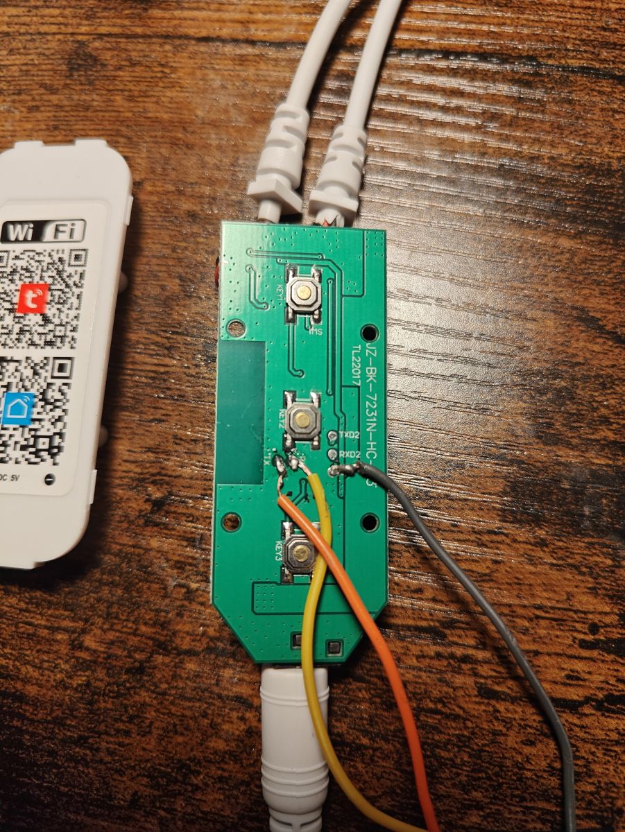

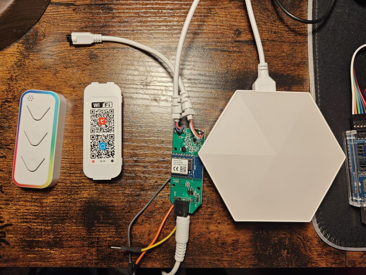

    I've been playing around with a set of RGB hex lights, and am hoping to get local control. The exact brand is unknown, but both the lights and controller look identical to this listing on Amazon. The lights connect to each other and the controller with USB-A connectors, but the actual protocol is an unknown 3-wire addressable RGB protocol.
    I opened up the controller and found a CB3S (BK7231N) module inside, along with test points for RX1/TX1, RX2/TX2, and GND, making it quite easy to flash OpenBeken. I attempted to dump the original firmware, but the process repeatedly failed at 1%, so I guess I'm starting from scratch. So far, I've identified the following connections:
    ItemPin
    RGB Data9
    Power Button14
    Mode Button8
    Music Button7
    IR Receiver26
    Getting the buttons to work was relatively easy, but I've been unable to get the lights to do anything. The hexagon modules seem to be glued together, and I don't think I can get one open to see what chip it uses without destroying it. Additionally, most of the 1-wire RGB drivers in OpenBeken seem to require the use of the SPI, which pin 9 is not capable of. The RGB data wire is connected directly to pin 9 through a 100 ohm resistor. Any ideas on figuring out how to drive the RGB?
    AI: Do you have any scope/logic-analyzer captures from pin 9 while the stock controller is running (for example, when changing color/mode/brightness)? Even a rough timing screenshot would help narrow down whether it’s 1-wire, UART-like, clock/data, etc.
    I unfortunately do not have access to a scope, and even if I did I've already flashed OpenBeken onto the controller so I can't investigate the stock behavior any more.
    AI: Can you confirm what the “3-wire” actually is between the controller and the first hex tile — just VCC/GND/data, or are there separate data/clock lines — and does the original controller still drive the lights normally so you can probe it in a known-good state?
    It is just VCC, GND, and data. I don't know if this is useful, but the data pad on the board is labeled "ASD"

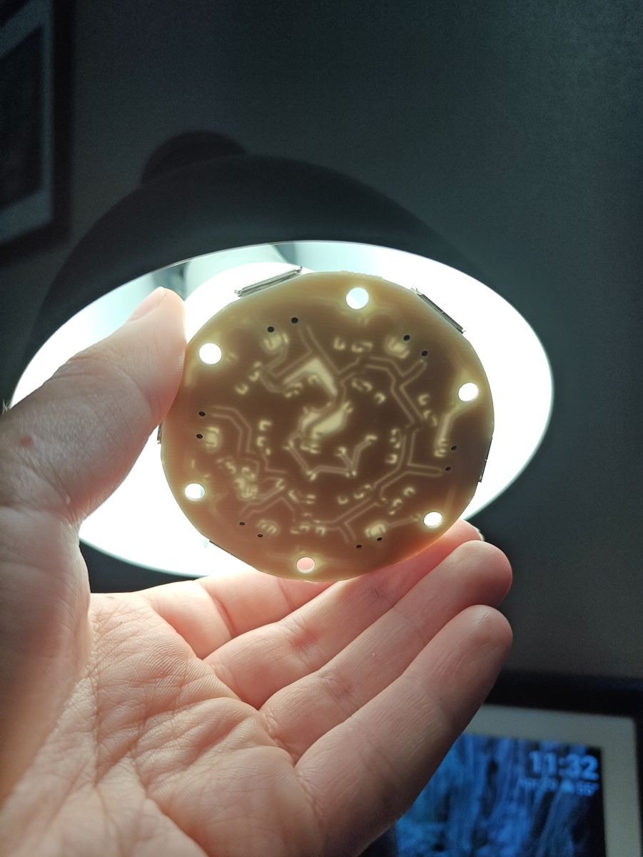

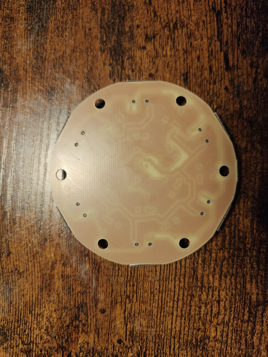

    I did not manage to get a factory boot log before flashing, but I was able to get the Tuya config data.

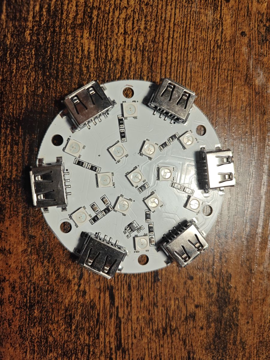

    After applying a lot of isopropyl alcohol to soften the glue, and a bit more force, I did manage to get one of the lights open after all. Inside are 13 LEDs, some miscellaneous surface-mounted components, and a 5-pin IC labeled AC21. Since it was a single-layer PCB, I was also able to shine a light through it to get a better sense of the traces.

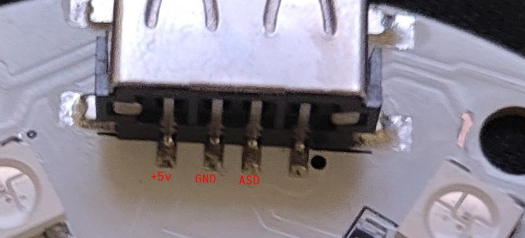

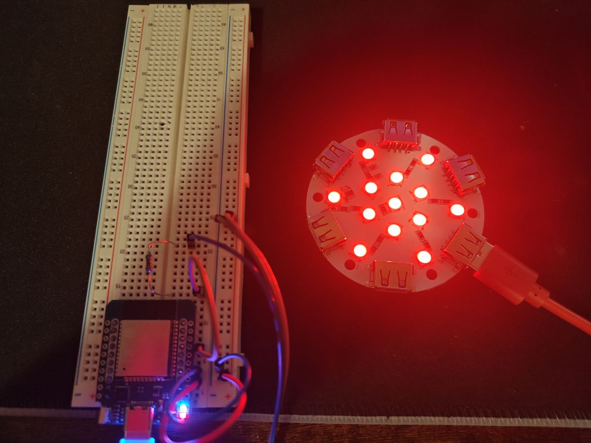

    I hooked the panel up to an ESP32, and it worked! I was reading about the various addressable RGB drivers in OBK, and realized that they are almost all hardcoded to use hardware SPI (Pin 16), which is not exposed at all on the CB3S module. I also checked the ESPHome drivers, and the BK7231N ones had the same limitation. Since my board drives the RGB via Pin 9, I figured it wasn't going to work even if my panels used a common chip.
    After hooking it to an ESP32 dev module, I pretty quickly got one of the panels working. Turns out that each panel has a WS2812 clone. The panels run on 5 V power, but the data line seems to be 3.3 V tolerant. Is there any way to get OBK to support these on P9, or am I better off just 3D printing an enclosure for the ESP32 and using that?

    interesting! Maybe there was some bit-banging driver thing going on in the factory firmware for this to be made possible on the CB3S. I'm not aware of addressable LEDs being driven on any pin but P16/MOSI on BK7231N before because it's the only one that supports hardware SPI. Maybe @insmod @p.kaczmarek2 agree or have other ideas

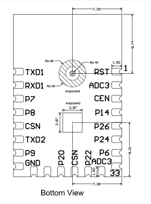

    @ScanuRag
    Can you confirm that data pin is P9 and how many LED does that device control - is it less than 50??

    Yes, I can confirm that it used pin 9, and the only thing between the pin and the output is a 100-ohm resistor. Each panel acts as single addressable unit. It came with 6 panels, but the product page says the controller can drive as many as 20.

    Thank you, that makes sense then. They are using software bit-bang that works reliably up to 20 LED's, up to 50 if doable but problematic.
    OBK can, with the HW mod to CB3S (since it doesn't have P16 exposed), reliably drive 200+ LED's - personally tested on my own setup.
    link to mod - https://www.elektroda.com/rtvforum/topic4005865.html#20790939
    Need to mention that the mode can be tied in to P9 in your case to avoid modifying anything else in circuit.
