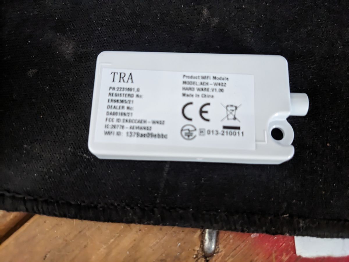

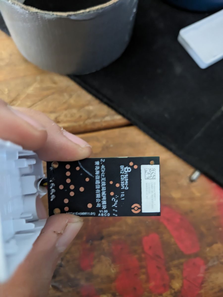

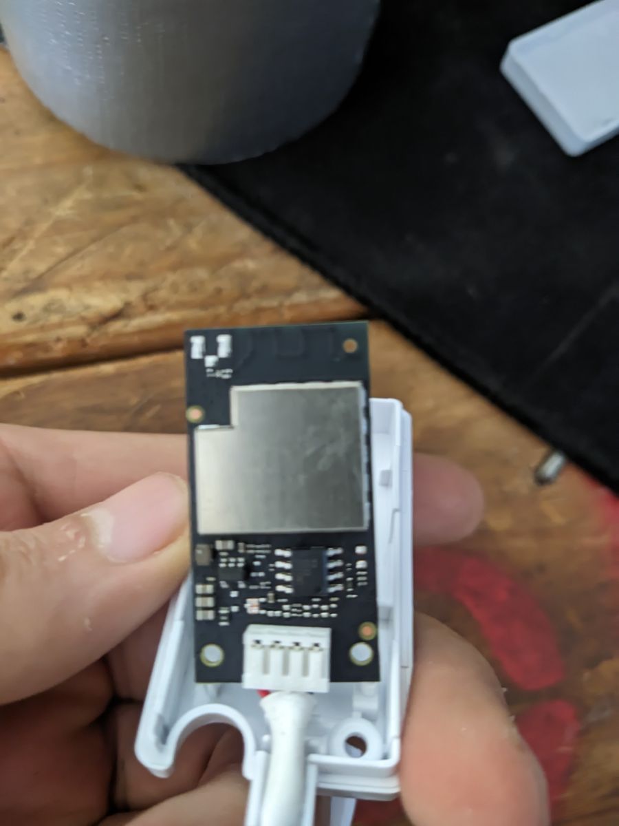

    royeiror
    I have a Frikko branded Split unit that uses the ConnectLife App, my guess the unit is actually manufactured by Hisense and the other name is just pasted on it. I control it through Home Assistant via a HACS integration.
    https://github.com/Connectlife-LLC/HomeAssistantPlugin/
    This may give you further information to complete your protocol reverse engineering
  • #3 21928397
    DeDaMrAz
    Posts: 621
    Help: 34
    Rate: 130
    I am aware of this and some other integrations but what I am doing is a replacement firmware for it and UART level decoding so these API integrations are of limited use.
    That being said I made some progress on the decoding part and I am working on decoding the command structure and initialization now, slow and painful but I will make it work with OBK and original module.
  • #4 21928398
    royeiror
    >>21928397 Nice, I“m not sure if your module and mine are the same, as soon as I get the chance I could share some photos of it.
    Hisense AC WiFi module/protocol reverse engineering Hand holding a small black PCB with printed markings, solder pads, and a QR code label. Circuit board with a metal shield and white connector, held in a hand above a wooden surface White TRA device: Wi‑Fi module with a label and CE markings on a black surface.
    Edit: Found them
