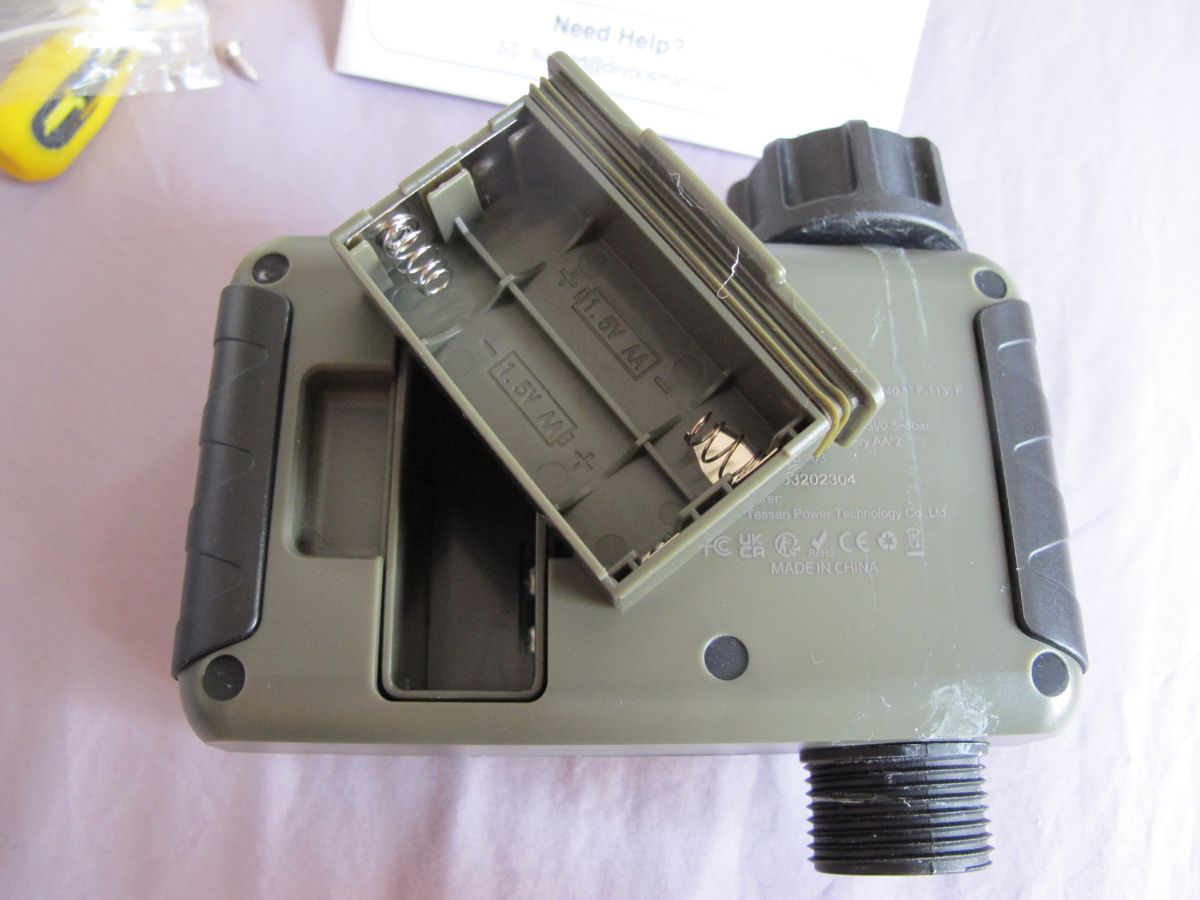

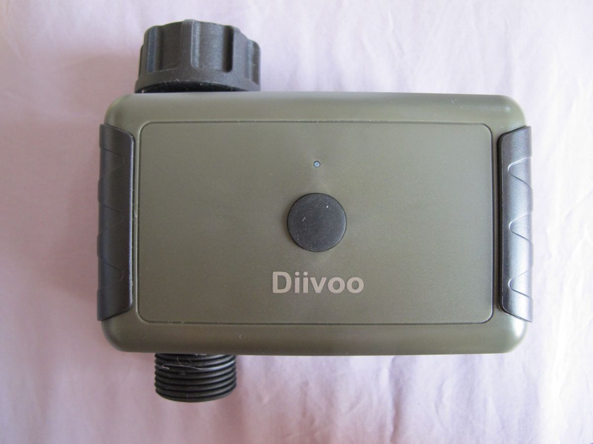

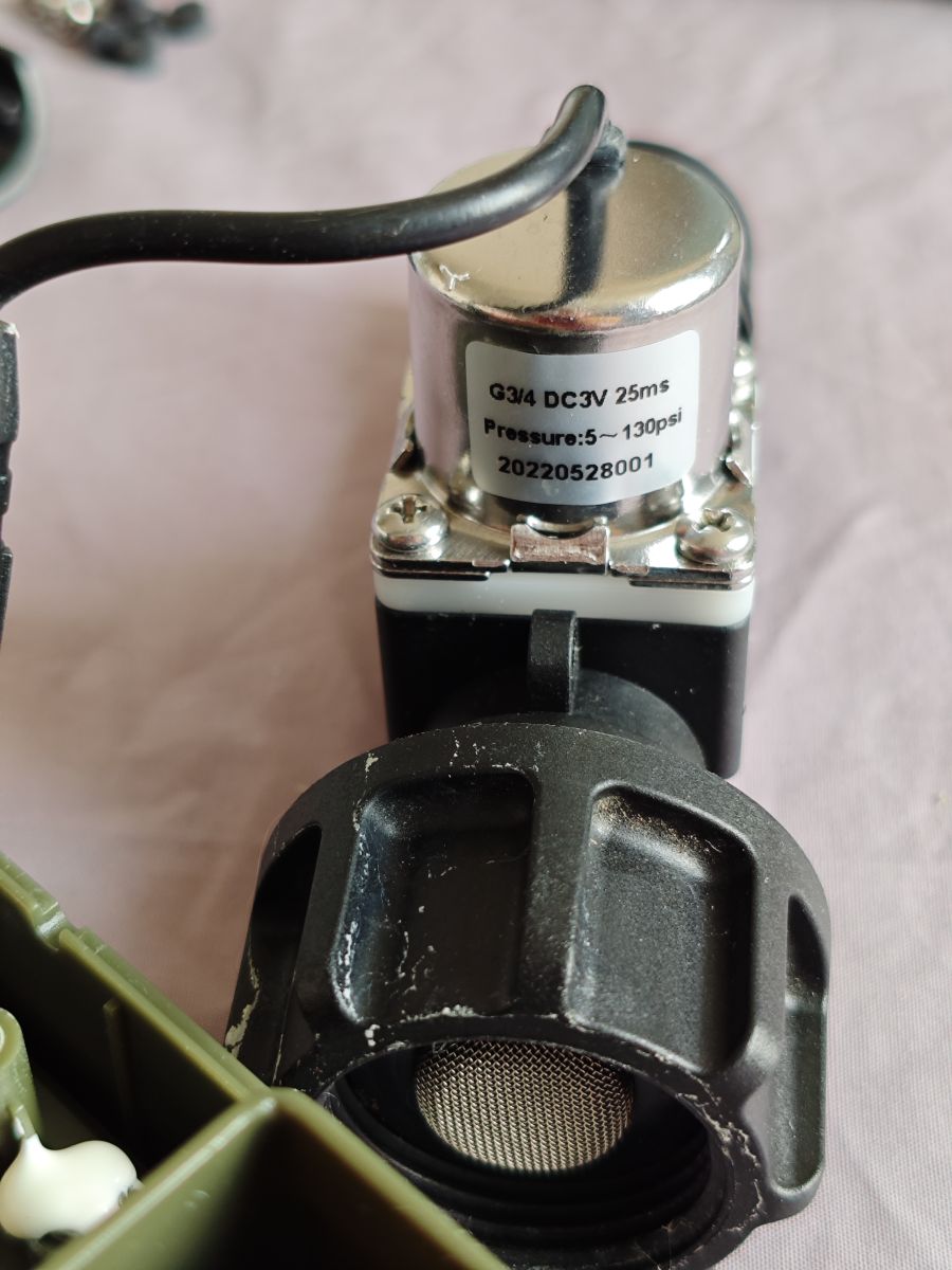

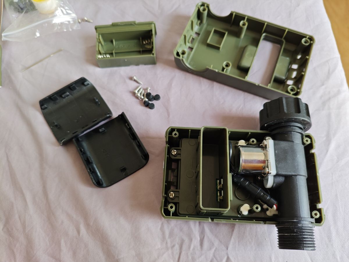

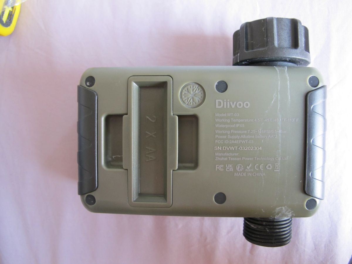

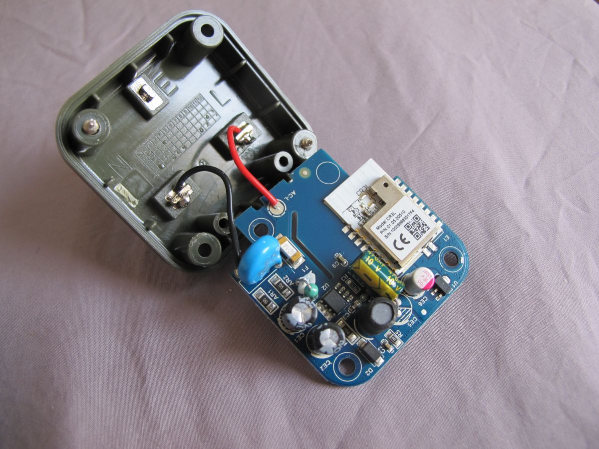

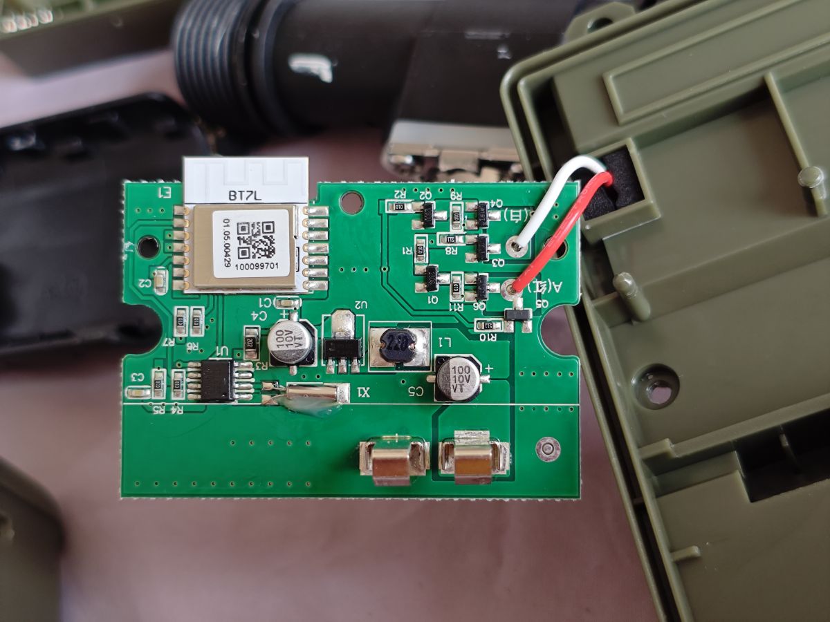

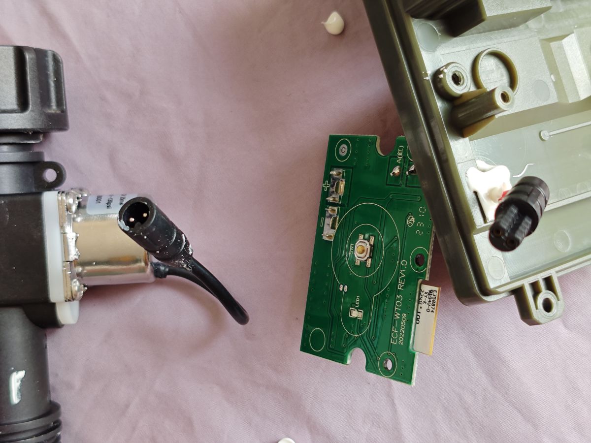

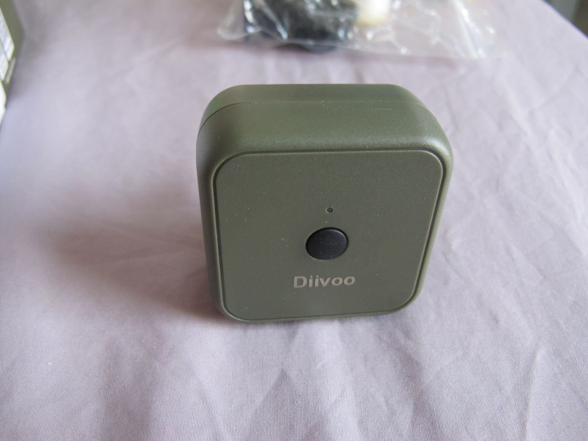

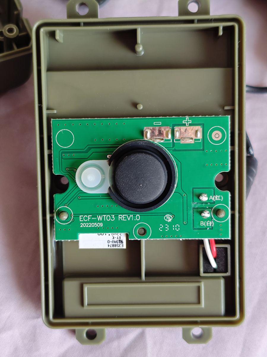

    Took a gamble on an ebay water irrigation valve in the hope I'd get a DCDC XR806 for testing.
    It didn't work out, but it's an interesting device nonetheless. Here's a dump of photos and logs. To be added to as I discover more.

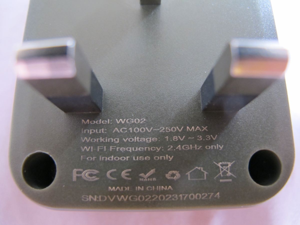

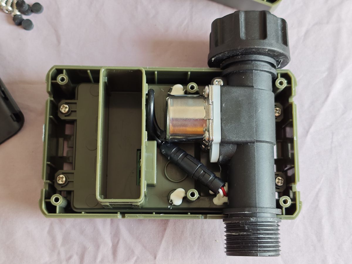

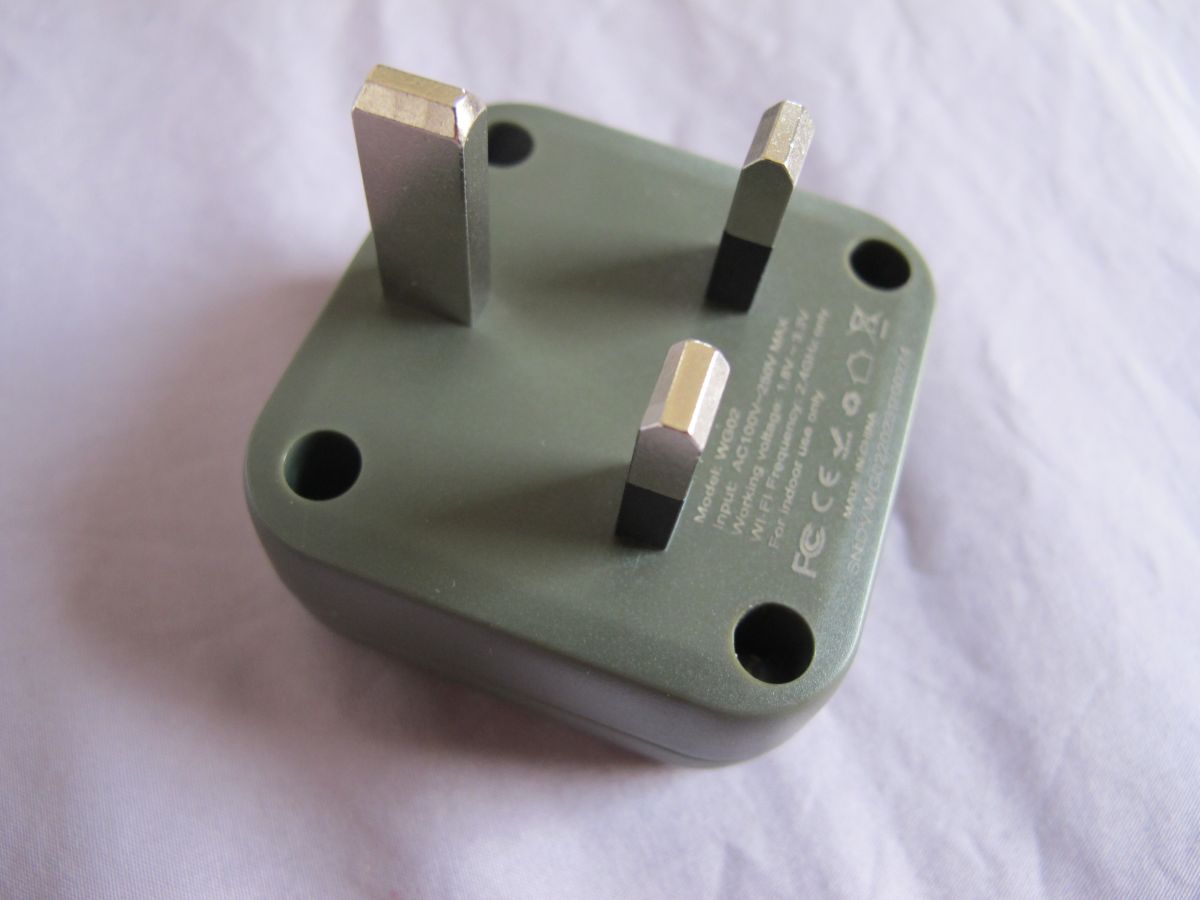

    Meet the Diivoo WT-03/WG02 single-valve smart irrigation device. Smart Water Timer

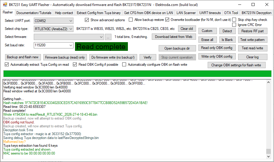

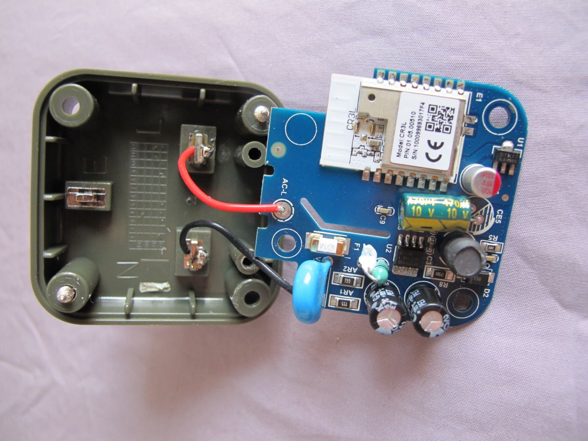

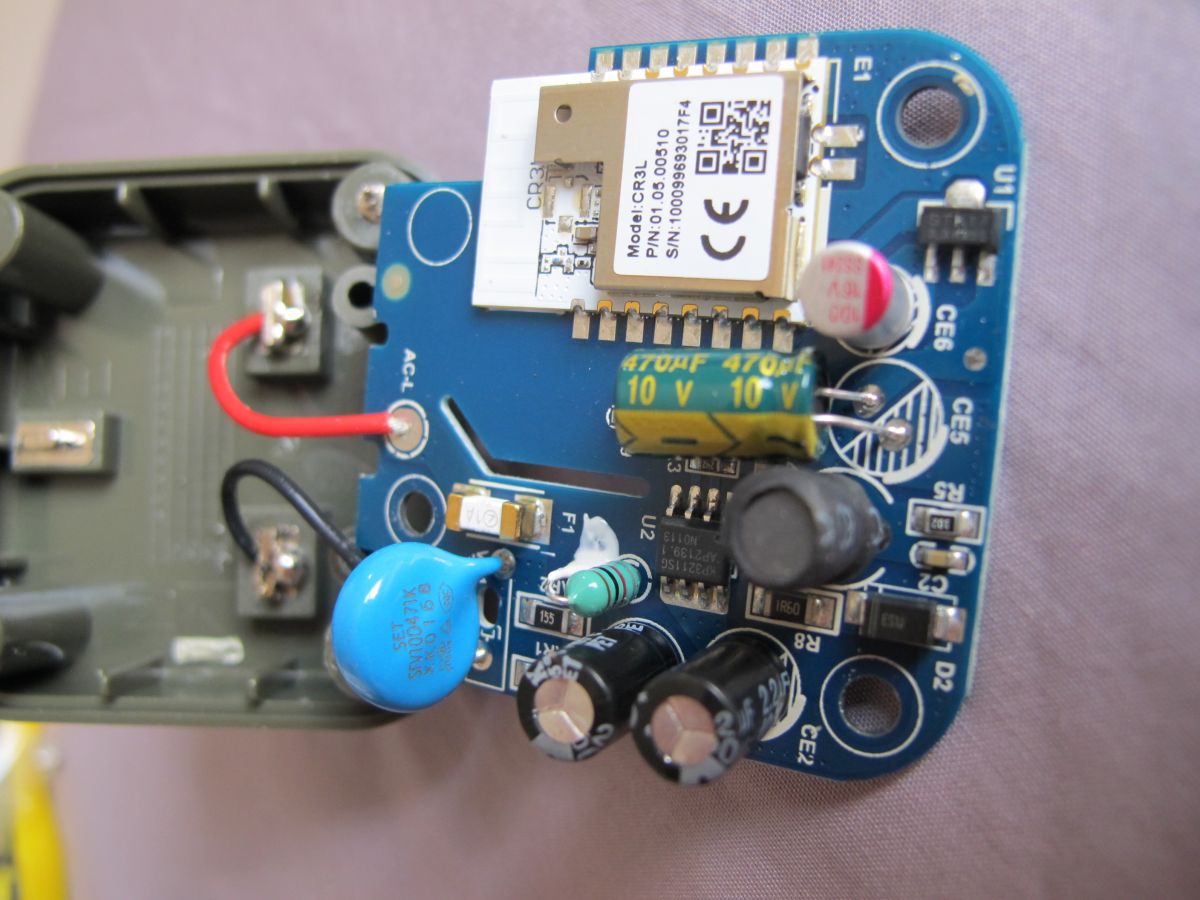

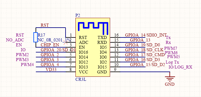

    boot log from CR3L A16
    Diivoo WT-03/WG02 Smart Water Timer teardown, photos, logs - CR3L/RTL8720CM/BT7L/TLSR8250

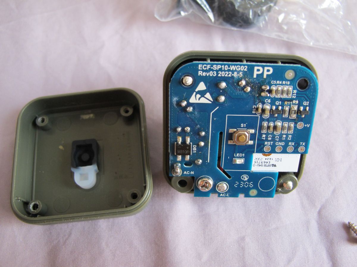

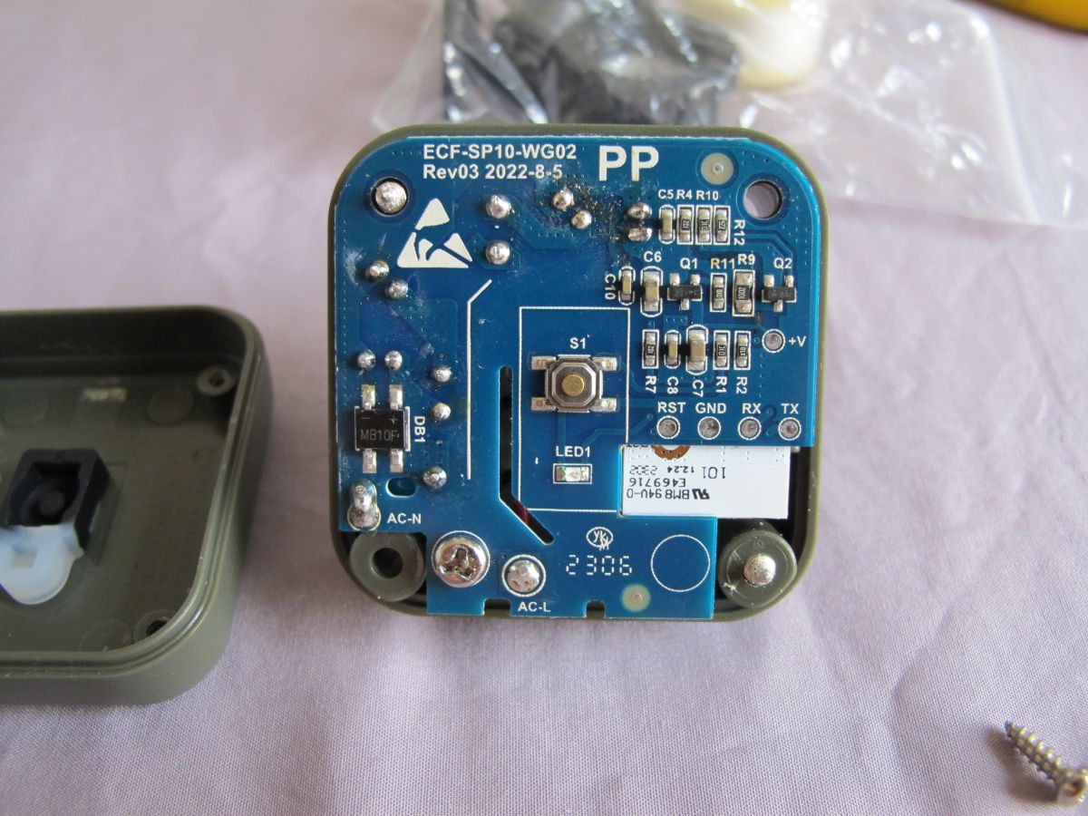

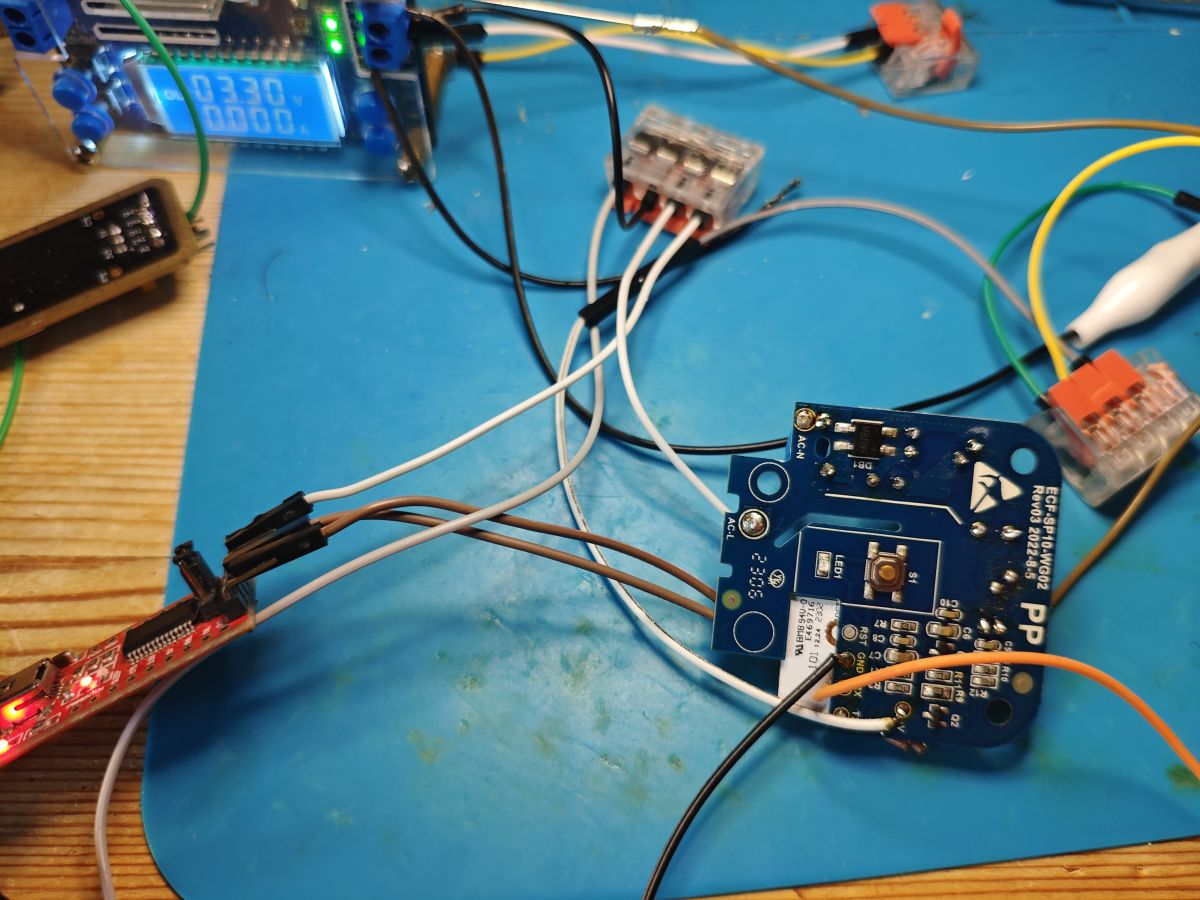

    A13/RX+A0 pulled high. EF firmware dump. AmebaZ2 family. CR3L = RTL8720CM = W701M-VT2-CG

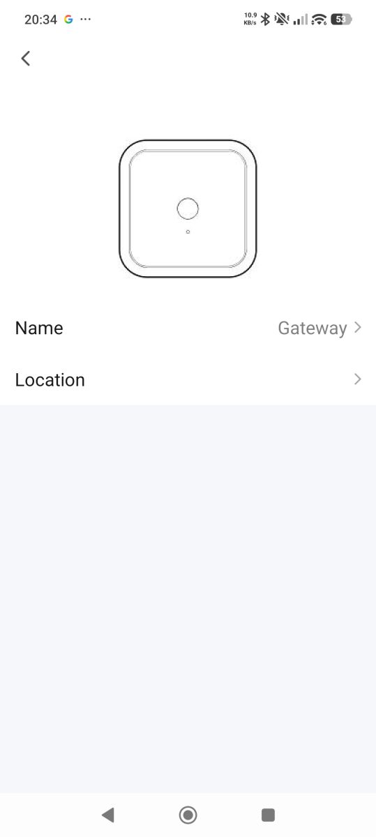

    Decrypted Tuya KV content
    Pairs with Tuya as a 'Gateway'
    Diivoo WT-03/WG02 Smart Water Timer teardown, photos, logs - CR3L/RTL8720CM/BT7L/TLSR8250Diivoo WT-03/WG02 Smart Water Timer teardown, photos, logs - CR3L/RTL8720CM/BT7L/TLSR8250

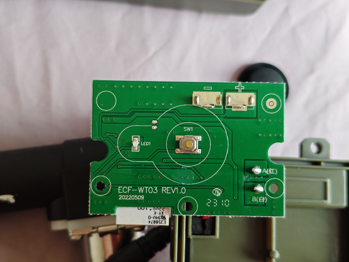

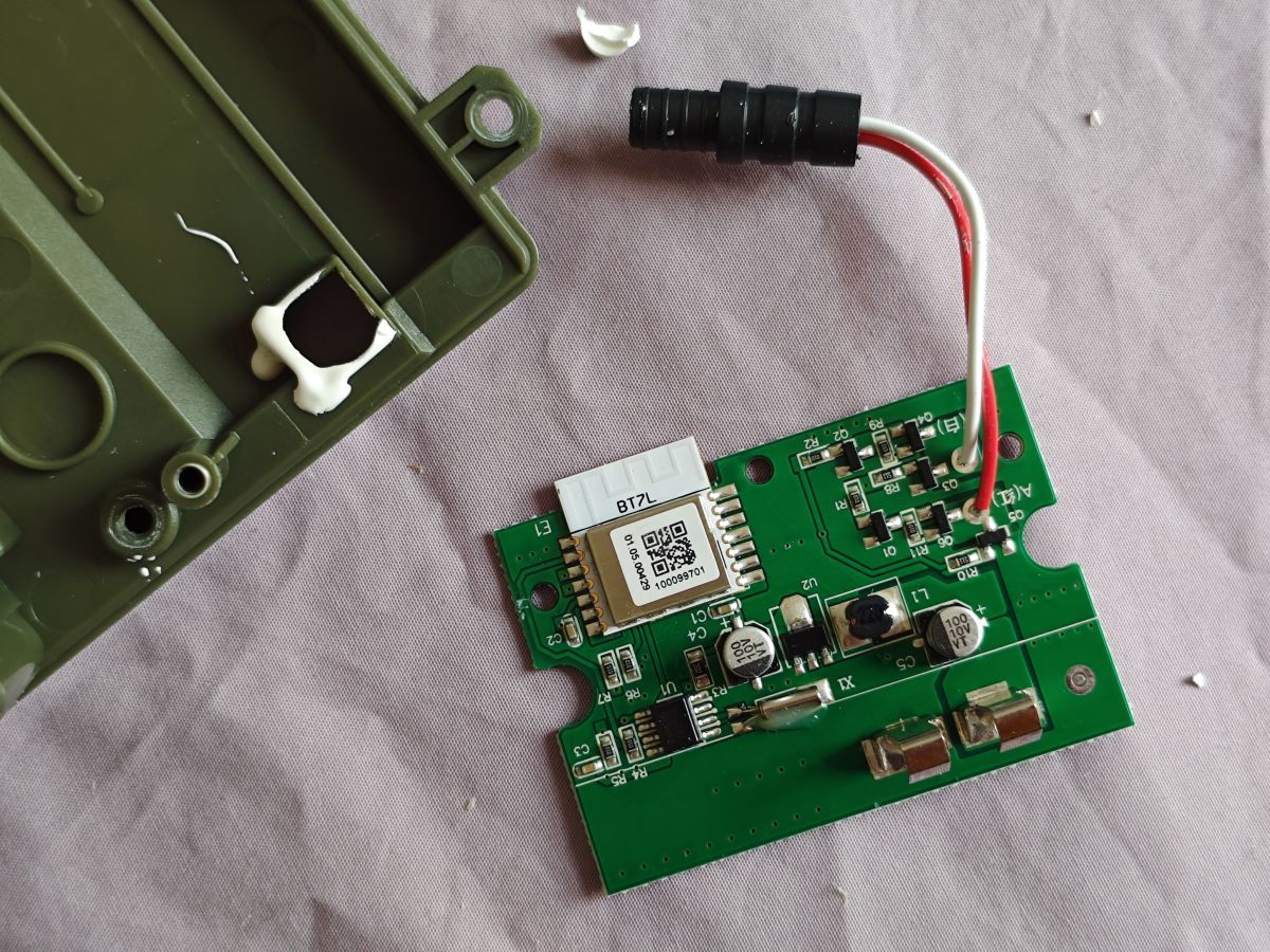

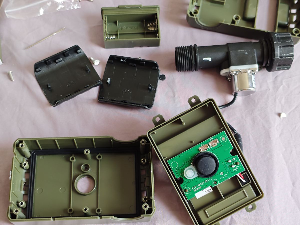

    later I will explore the BT7L/Telink TLSR8250F512ET32 side.
    keywords and bits:
    ECF-SP10-WG02 Rev03 2022-8-5
    ECF-WT03 REV1.0 20220509
    FCC ID:2A4EPWT-03
    Zhuhai Tessan Power Technology Co.,Ltd
    https://fcc.report/FCC-ID/2A4EPWT-03/
    KP3211SG (Kiwi Instruments PWM power switch)
    BM8563 (Gatemode RTC)
    CR3L dump: https://github.com/divadiow/FlashDumps/tree/main/IoT/RTL8720CM
  • STM32 bridge enables stable BT7L flash dump

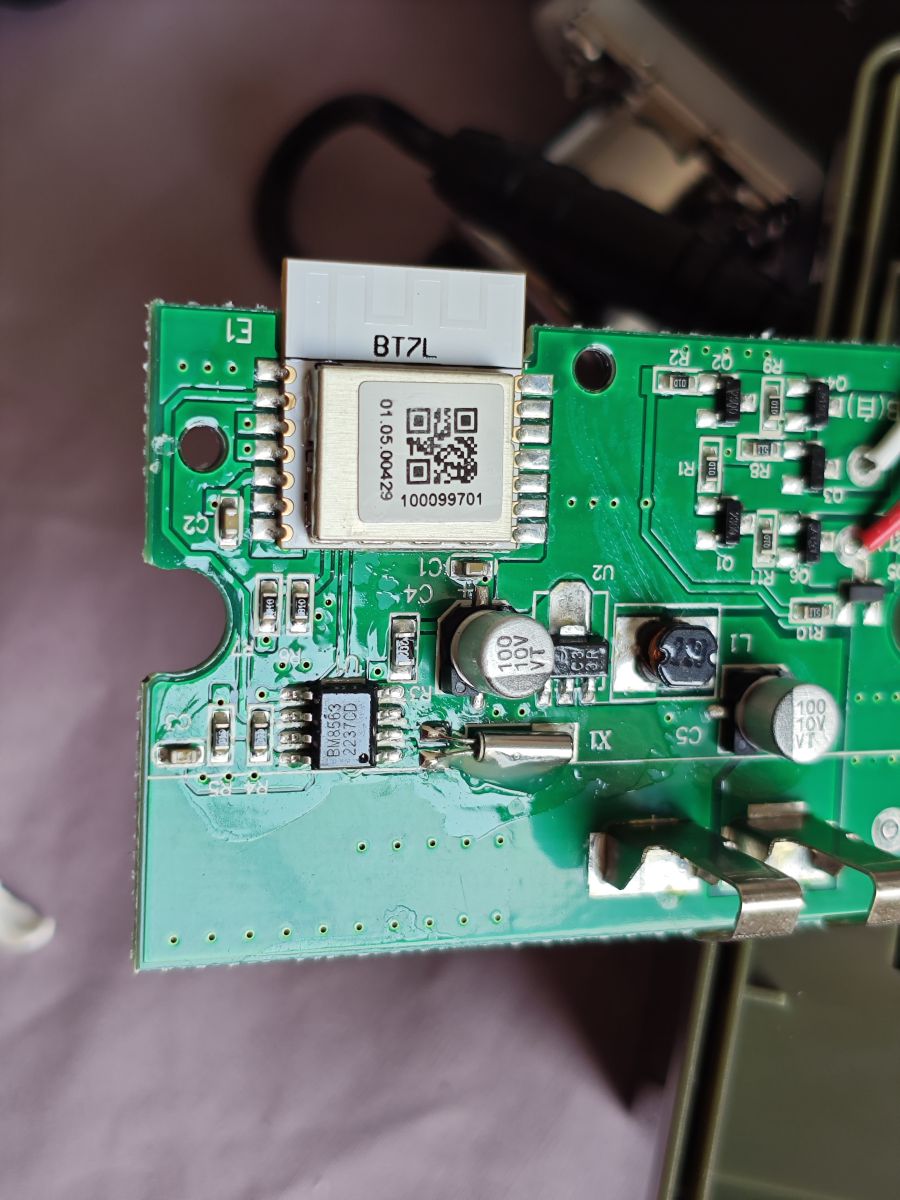

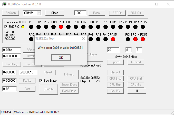

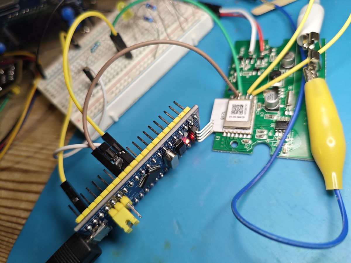

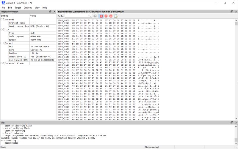

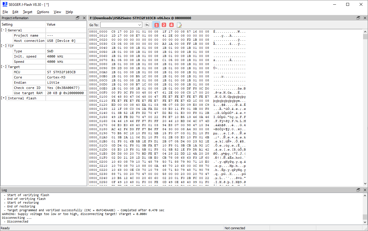

    For the BT7L/TSLR8250. I couldn't seem to get a stable read using the SWire/USB-TTL methods seen here and here with whatever TTL adaptor I used. Pvvx has an old STM32/Blue Pill option and I happen to have 2 STM32s not used for anything. The 3rd being reserved for CK-Link flash jobs.
    The same steps in the CK-Link post were used to flash USB2Swire-STM32F103C8-v06.hex using J-Flash 8.30 and a cheap J-Link clone

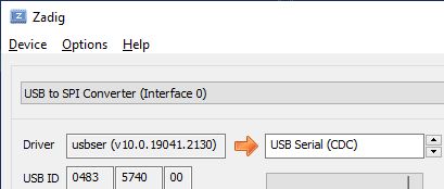

    on re-insertion of the STM32 after programming two unknown/error status devices appeared in Device Manager
    Pvvx's image here shows what to change the
    USB to SPI Converter
    to using Zadig
    With these files present locally, TLSRtool.exe can be run and connected to the BT7L for flash ID read and dump. TLSRTool config and dump steps here: https://github.com/pvvx/TlsrTools825x/tree/master

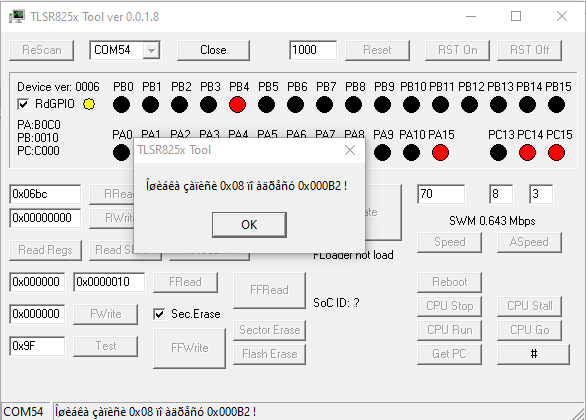

    Not content with the unreadable Cyrillic text spoiling the experience
    I got ChatGPT to patch all instances into English

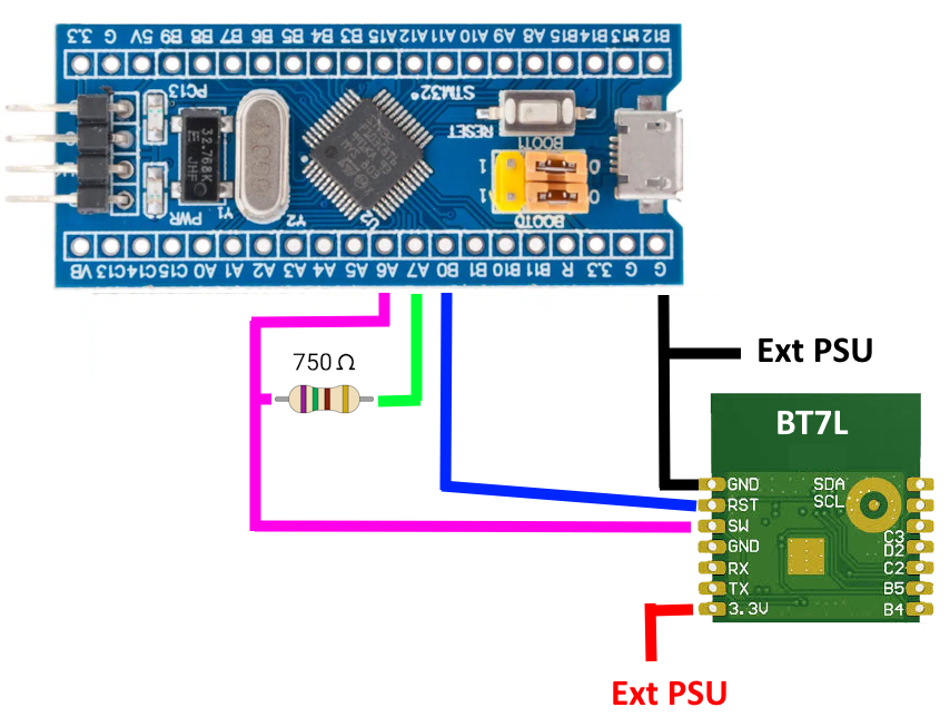

    This is how I connected the BT7L to the STM32
    Wiring diagram: STM32 board with micro‑USB and BT7L module, colored wires and a 750 Ω resistor, external PSU

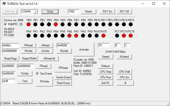

    I got away with 470Ω.

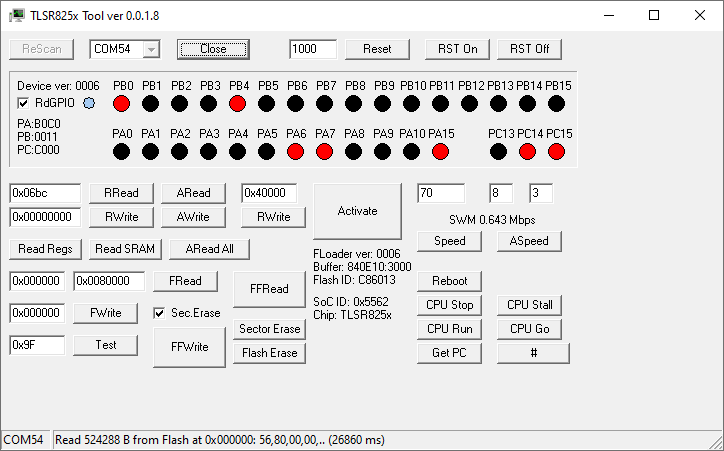

    Successful 512k read
    read file is here: https://github.com/divadiow/FlashDumps/blob/m...ater_valve_phase_two)_TLSR8250_BT7L_1.0.2.bin
    that's all for tonight.

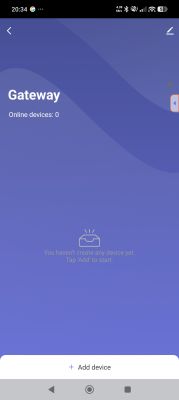

  • Two-module pairing via Tuya gateway and valve unit
    #4 21893040
    Posts: 5220
    Help: 449
    Rate: 918
    So basically... it's a two pieces set with two different modules? Well I think I may need to see manual of that to get a grasp of the functionality.

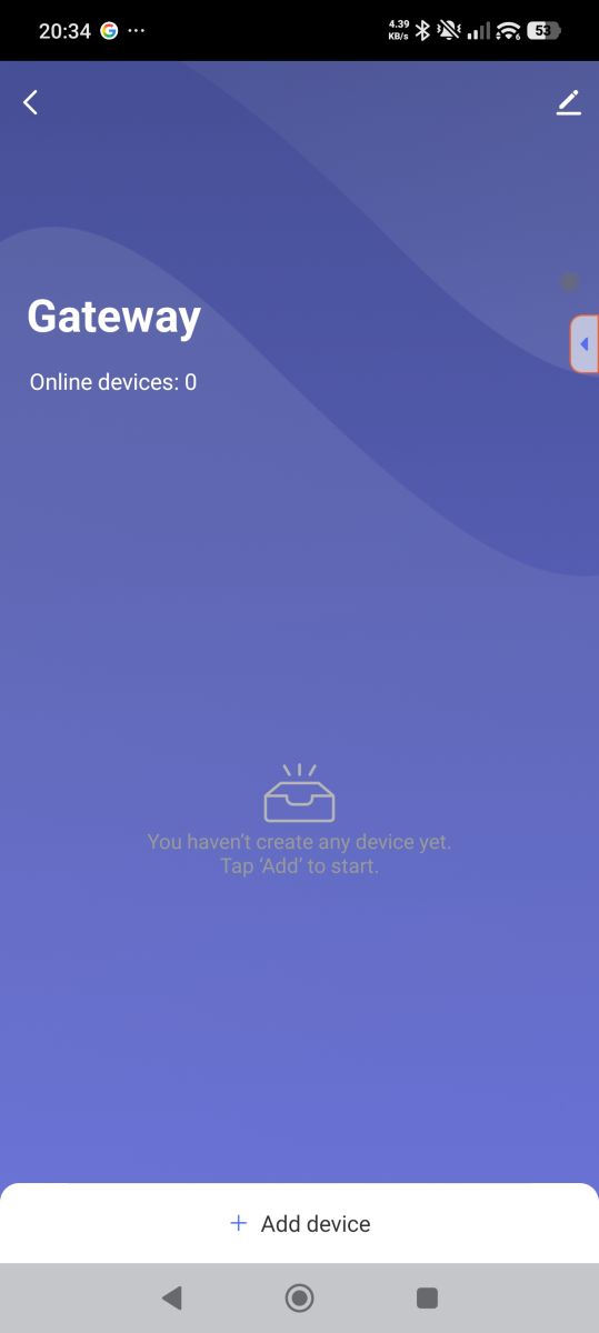

    yes. after pairing the WG02 (plug part with CR3L) with the Tuya app you then 'add device' to the gateway to discover the WT-03 BT7L valve part. I have not replicated real operation yet so could put it back together to demonstrate, though Diivoo do have a YouTube channel, complete with nauseating royalty-free backing music https://www.youtube.com/channel/UC-rdA7rXtm4tCvm3EdkGqEA

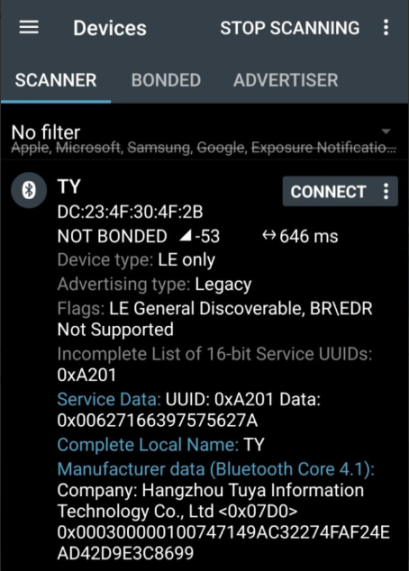

    when in pairing mode the BT7L advertises as such:
    and in the CR3L dump from
    0x3C5000
    you can see several records for the paired BT7L device
    mac, product key line up with what's seen in the BT7L dump.
