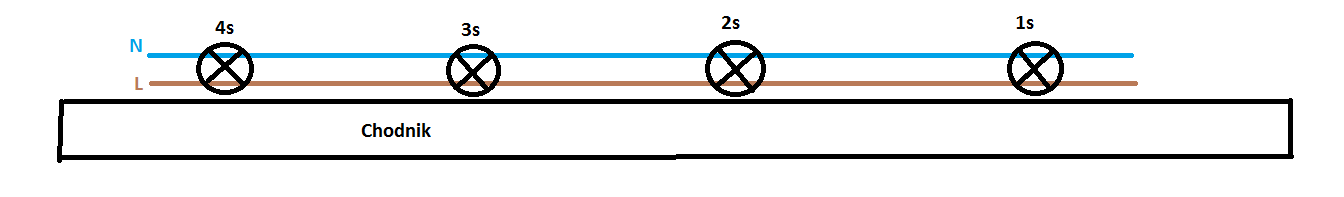

    Walkway entrance to house with installation on 3x1.5mm^2 as pictured above.
    I am looking for a solution to run individual bulbs with a delay of approximately 1,2,3,4 etc seconds after voltage is applied to the circuit.
    Operating voltage of the circuit/modules/bulbs 220/24/12V AC/DC.
    I am looking for modules preferably waterproof, or a schematic to achieve this effect.
    Regards.

    Do you want the bulbs to switch on one after the other to give a lighting effect? This is not possible in this connection configuration. For such an effect, each bulb must be individually connected to the controller. Here, you can only achieve a delayed switching effect for all of them, possibly a slow brightening (cinema effect), but also all of them at once.

    Alternatively, a separate time relay could be added to each light point, or the next light point could be switched on only after the previous one has been switched on, plus a time delay of some kind. But this would also require cutting the installation into sections.

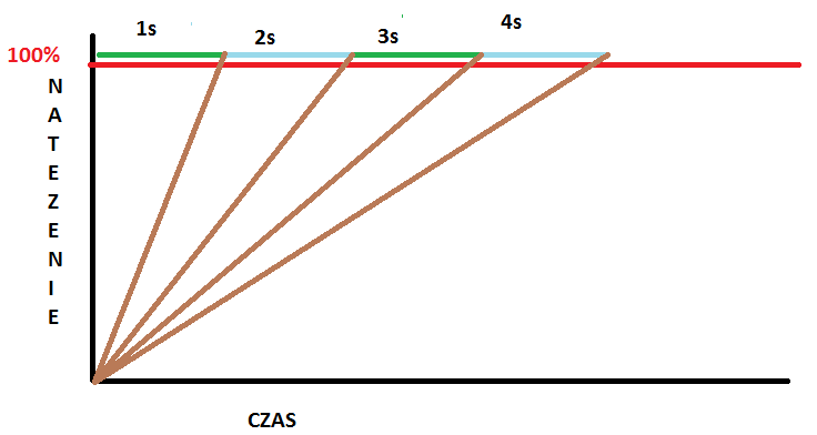

    Or maybe all of them start at once, but the lighting time for each bulb is longer, e.g.: "I don't know if I can do it all at once":
    How to achieve delayed bulb switching in a 3x1.5mm² installation?
