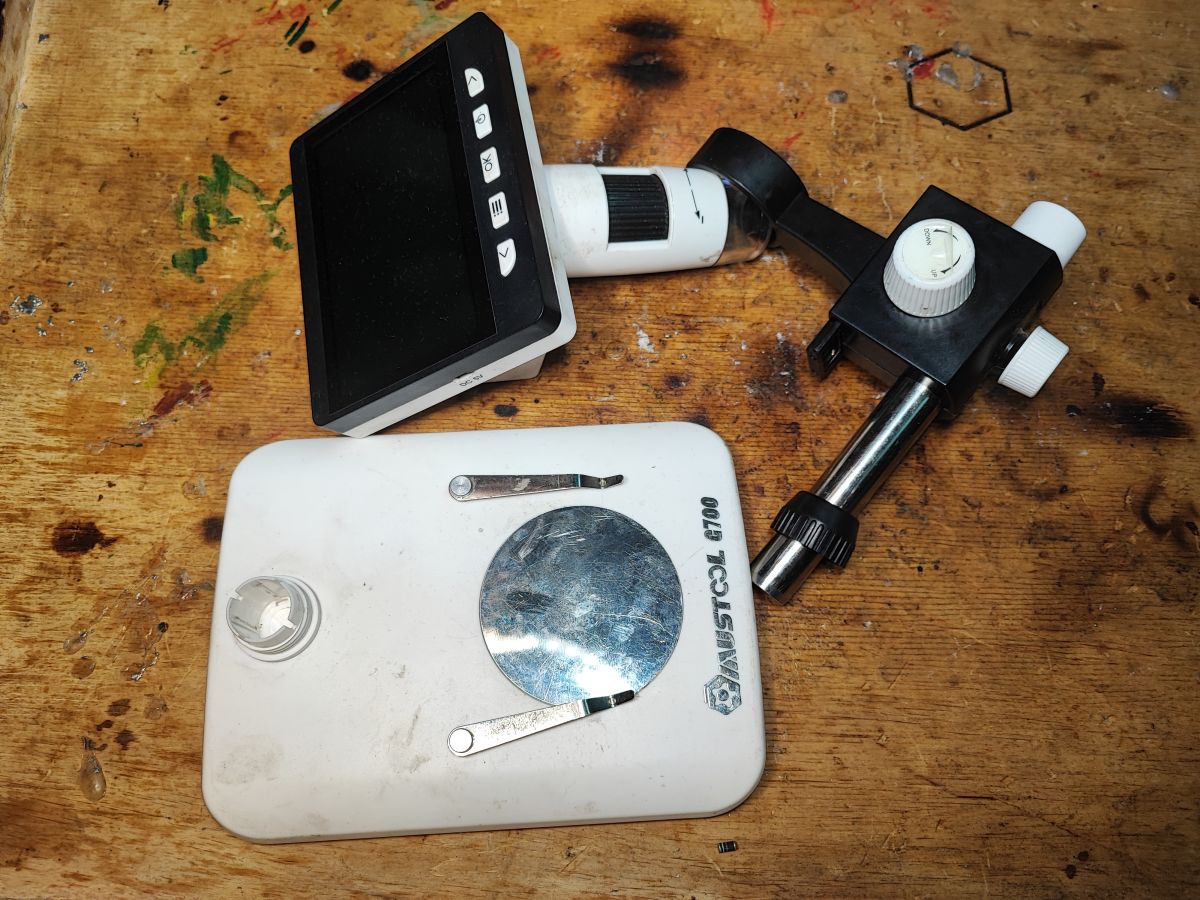

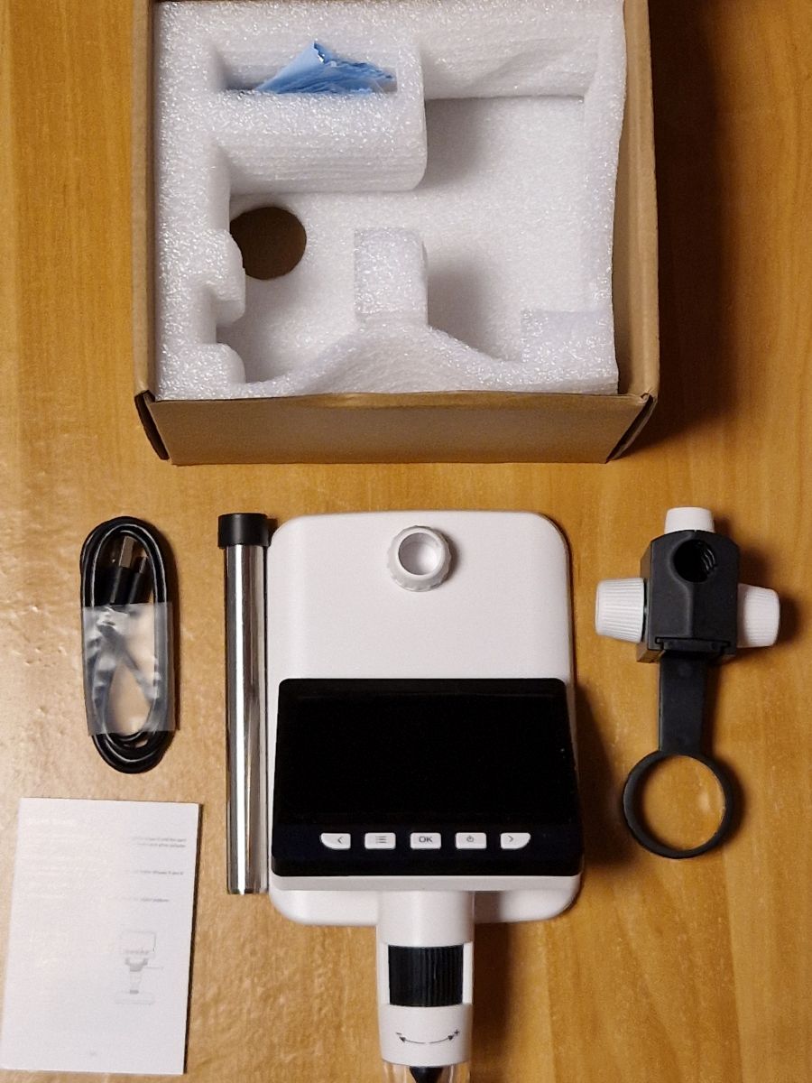

    The equipment, of course, comes in parts:
    Which budget microscope for an electronics technician? What does the Mustool G700 offer? Image galle .
    This version is largely plastic, but surprisingly still somehow holds up. This is all the more of a plus because, as I pointed out, I got the used version from a forum member.

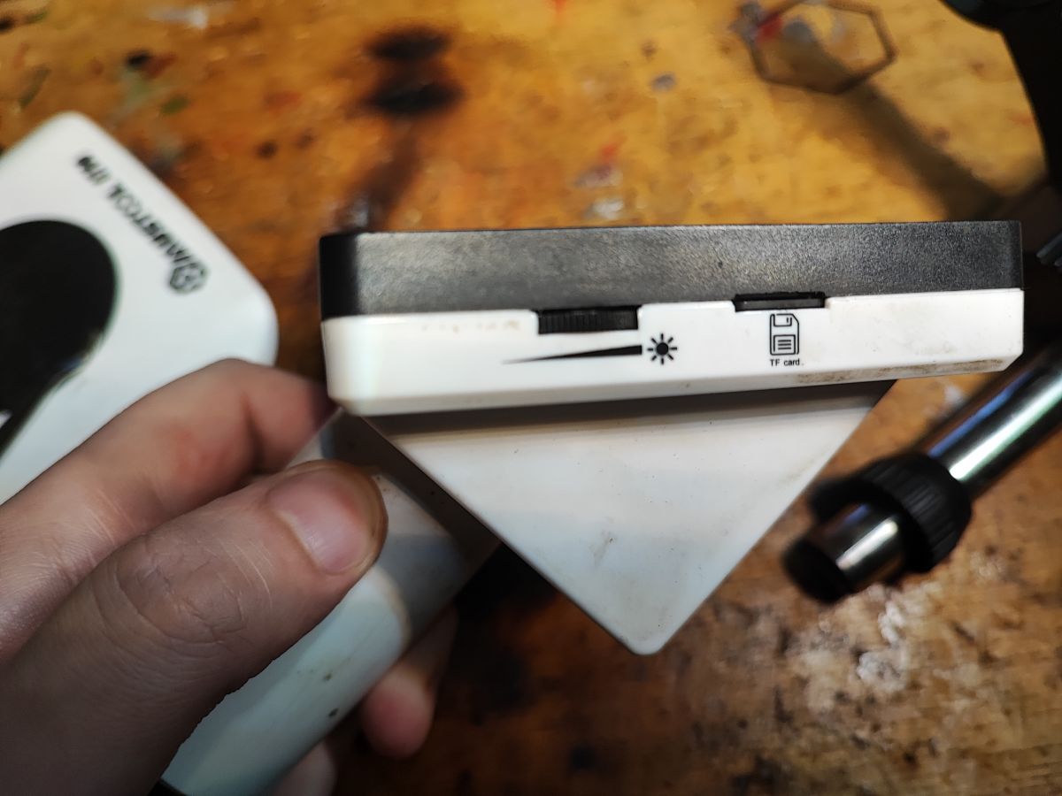

    On the right side of the display we have the LED light level control and a microSD card slot:

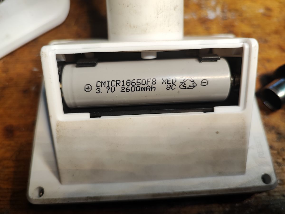

    The cell itself is on the back:

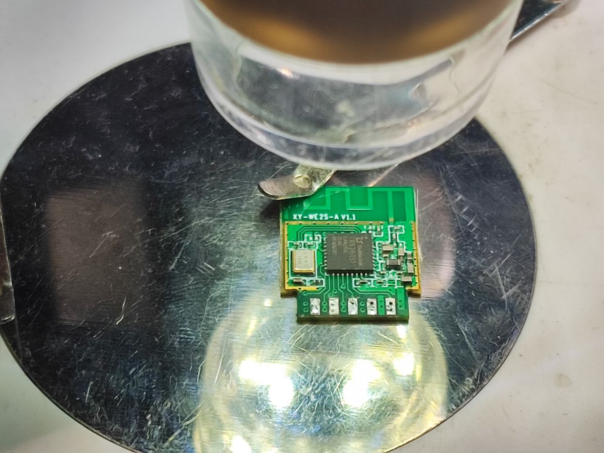

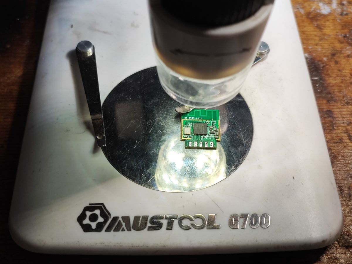

    A two foot stand to hold the PCB:
    Which budget microscope for an electronics technician? What does the Mustool G700 offer? Image galle Which budget microscope for an electronics technician? What does the Mustool G700 offer? Image galle .

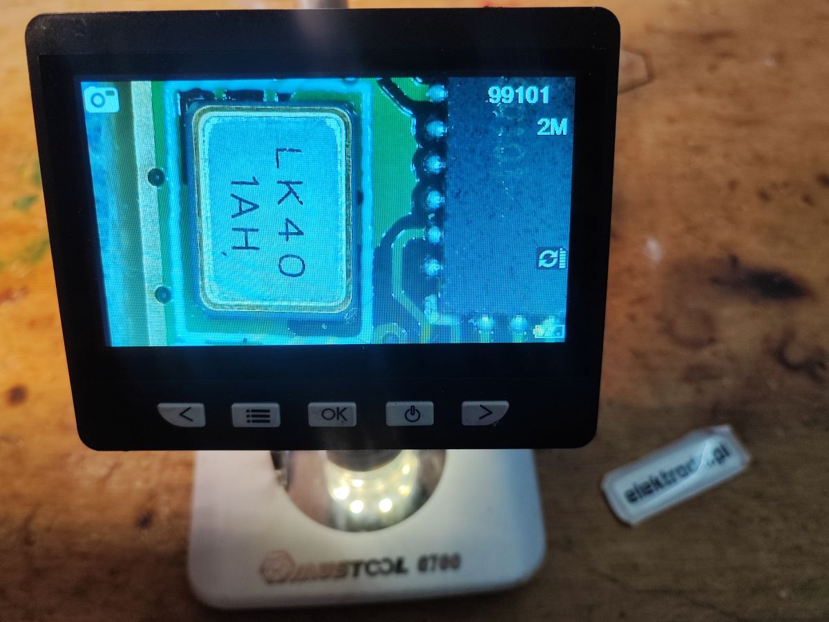

    Let's turn on the microscope. First a long distance view:

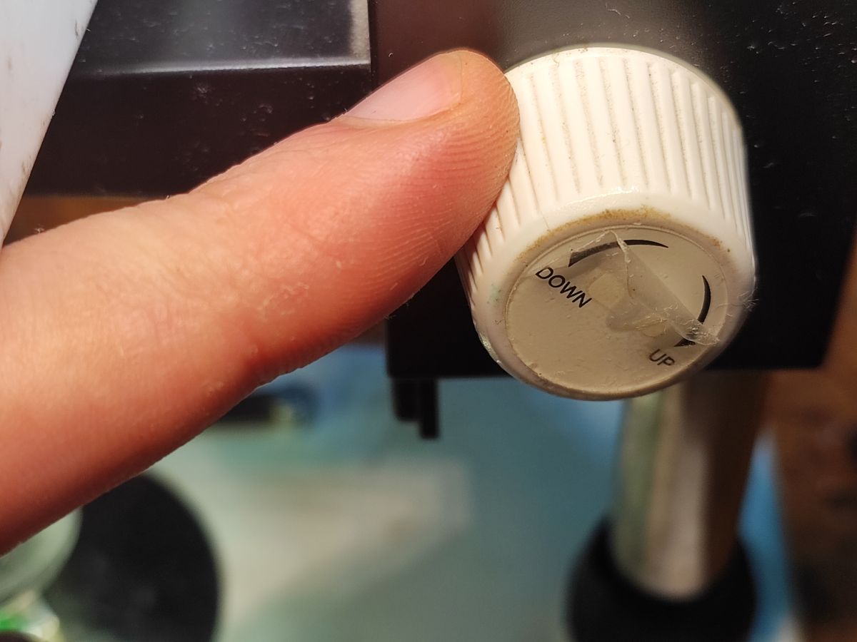

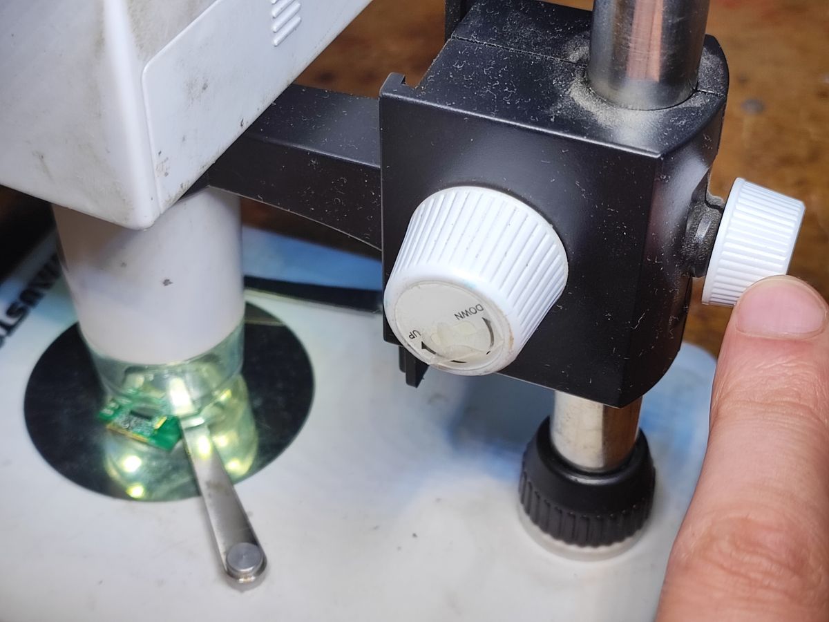

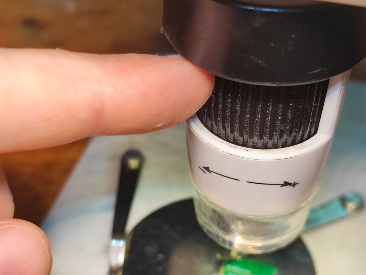

    It is time to zoom in a little. On the right and left we have knobs, one for blocking and the other for the first up and down movement:
    Then we catch the focus here:
    We also adjust the brightness to suit us:

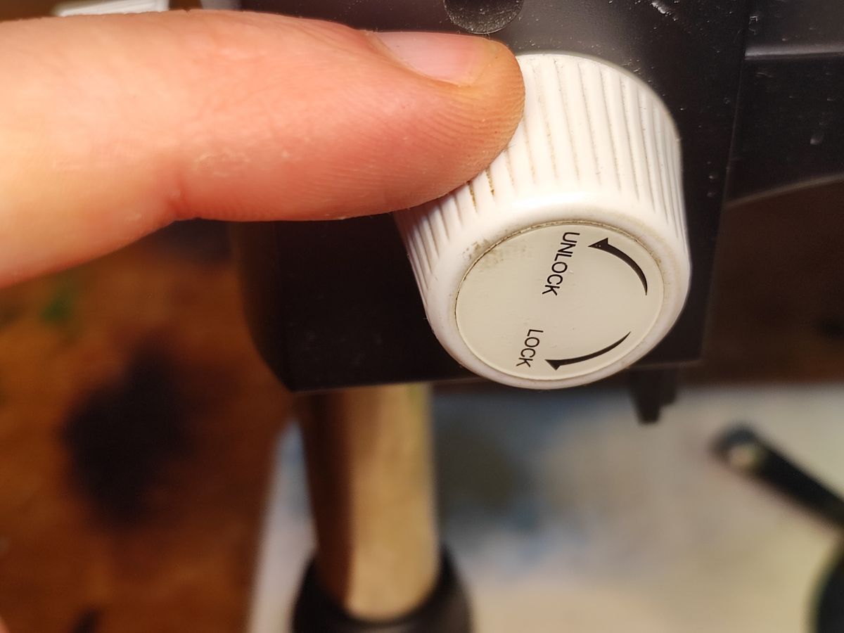

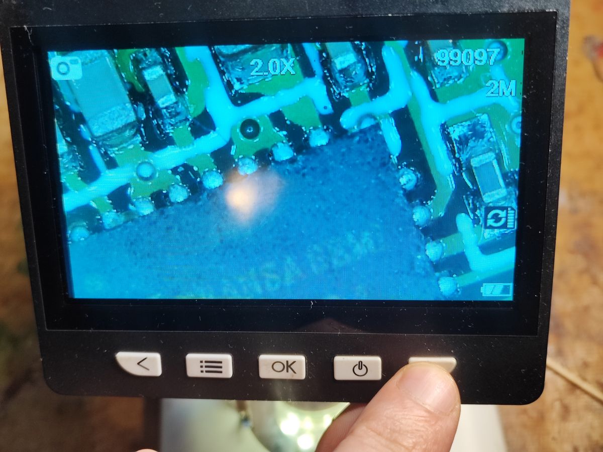

    You can zoom in even tighter. We slide the rear knob (release, slide, lock), even to the stop:

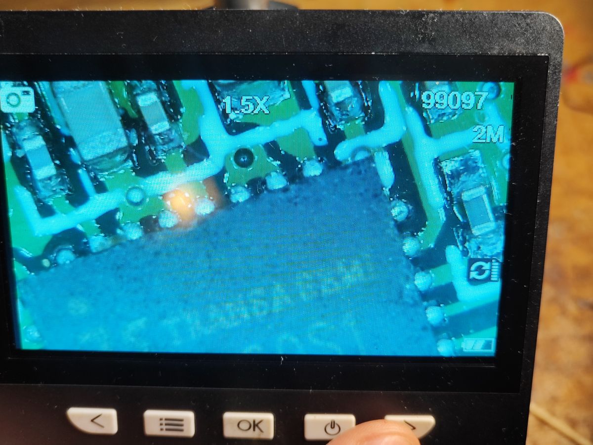

    Effect:
    Which budget microscope for an electronics technician? What does the Mustool G700 offer? Image galle Which budget microscope for an electronics technician? What does the Mustool G700 offer? Image galle Which budget microscope for an electronics technician? What does the Mustool G700 offer? Image galle Which budget microscope for an electronics technician? What does the Mustool G700 offer? Image galle .

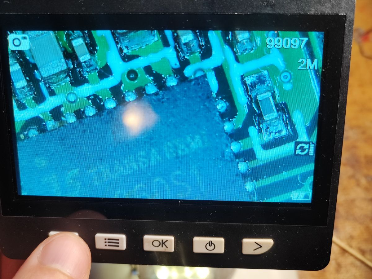

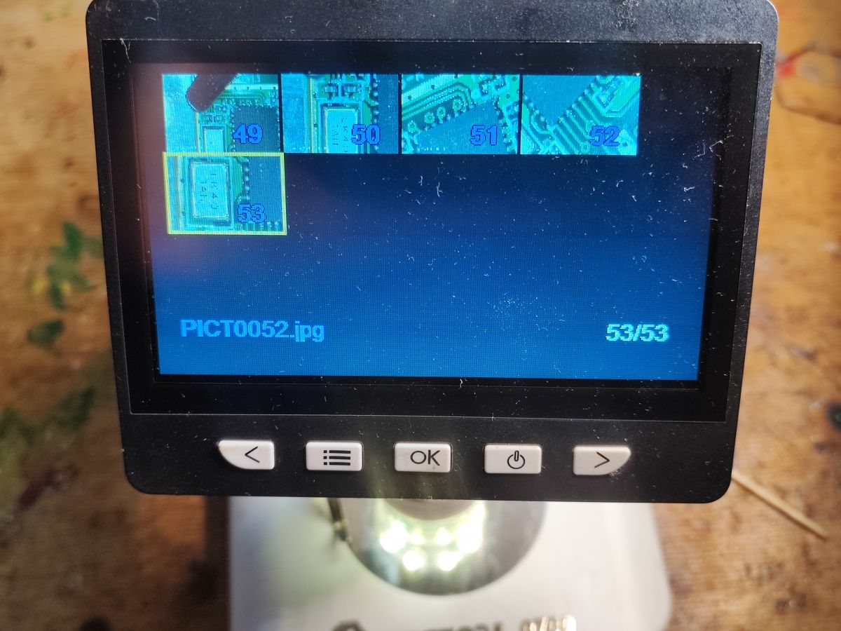

    I take photos using the OK button, you can also enter the photo gallery:

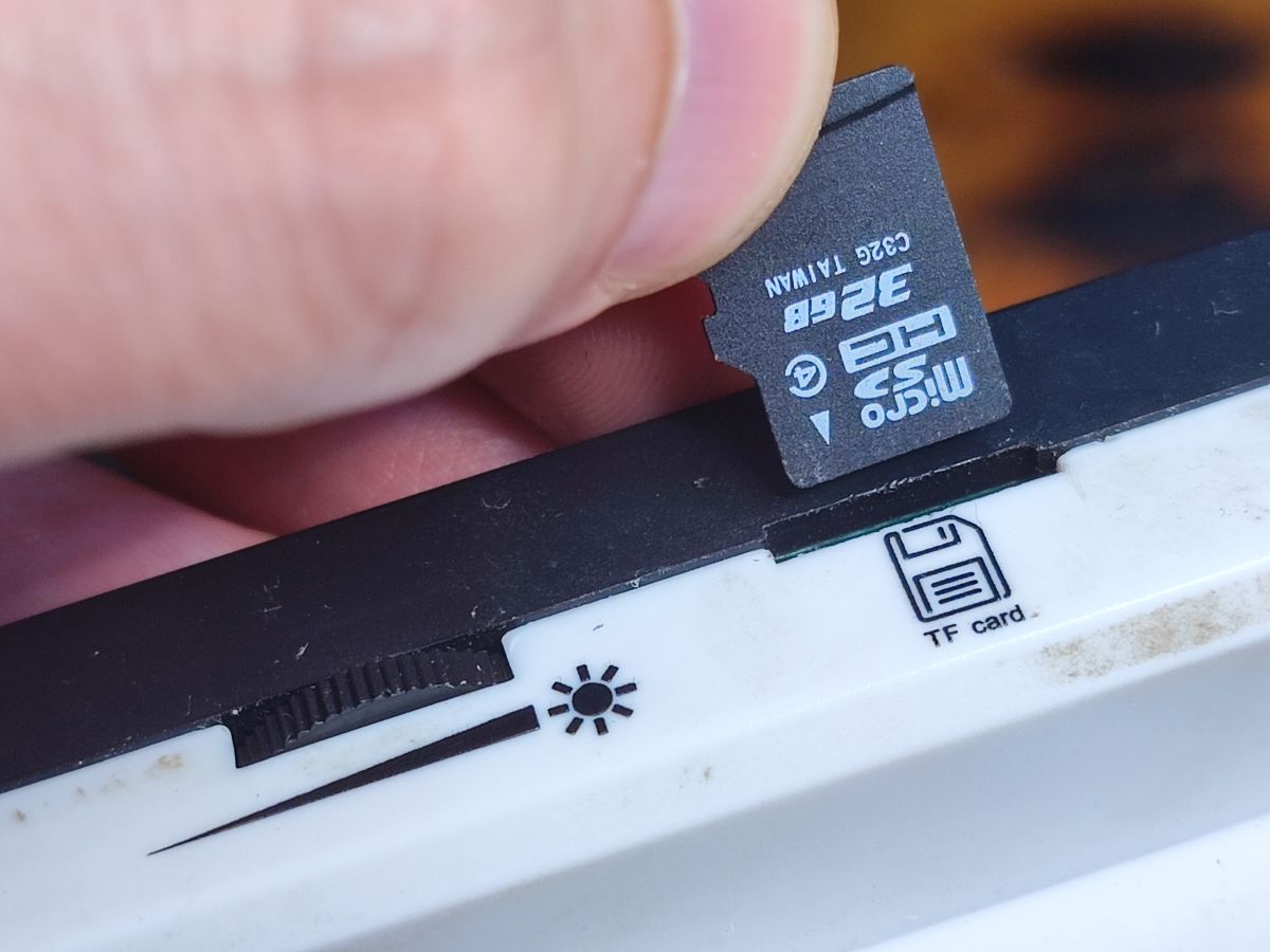

    The SD card can of course be removed, but I was a little surprised to find that it is inserted the opposite of what is on the graphic?

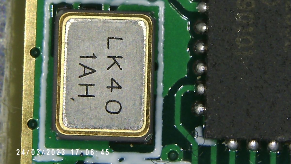

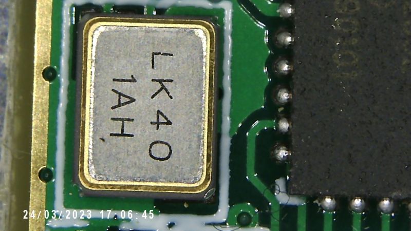

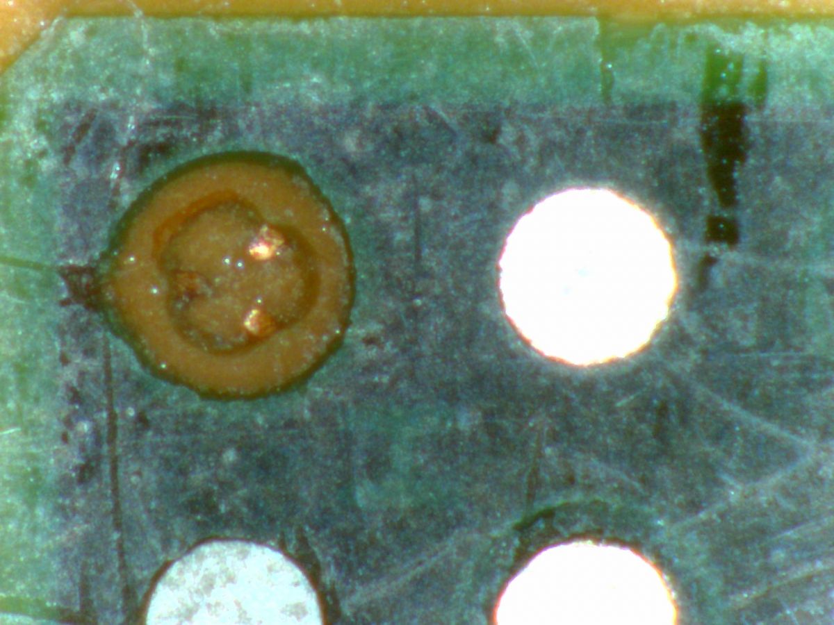

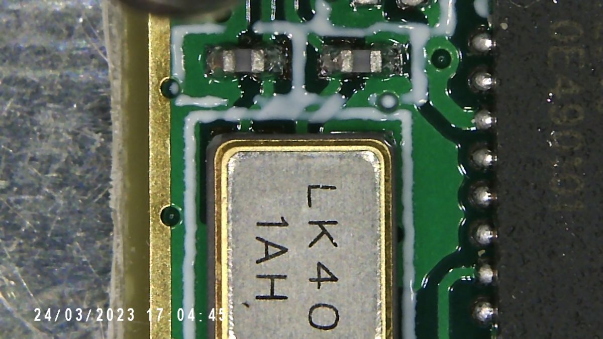

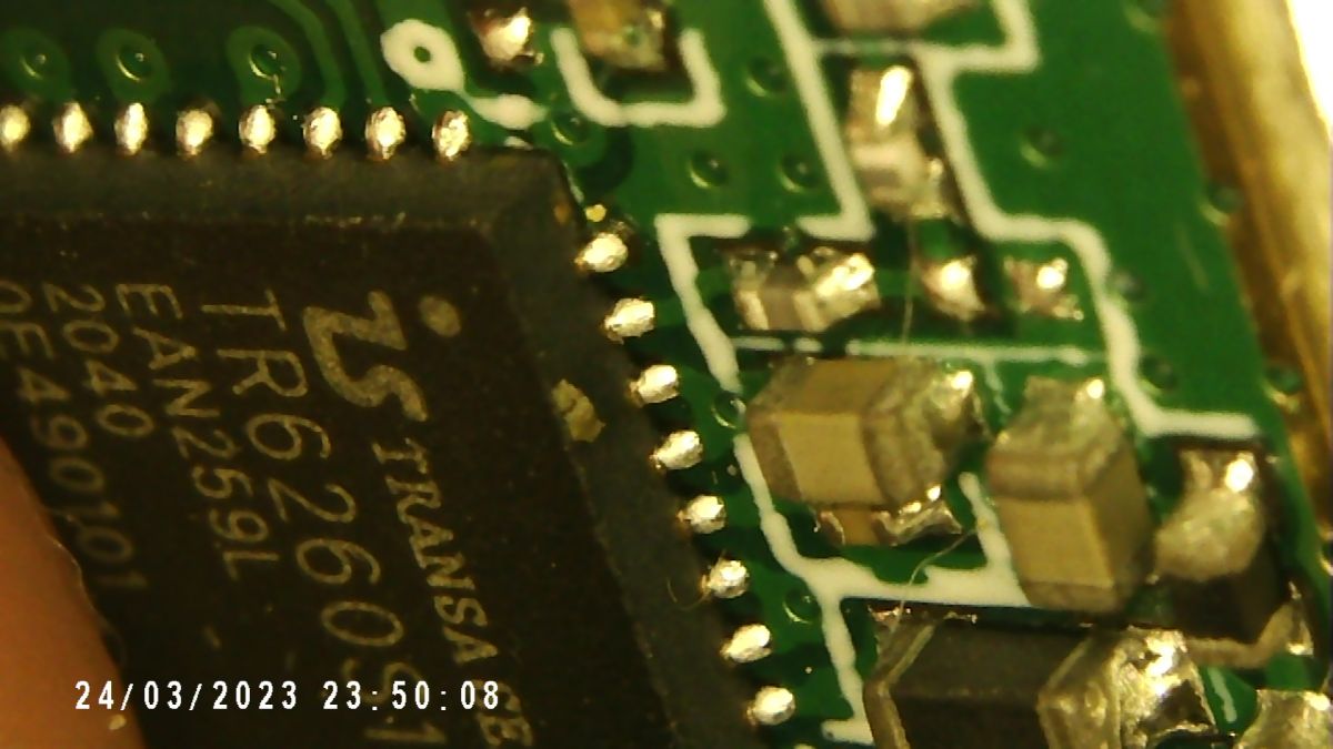

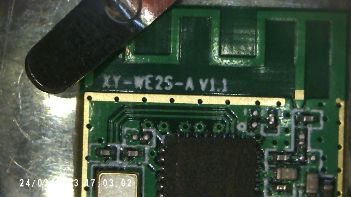

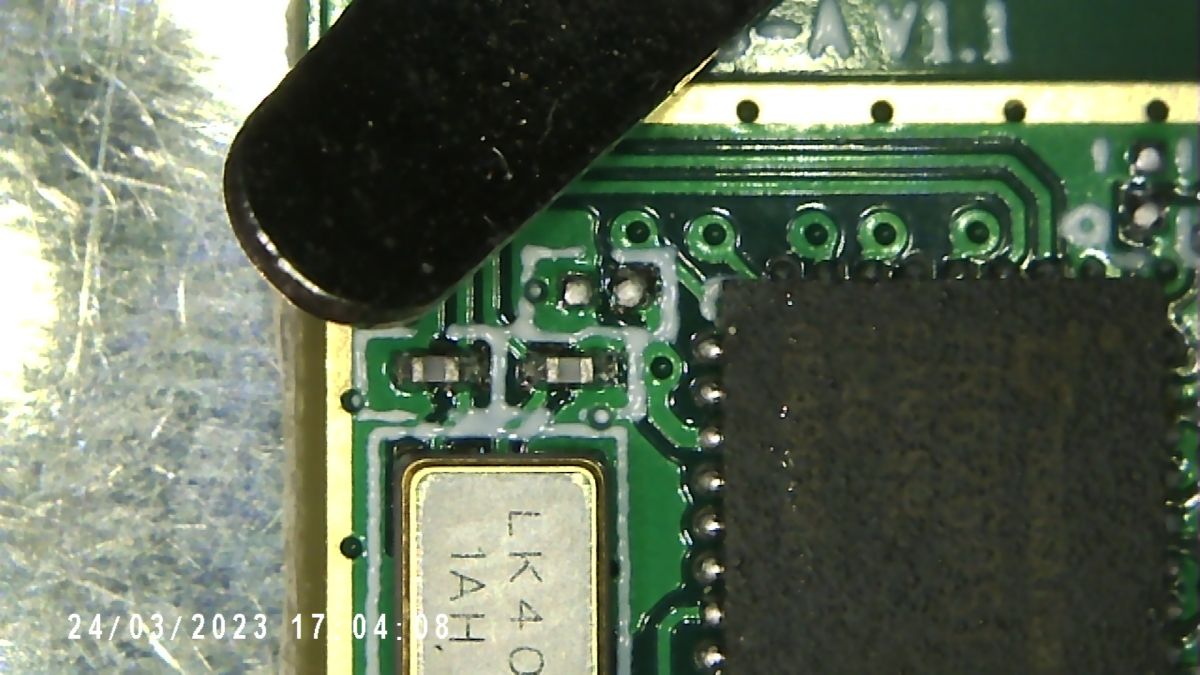

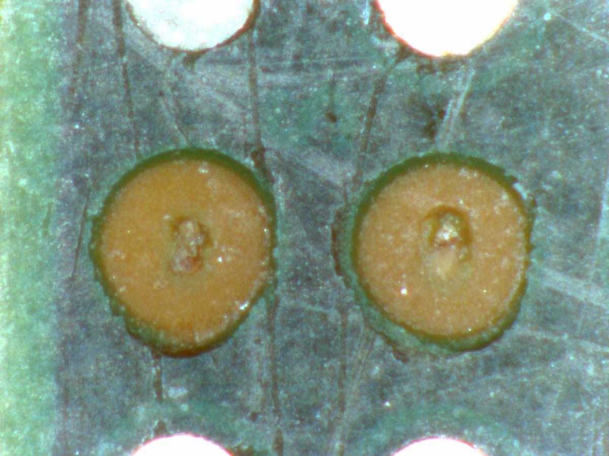

    Here are two more photos at the highest magnification:

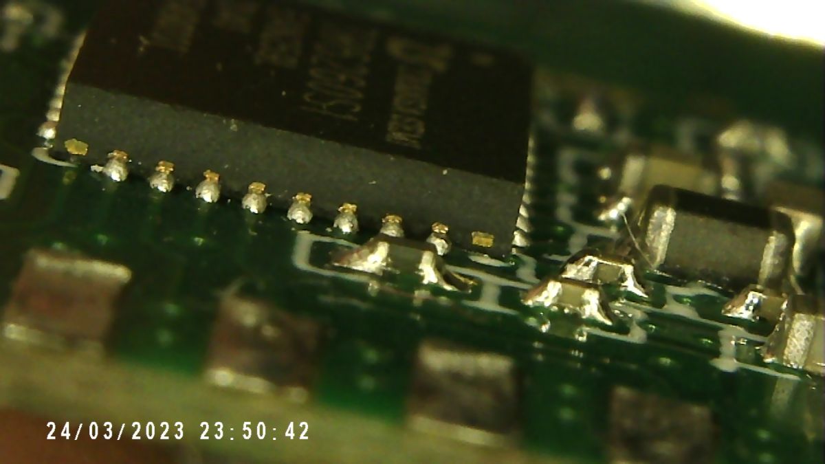

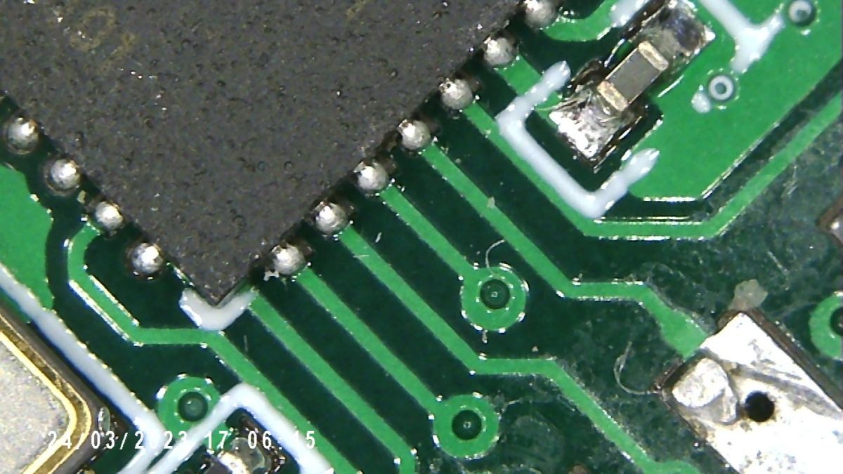

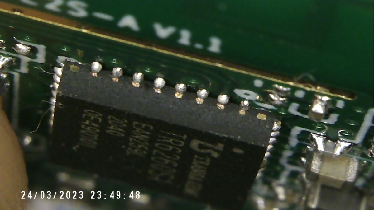

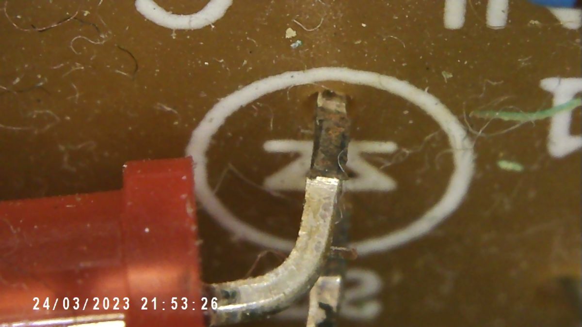

    You can also take pictures at an angle if you hold the plate you are photographing properly with your fingers:

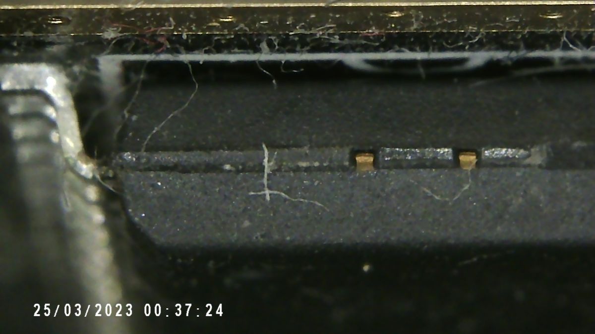

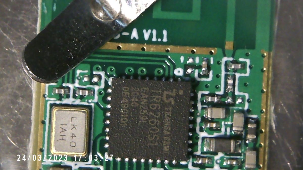

    Similarly, here are the solders of the component in the QFN housing as seen from an angle:

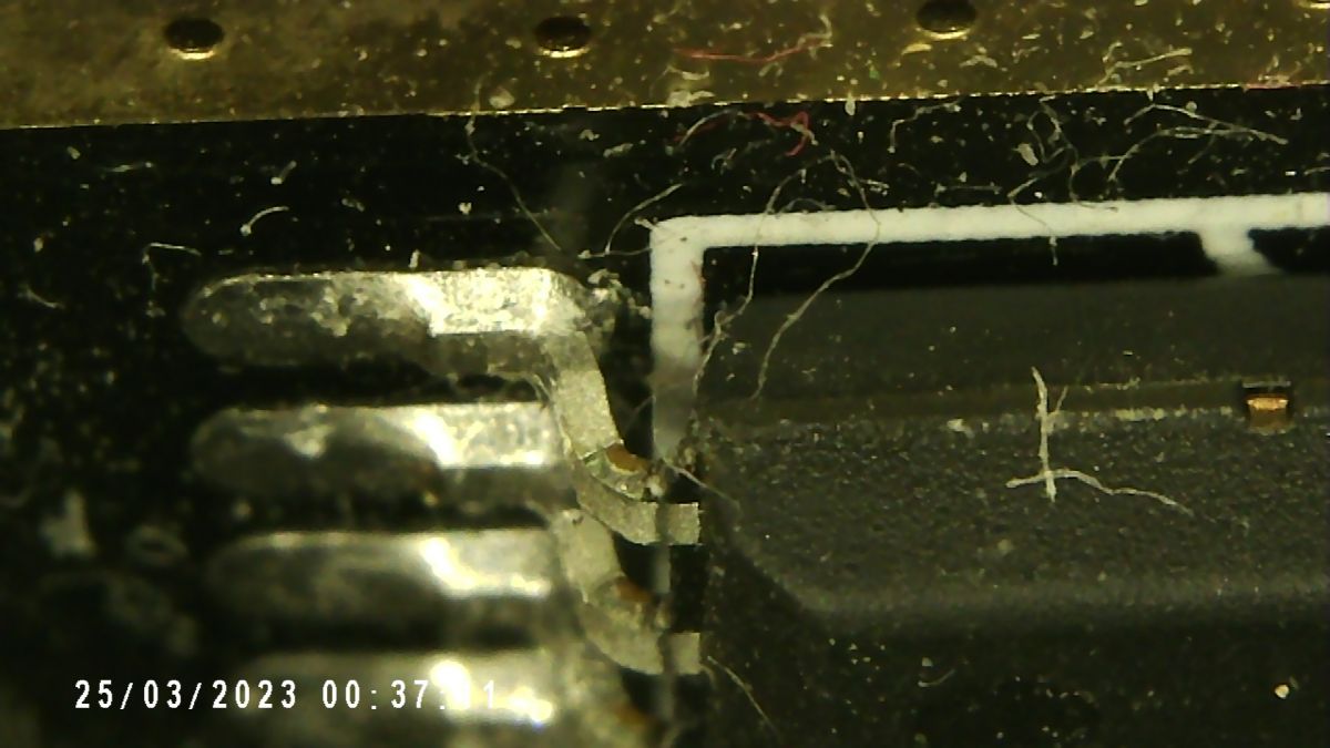

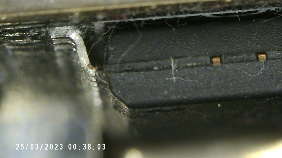

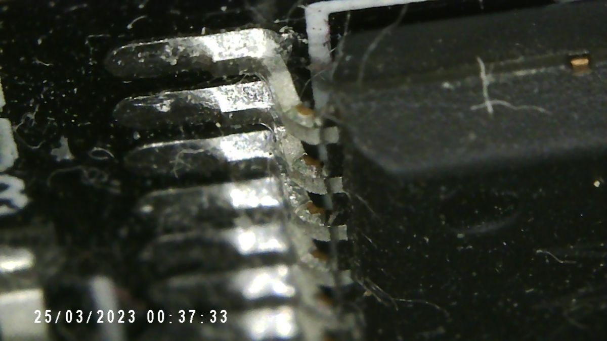

    It is even possible to look under the leg of the circuit in the SOIC:

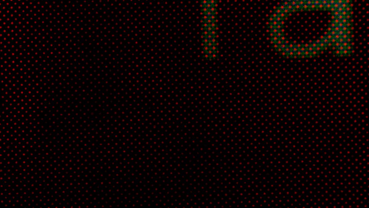

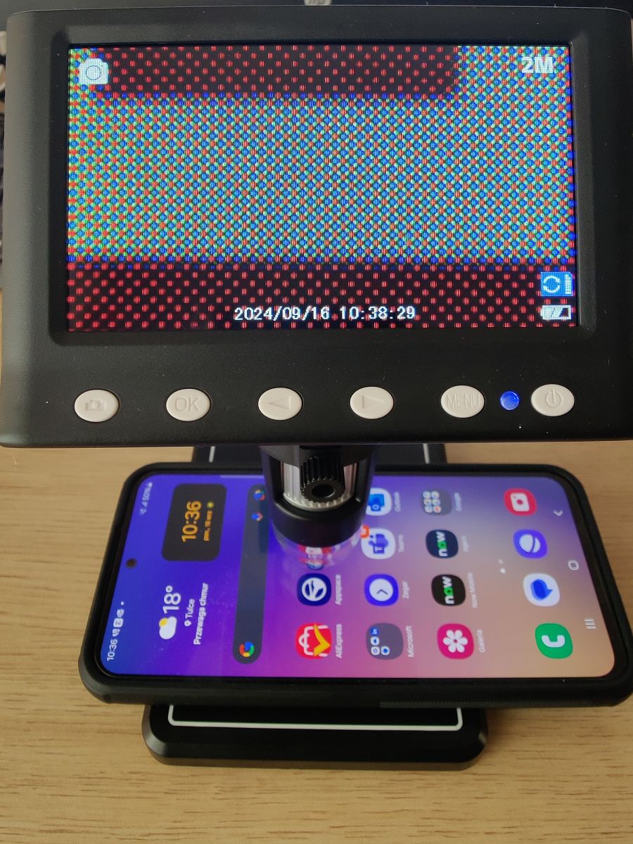

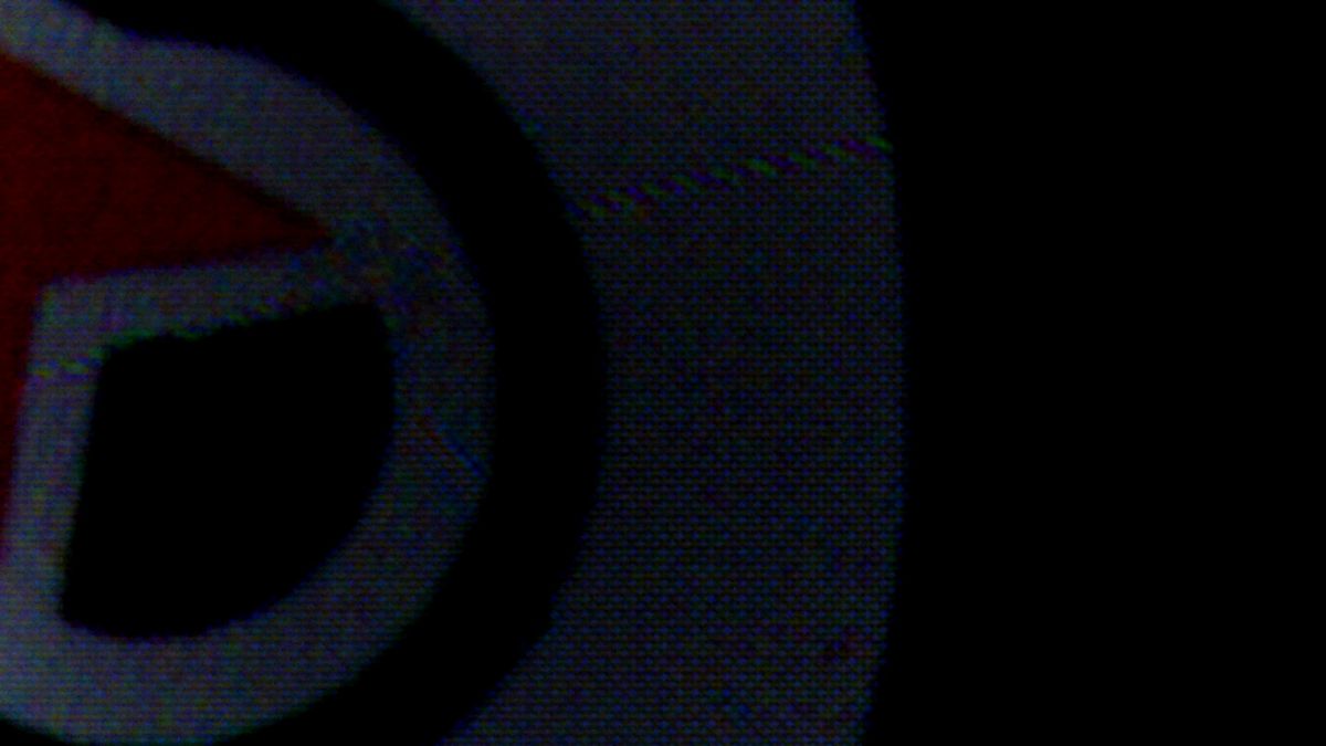

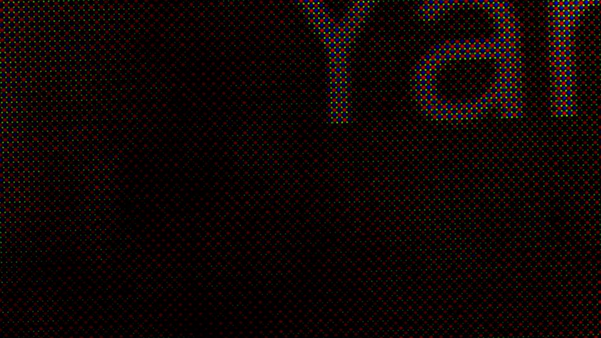

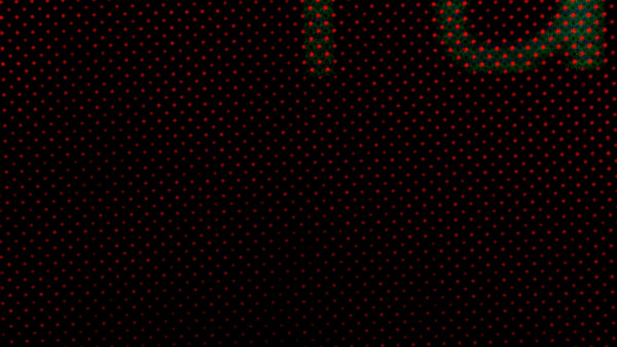

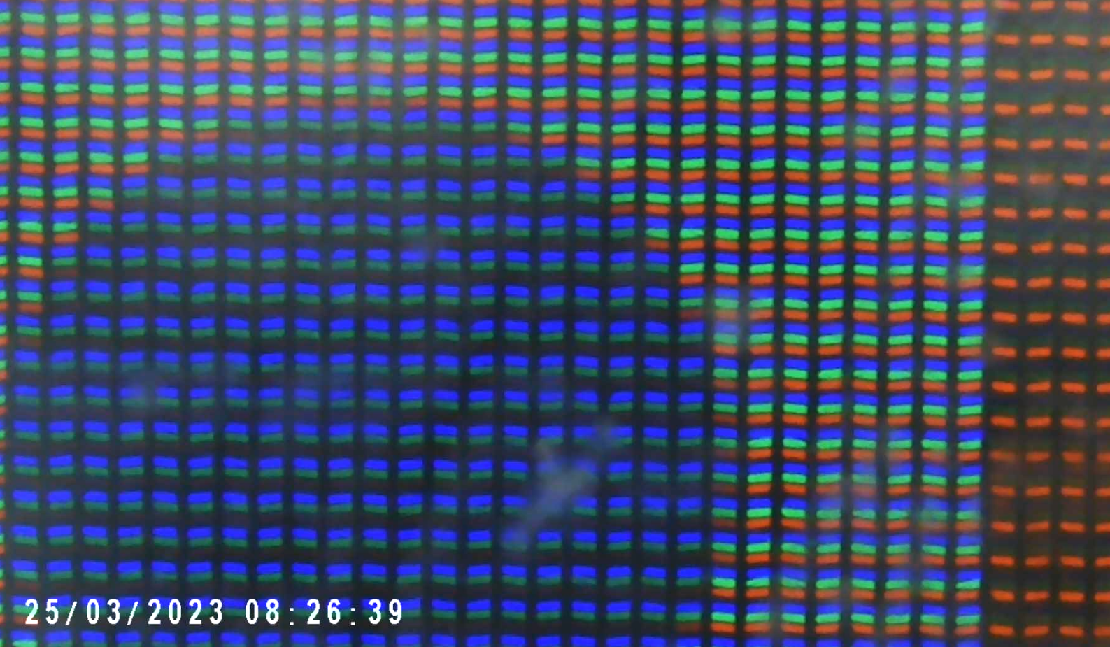

    At high magnification you can see the individual pixels and their RGB components on the smartphone display:

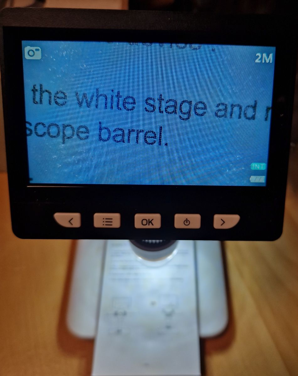

    Test as image delays on the display:

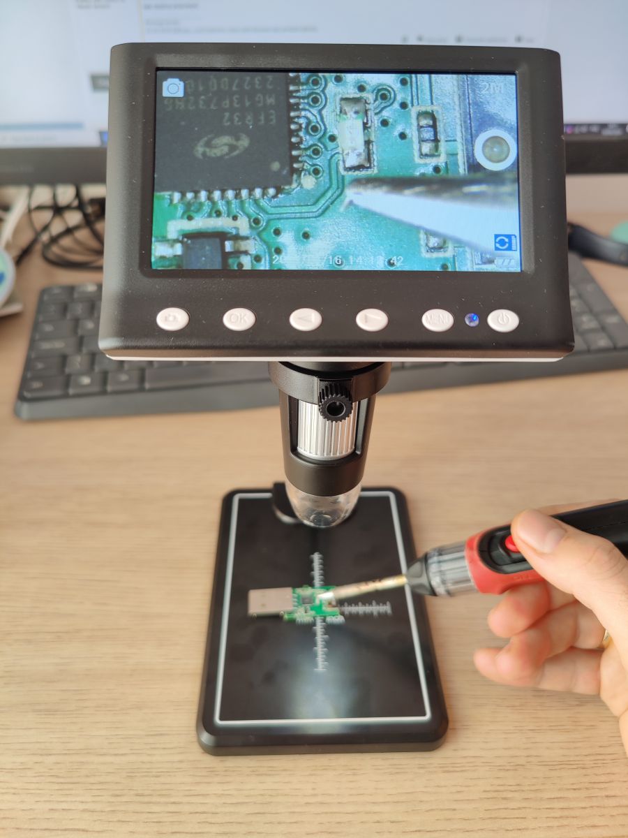

    You must have overpaid for this marvel.
    Which budget microscope for an electronics technician? What does the Mustool G700 offer? Image galle Which budget microscope for an electronics technician? What does the Mustool G700 offer? Image galle Which budget microscope for an electronics technician? What does the Mustool G700 offer? Image galle Which budget microscope for an electronics technician? What does the Mustool G700 offer? Image galle Which budget microscope for an electronics technician? What does the Mustool G700 offer? Image galle .
    I gave about 100 PLN for such a "thing".
    It was only to be used for pcb inspection.
    It supposedly had a magnification of 1000x at FullHS and 2MPx on a 4.3" screen.
    I have now bought a more decent one.

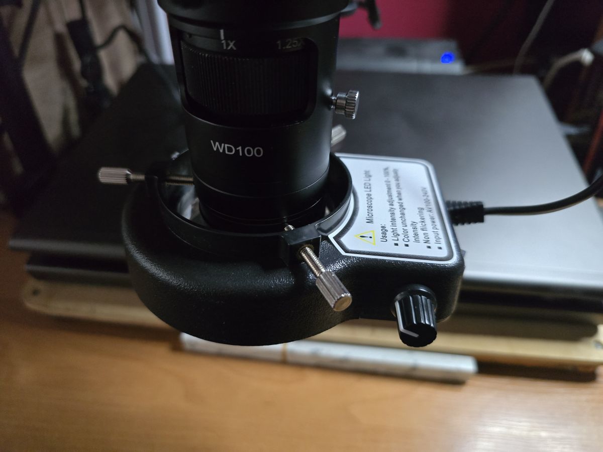

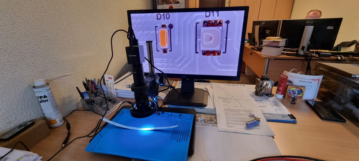

    I didn't pay it because I got a carton of used equipment for free (from the same set is this camera ), and I searched the price of $50 online to get some idea. From what I can see from the SD card dates, the equipment was bought a good few years ago, so maybe the prices have changed too.

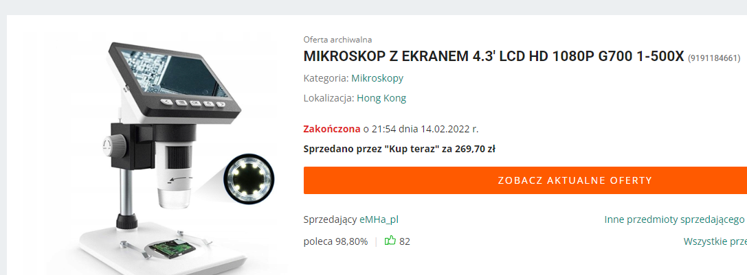

    In any case, I based the quoted price on, among other things, the following:
    But if you bought a similar product for around PLN100 then all the better for a beginner, the only question now is whether the PLN100 'legacy' version is better: The cheapest USB 'microscope' for the hobbyist - review and gallery .

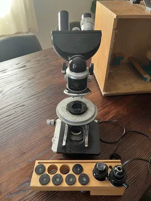

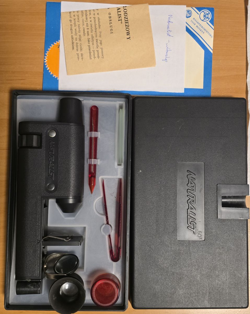

    I have an old Russian Naturalist toy.
    You can definitely see more on it.
    Unfortunately it is not suitable for PCB.

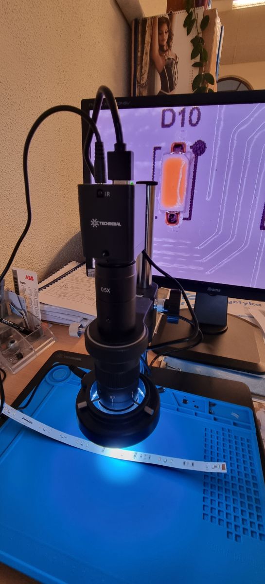

    If someone wants to assemble a kit for solder observation etc more cheaply then Techrebal has some interesting suggestions. (they don't pay me for advertising).
    I bought a C-mount camera from them.

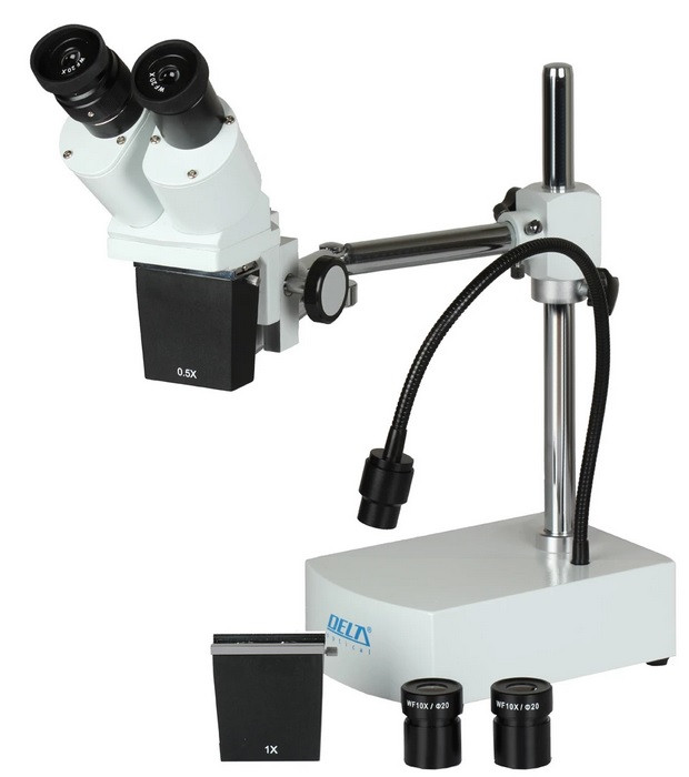

    I've been using a purely optical microscope from Delta Optical for several years now, without any electronics. And it is probably one of the better choices for professional use when it comes to working with BGA. And maybe not only that. Often those water features with the camera and various monitors are a bit over the top. They have too many reflections and other afflictions compared to normal "analogue " optics. ;-) .
    And not to put too fine a point on it, electronic ones I've tried too.
  • #6 21226802
    henry57
    Posts: 28
    >>21226571 .
    Skywalker2, can you provide the model of this microscope?
  • #7 21226917
    skywalker2
    Posts: 110
    Rate: 57
    Delta Optical Discovery L. It is a stereo microscope with a wide working field due to its high and quite long adjustable arm.

    I have a similar microscope, only with a fully plastic stand. I bought it for about PLN85, in fact for half that amount, because the vertical 'post' on which the microscope moves up and down was bent and Aliexpress gave me back 50% of the price :) The post was of course straightened out after being slightly heated. My microscope even "talks" in Polish. The 4.3" screen is absolutely sufficient in my opinion. A larger one would probably even be more of a hindrance than a help. The image quality is very good for me. For around PLN40, there is absolutely nothing to complain about.
    One "operational" drawback I have noticed, but which I don't really use every day anyway, is the problem with taking screenshots. Due to the need to press a button on the screen, the whole thing shakes slightly and it's difficult to take an uncluttered screenshot. When connected to a computer you can take snapshots in the app and this solves the problem. The shallow depth of field overall doesn't get in the way too much.

    popek9 wrote:
    However, for soldering this is no longer suitable. How to approach there at all with a soldering iron when the eye of the camera has to be literally 1 cm from the board.
    You are exaggerating. Here an example. About 6cm distance. Soldering iron for scale.
    Well it can be done, but it is better to have more space.
    I once assembled myself a device to view what I was doing from a metre away.
    Formally it wasn't a microscope but a telescope but it doesn't matter.
    It's better to buy something that provides more space than to buy something that provides more space later anyway.

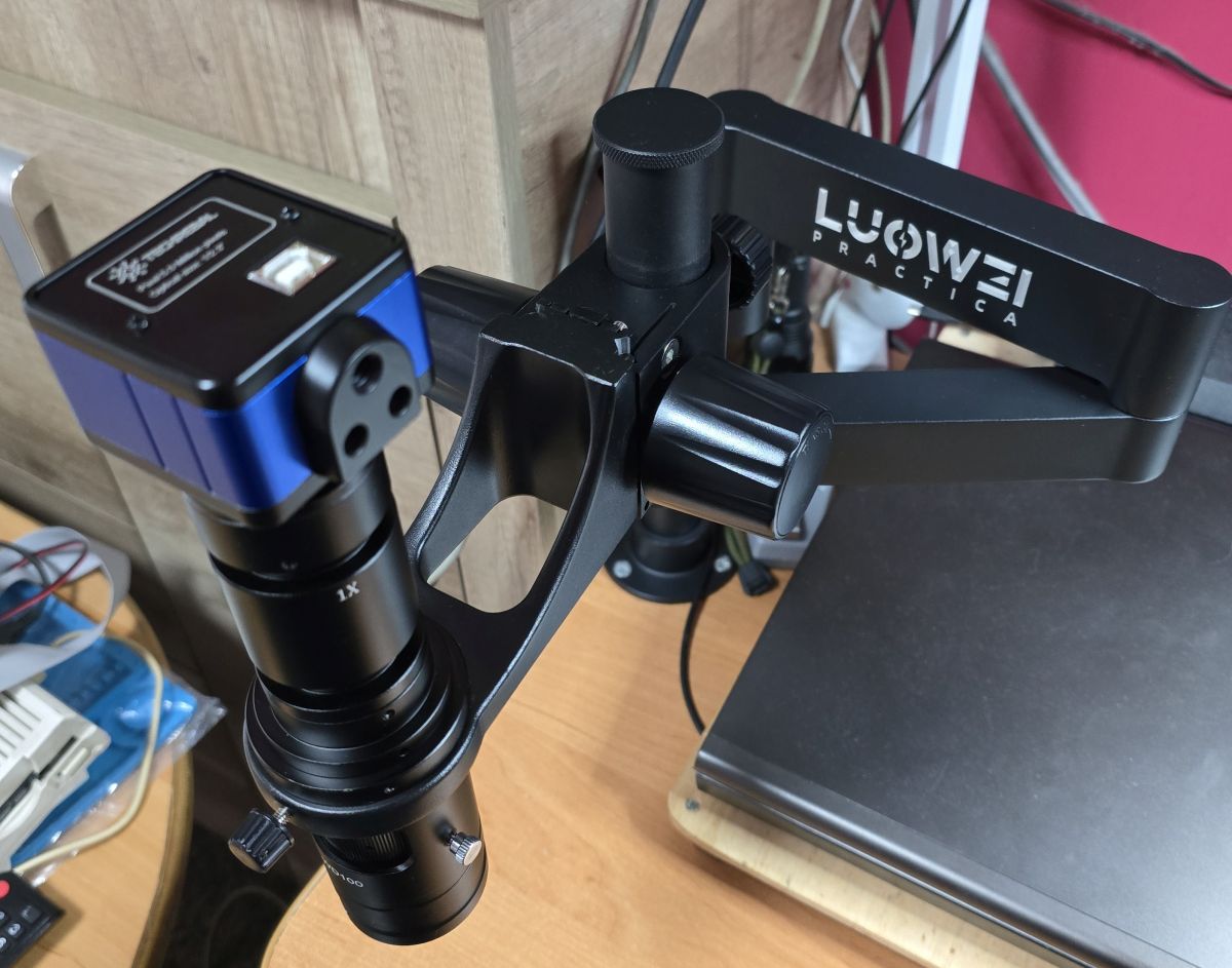

  • Budget 4K 60 fps microscope camera recommendation
    #14 21230446
    popek9
    Posts: 104
    Rate: 26

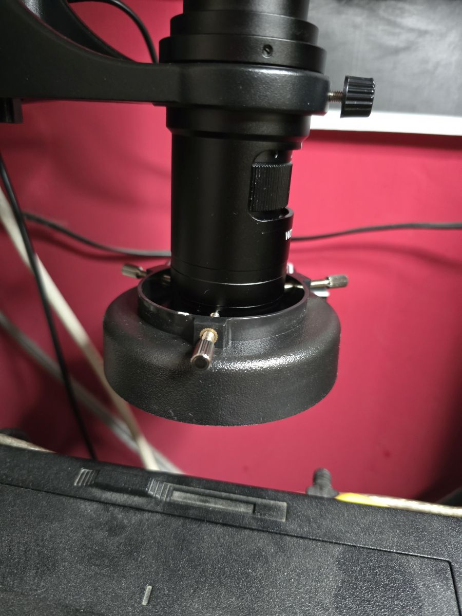

    >>21228379 I would definitely touch this plastic cover with a soldering iron when soldering for the first time. 6 cm is really very little, even though it seems like a lot to some people
    This is a piece of equipment that I can personally recommend. On ali you can buy a 4k 60 fps camera with arm for less than PLN500, at that price you can't buy anything better.

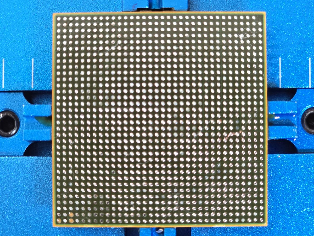

    And as we have already started unusual microscopes, here I present a folding microscope.
    Eakins WD100 x500		276,29	Aliexpress
    soczewka Barlov'a x0.35, x0.5	101,25	Aliexpress
    kamera TechReball T250		399,99	Allegro
    Luowei LW-017 arm		254,19	Aliexpress
    50mm holder			122,92	Aliexpress
    oświetlacz 56LED Reball		79,00	Allegro
    All in all approx. PLN1200.
    The microscope has mechanical magnifications:
    x0.7,
    x1,
    x1.25,
    x1.5,
    x2.1,
    x2.5,
    x4,
    x5.
    And in that order of magnification photos.

    And sample CPU enlargements from the X360:
