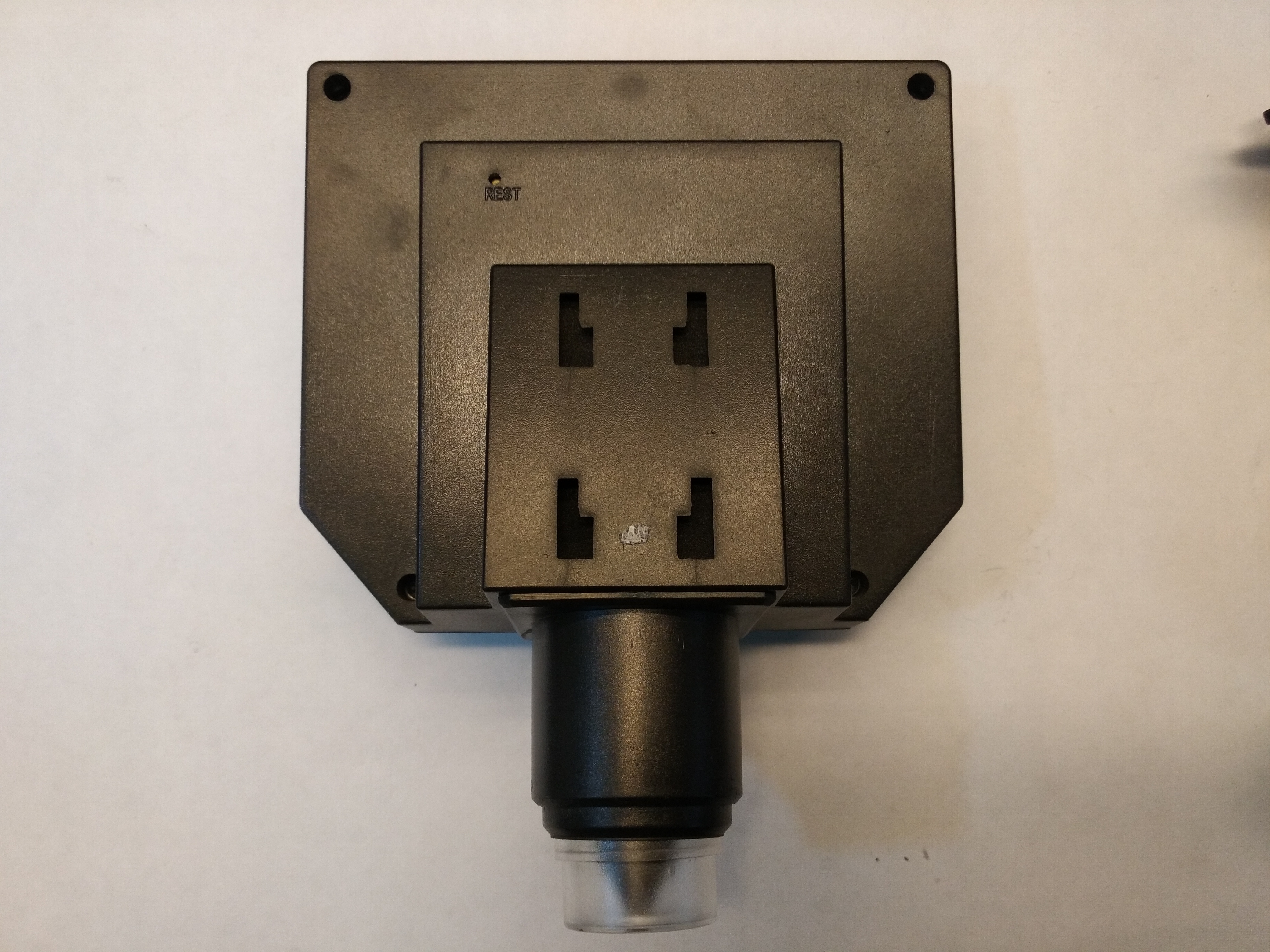

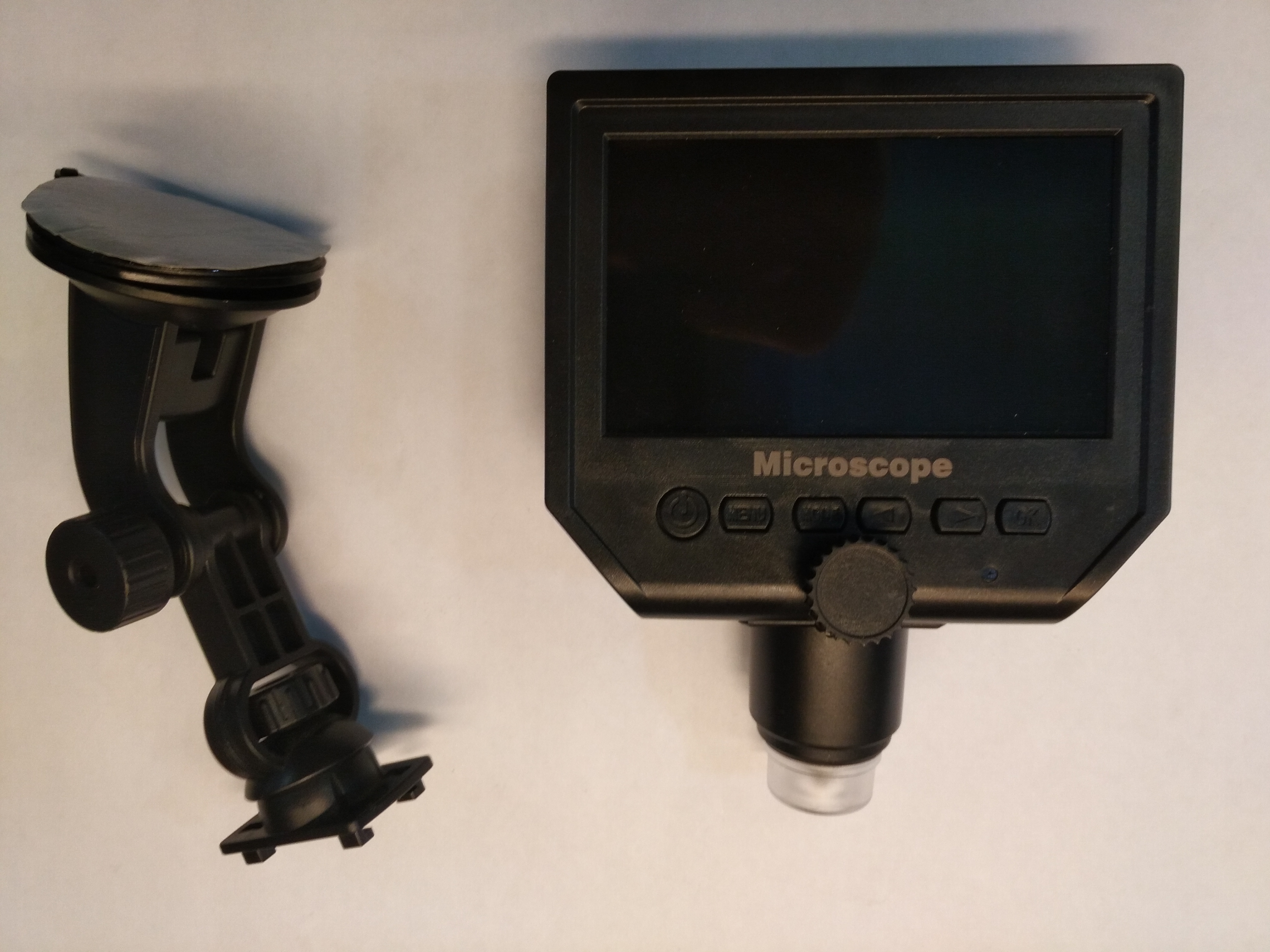

    PACHMET G600 Microscope with 4,3 "LCD - made in china - Test / Review / Des PACHMET G600 Microscope with 4,3 "LCD - made in china - Test / Review / Des PACHMET G600 Microscope with 4,3 "LCD - made in china - Test / Review / Des
    And from another angle.

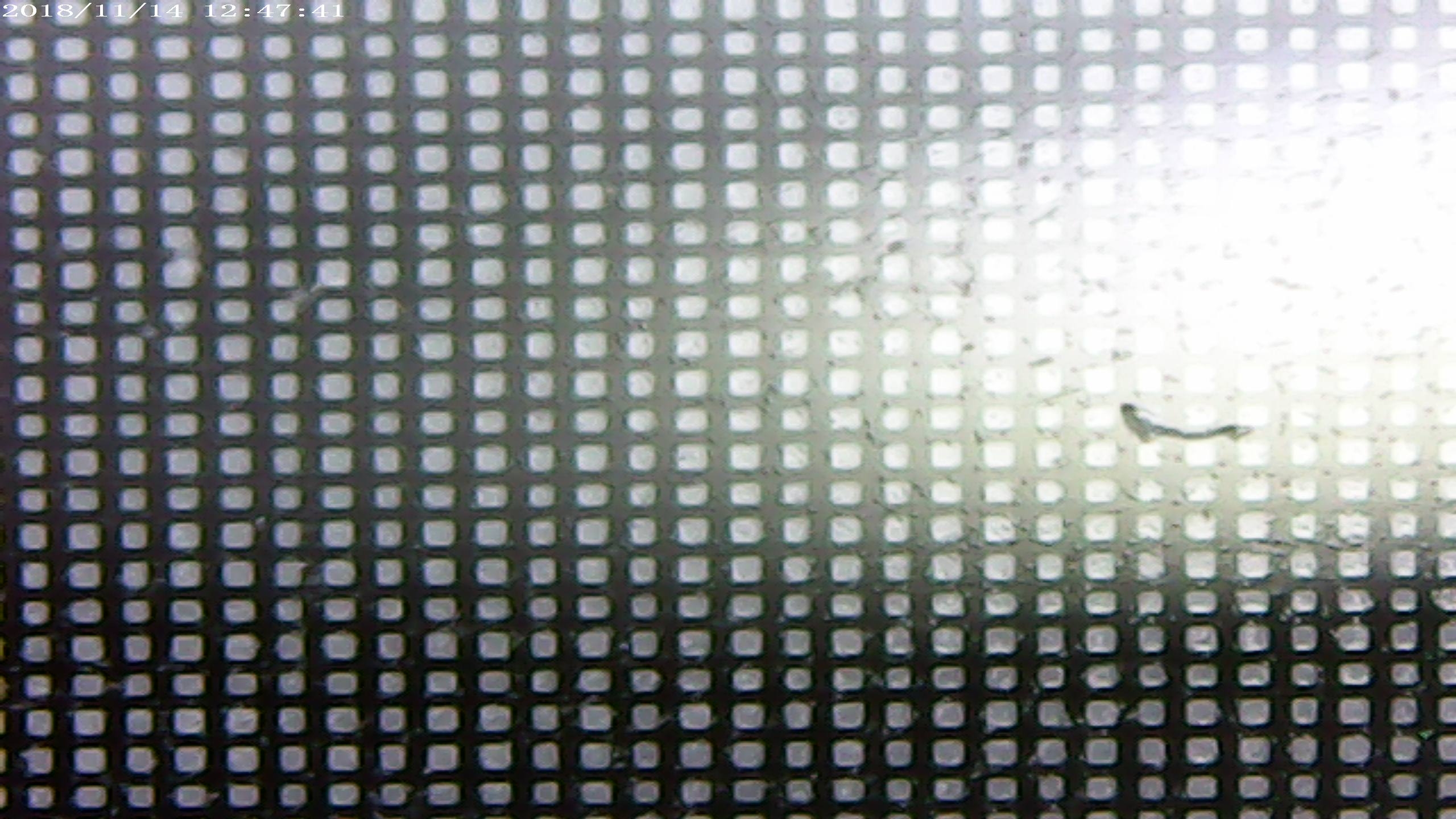

    PACHMET G600 Microscope with 4,3 "LCD - made in china - Test / Review / Des PACHMET G600 Microscope with 4,3 "LCD - made in china - Test / Review / Des PACHMET G600 Microscope with 4,3 "LCD - made in china - Test / Review / Des PACHMET G600 Microscope with 4,3 "LCD - made in china - Test / Review / Des
    The first two photos show the view on the LCD screen, and the next two are photos taken with a microscope. It is a one-grosz coin with the highest magnification I could get.
    As you can see, the screen built into the microscope certainly does not have a resolution of 1920x1080p. It doesn't even have 720p. Nevertheless, it is readable enough to easily see what interests us.
    If you don't believe me, I think that a few more photos will quickly dispel your doubts.

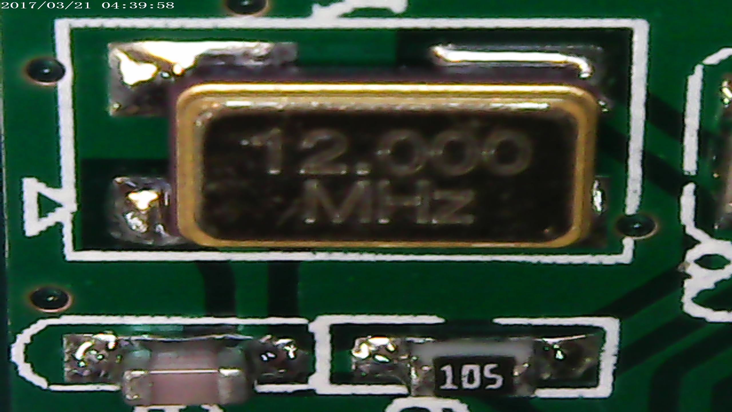

    Above are some photos taken with "reasonable magnification".
    So let's see what I can "squeeze" on the biggest one I managed to get.

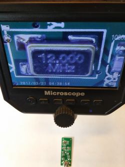

    And finally, the "test plate" that I received with the previous microscope (this one was made "by hand" from a distance of about 50 cm. If I had anything to attach the microscope to, the photo would be 100% sharp.
    And here already up close.
    As you can see in the pictures above, despite the small 4.3 "screen, you can see quite a lot.

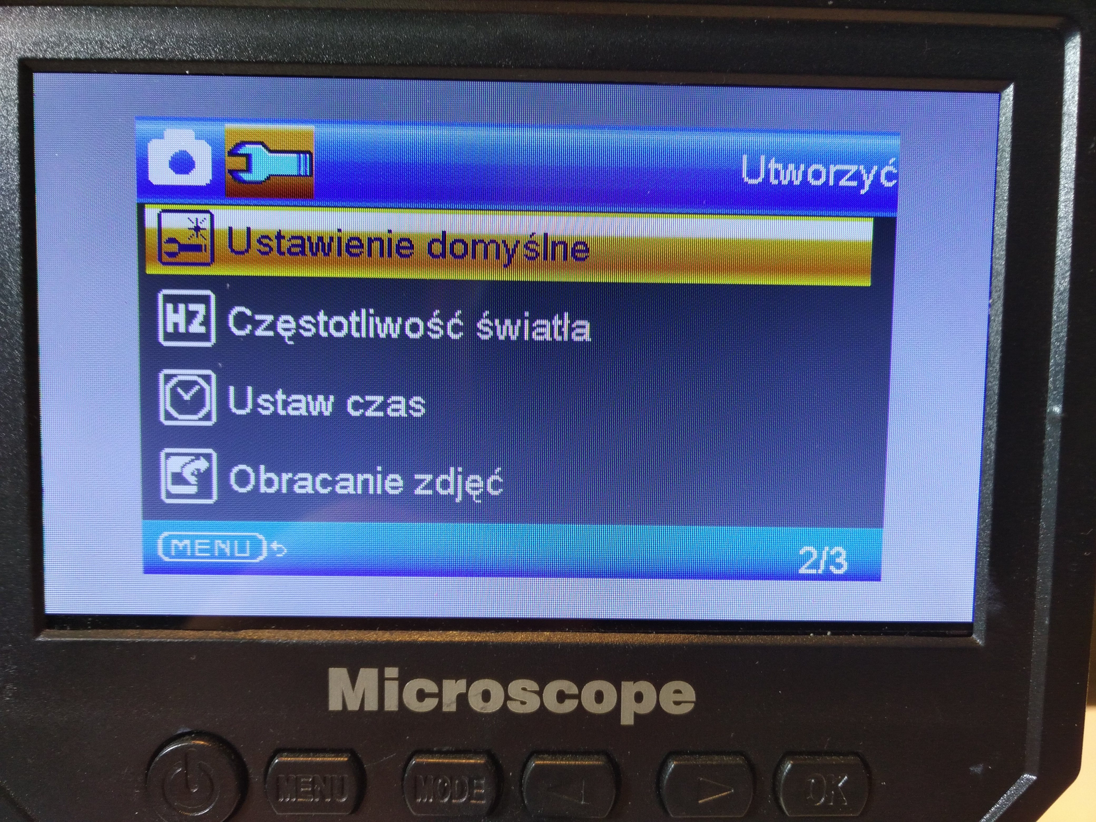

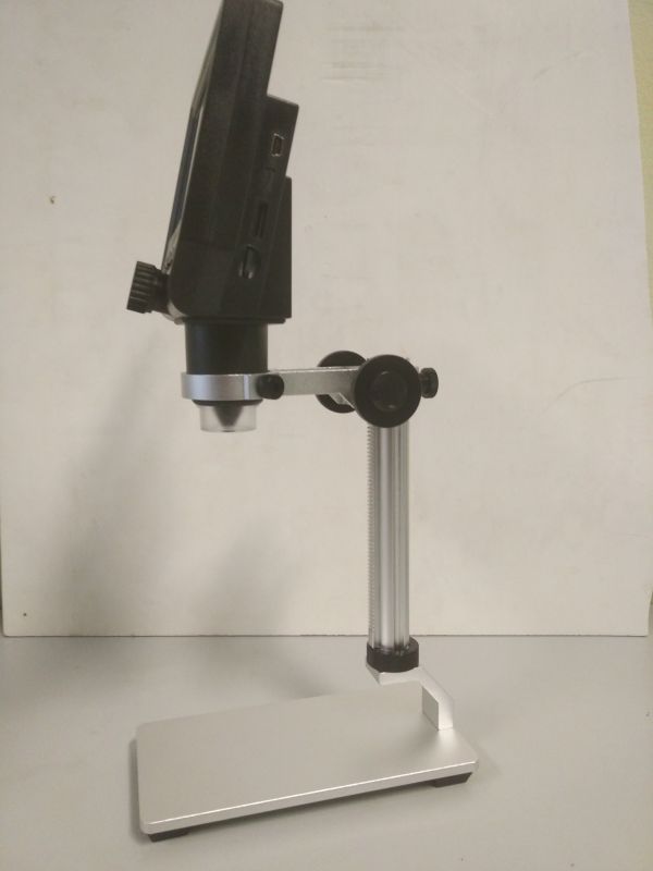

    A plastic articulated tripod, attached to a suction cup made of very soft and sticky silicone rubber, can be attached even to very rough surfaces and holds very tightly. If it gets dirty, you can easily wash it and restore its "full grip". I have to say he's not as bad as I thought. For myself, however, I would order the version with a metal tripod.

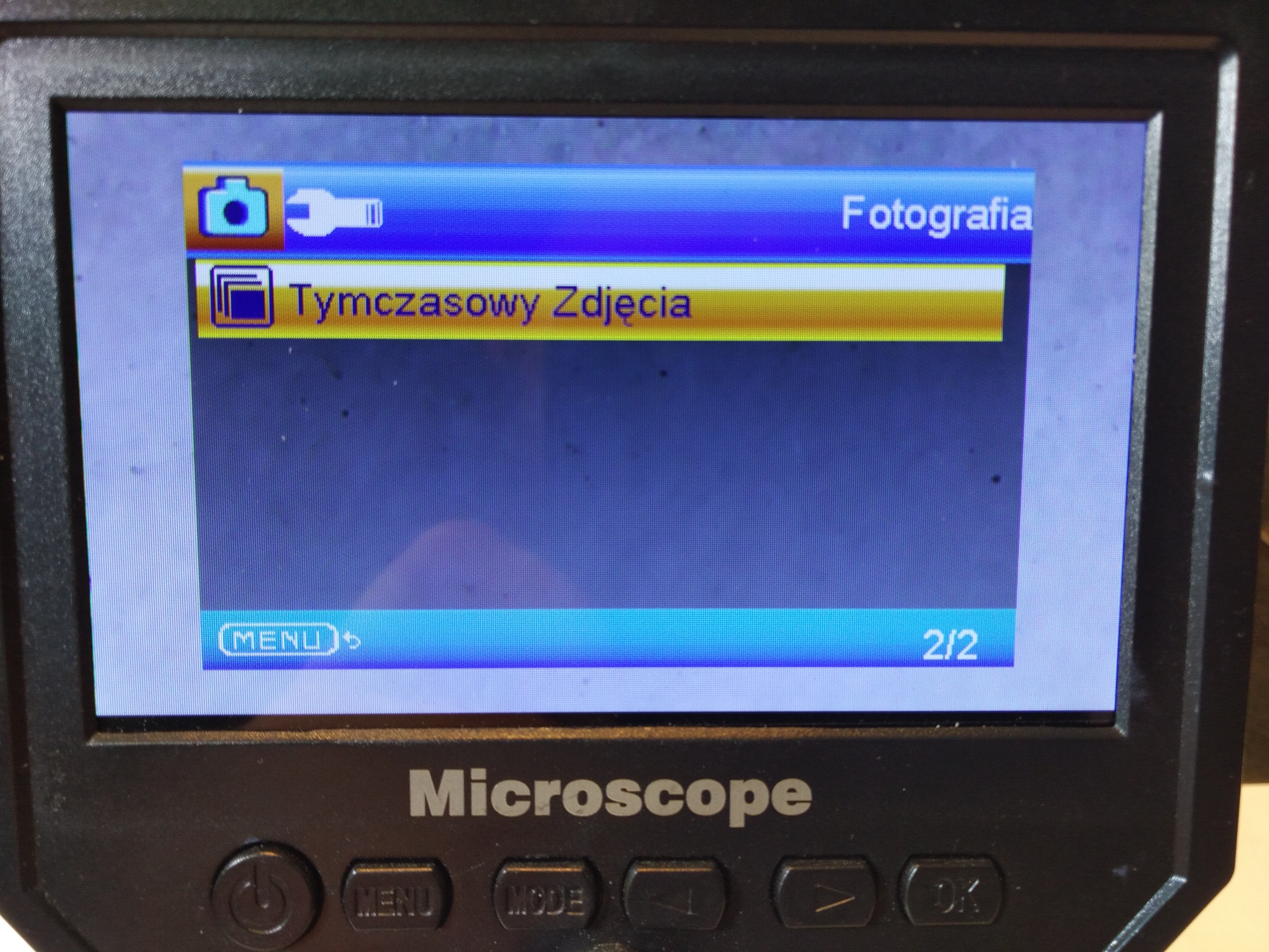

    It is also worth noting that we have a Polish menu with some interesting functions, and among them one surprised me. You can change the backlight frequency. We have a choice of 50Hz or 60Hz. It's about eliminating flicker in the image.

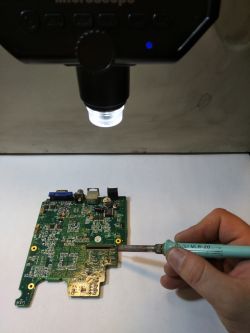

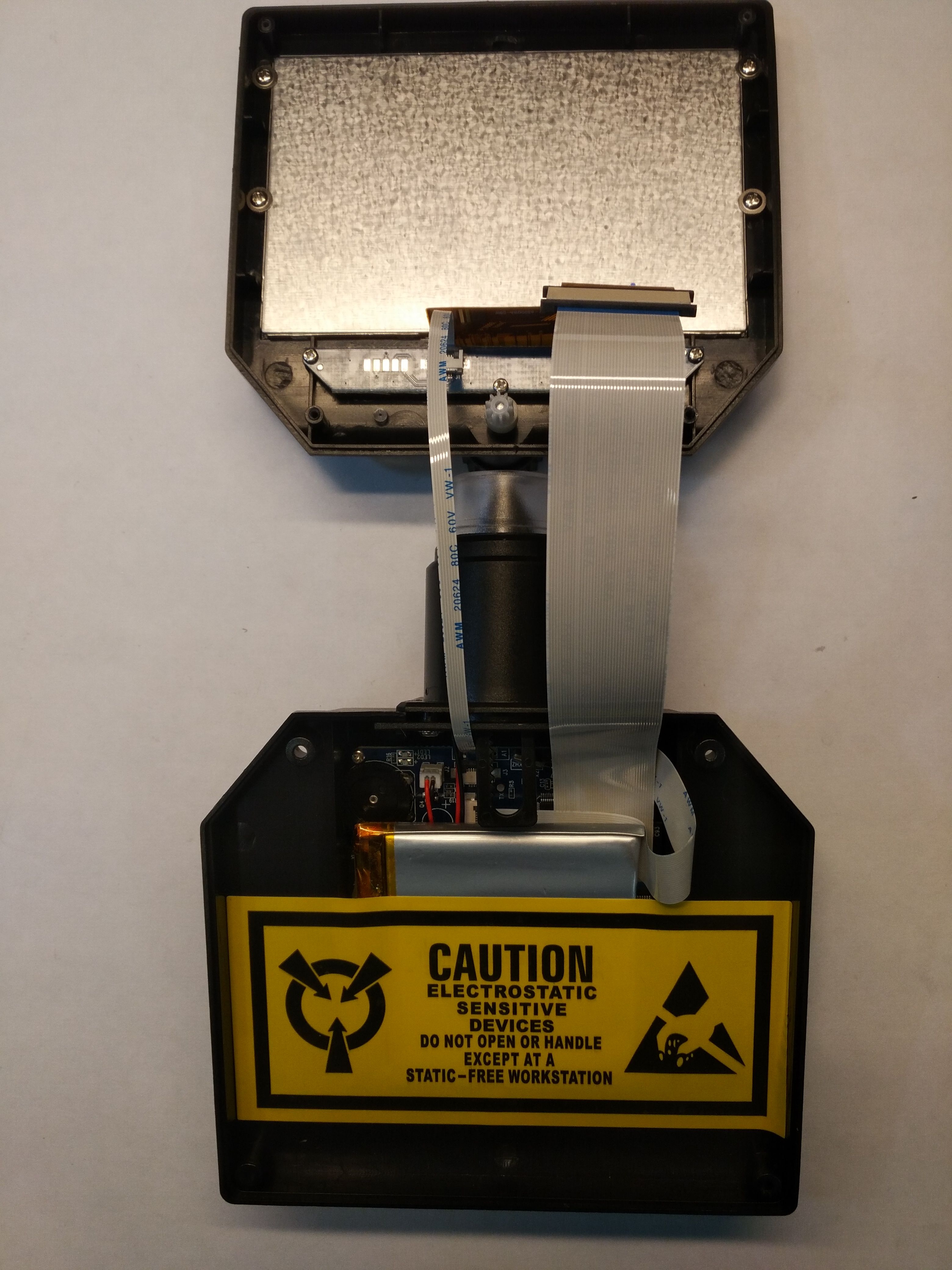

    I also allowed myself to disassemble the microscope, because something was wrong with the focus / zoom knob. I was also interested in what type and capacity of the battery I would find inside. After taking it apart, it turned out that the structure of the lens "regulator" is the same and it cannot be improved quickly.
    I didn't read the battery capacity either, because I didn't want to tear off this beautiful yellow sticker (after all, the equipment is not mine). You can see, however, that the cell is not much larger than 103450 (which can be obtained from laptop batteries and has a capacity of 1800-2000mAh, so the original battery can be easily replaced).

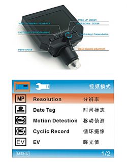

    Allow me to attach three photos from the auction (I think my friend will not be offended).

    Colleague Artur k. as promised, he visited me today with his microscope. As I did not have the 25Q80 memory available, we decided to start the game by trying to read the damaged microscope Bestler test carried out with the programmer Arthur , not knowing why it failed, either with a clip or after desoldering the chip. And not because something was wrong with the microscope / memory, because the same test on a working device also failed. So I connected my programmer, connected "suspicious" memory and read its contents. Scalak was clean.
    So I connected the clip to the memory on Arthur's microscope's plate and downloaded the batch.
    We decided to try to program this empty memory from the outlet. Unfortunately, the attempt was unsuccessful. As I did not have the 25Q80 chip at hand, I used the 25Q32 in a slightly larger housing, but it easily replaced the previous one. I uploaded the batch, the verification was successful. I soldered the memory, pinned all the tapes and soldered the battery ...
    Now the moment of truth :D , fire up ...
    And unfortunately we have the same effect, ie the microscope "hangs" on the welcome screen. :(
    The next attempt is to read new memory, the result is the same as before - clean chip.
    Another programming attempt was unsuccessful, it looks like another scaler has failed. I'm afraid it might not be possible to fix this.
