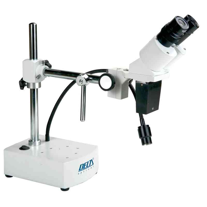

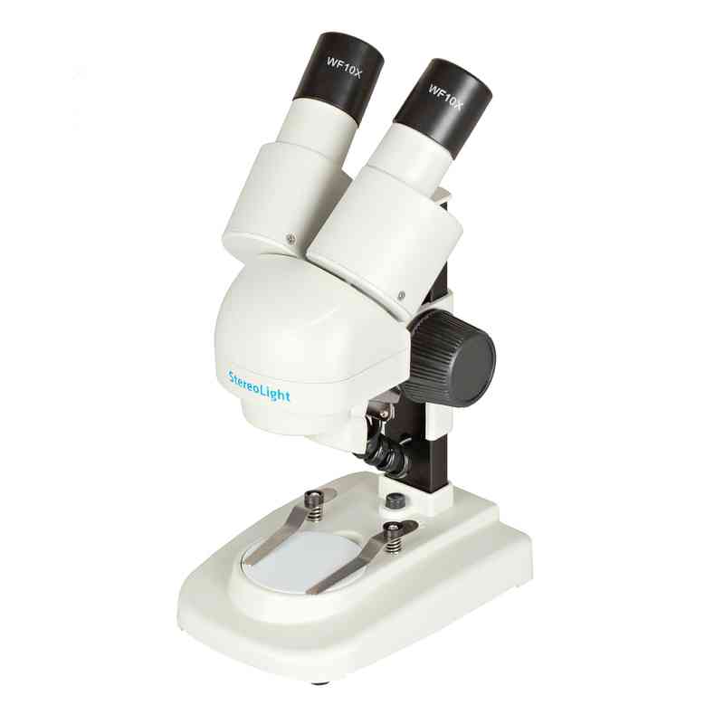

    I have a Delta Optical StereoLight microscope, the cheapest of the offer, plastic housing, maximum working distance only 7 cm. I gave 200 PLN. The image quality is very good. Adjustable pupil spacing. Fixed magnification 20x, but it's enough for me. I rarely use it, hence this model. But they offer a lot of models that you can adjust to your needs and budget. They are with and without booms, smooth and constant magnifications. It is possible to rent for testing, although it costs money. Alternatively, ask if you can check the models before buying, in a stationary store.
    I'm uploading sample photos (mine is the one on the right) and the website address:
    https://deltaoptical.pl/
    • Choosing a Microscope for Electronics & Grain Inspection: Budget 2000 PLN, Durable Option Mikroskop Deltaoptical2.jpg (10.19 KB) You must be logged in to download this attachment.
    • Choosing a Microscope for Electronics & Grain Inspection: Budget 2000 PLN, Durable Option Mikroskop Deltaoptical1.jpg (13.42 KB) You must be logged in to download this attachment.
    • Choosing a Microscope for Electronics & Grain Inspection: Budget 2000 PLN, Durable Option Mikroskop Deltaoptical3.jpg (18.22 KB) You must be logged in to download this attachment.

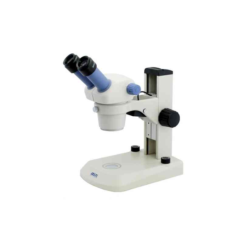

    https://deltaoptical.pl/zestaw-mikroskop-ster...-delta-optical-sz-430b-statyw-f2?from=listing Something like this minimum, because it has a tripod...
    or... https://deltaoptical.pl/stereoscopic-microscope-delta-optical-discovery-l?from=listing

    Both products and Delta itself as a company/distributor is a failure. Look for other solutions and/or resellers. Take a look at Optek

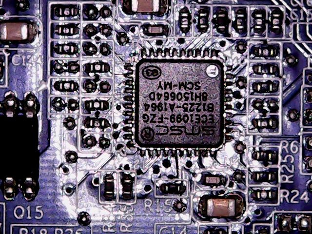

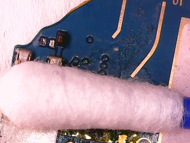

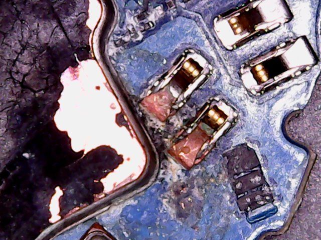

    The microscope came... Techrebal K10H + 2x lens. The image is super accurate, on the computer from the car you can see chicken and others. I will write something after a longer diagnosis, my beginner's 2 cents. Overall, I recommend it, all metal, well made. Regards.

    Not that I'm picking on you, but maybe check first if it even has a substitute for sealing the body, before you recommend it ;)
    I will mention the method of mounting the mirrors, the possibility of calibration, etc.

    It's clear to me... that you need to use a barlow lens for the microscope for soldering. Anyway, I don't solder enough to worry about it. Lens, e.g. 1x to keep the default parameters and it's cool.
