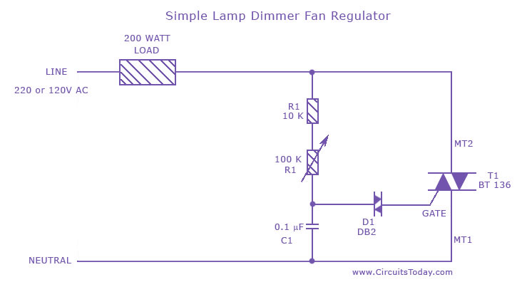

    It is possible, you need a phase regulator on a triac or thyristor with a current carrying capacity of at least 6kW/230V = 26A , since triacs are quite cheap a BTA41-600B, for example, will be plenty suitable.
    Simplest triac control scheme + potentiometer.
    ST408n - Can the 0-10V output control a 400V 6kW heater?
    Of course, in order to control the triac with a DC 0-10V signal, a zero detection circuit is required, which, depending on the input signal, will drive the triac to the specified power.

    All ok, except that the heater is on 400V (three-phase).

    No problem, a separate triac for each phase and of course a smaller 26/3~ 8.5A will come out.
