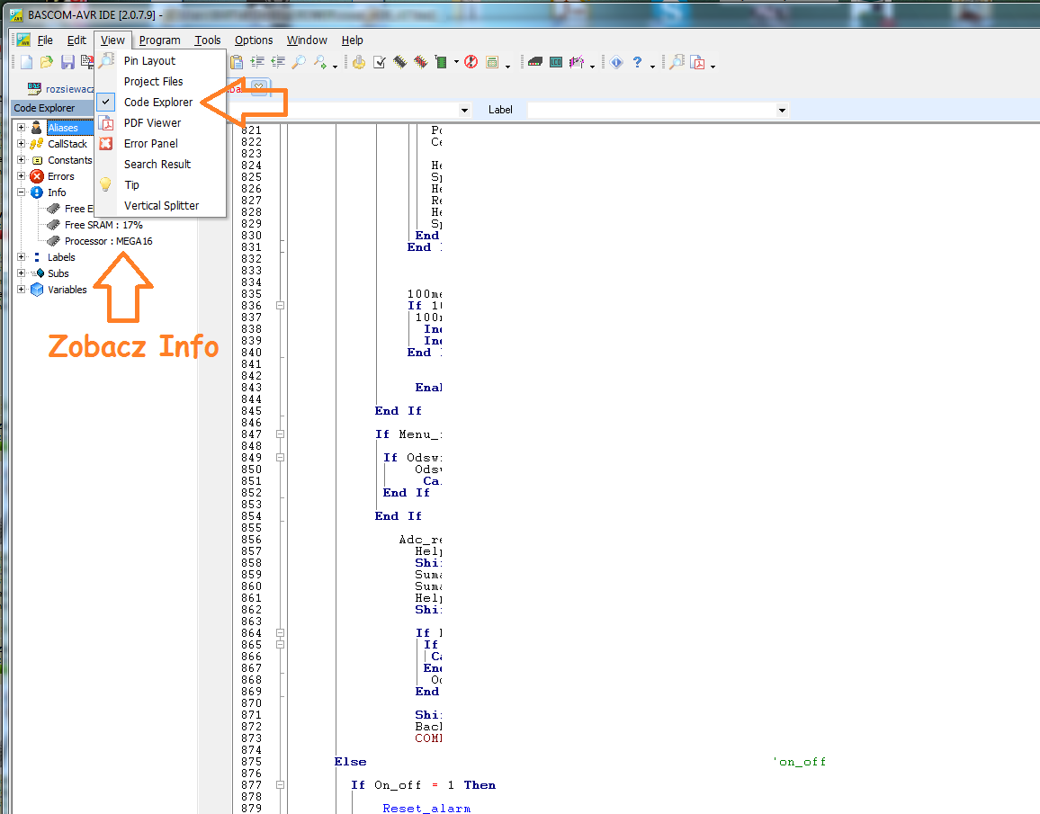

    Rate: 7
    You know, everyone has to sit down if they want to do something themselves and not monkey around
    Of course you are right mate - by the way, I was well defined by my brother-in-law who I got into electronics and controllers - I think too much about how a function works, instead of thinking about how to use it well.
    So the example works for what it is, but another module probably needs a different treatment.
    Correct, e.g. now disconnecting the board via FT232 to the PC and changing the
    Code: VB.net
    it works OK, but how it will work with the ESP8266 or with the SIM800L is to be seen in the "wash"
