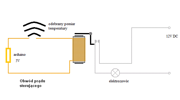

    The relay is a good solution, but I have a few doubts:
    1) I receive the temperature measurement via radio, that is, when I receive a temperature lower than 50 degrees, I put a high state on a given pin which is connected to the relay and it activates the circuit with the coil ?
    2) which relay should I choose?
    3) this is more or less how it should look like ? :)
    How to Power and Control a 12V Danfoss Solenoid Valve via Arduino Uno and Wireless Sensor
    So I then quietly use the power supply to turn on the valve, yes?
    This diagram of yours sorry, scares you :cry: Relay dedicated to Arduino, 5V, with protection, some pennies.....Temperature too high, you set ,,0'' on output µC, relay lets go and disconnects solenoid valve or this ,,something''. Is that so difficult? By the way, familiarise yourself with the symbols of the electrical and electronic components, because from this it hurts your eyes :D

    Are you assuming that the 12 V coil of the central heating valve will be controlled by 5 V?

    So what should it look like in the end?
    I thought the relay solves everything, the valve would be powered by a 12V supply with one wire going to the relay and the relay would be controlled by this 5V?
    Is there anything else I'm missing from this circuit?

    And so for hours this valve will draw ~20W from the grid? A very uneconomical solution.
    Maybe look for another solenoid valve that only draws power when closing/opening.
