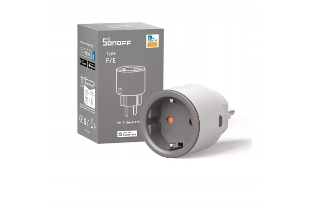

    Sonoff S60 socket
    White Sonoff S60 smart plug next to a gray retail box on a white background
    At first I had a problem with uploading the new software (here I'm running on Supli), in probably 3-4 times it went and it started to work, but I want to change something and the stairs started.

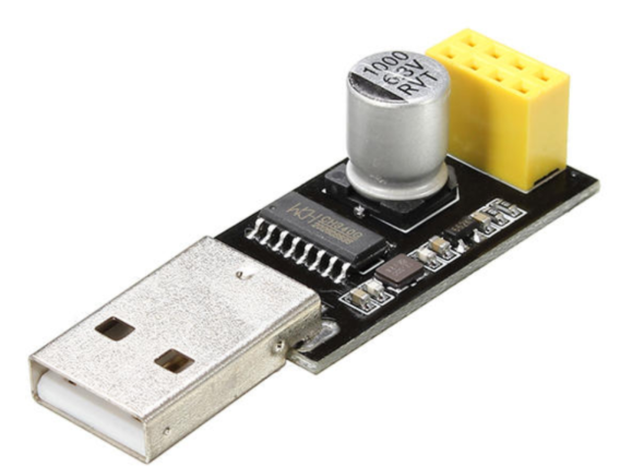

    At the moment however I try to upload something I get different errors depending on which WEBTool, but it looks like there is an "ESP32 Chip sync error esp_sync_blocking". This is what Flash Download Tools 3.9.10 reports, looks like bootloader corruption? I uploaded it with something like this:
    USB adapter module with capacitor and yellow pin header on a black PCB
    Now I have tried other USB programmers on the CP2102 and all the time it looks like TX goes, while no RX response.

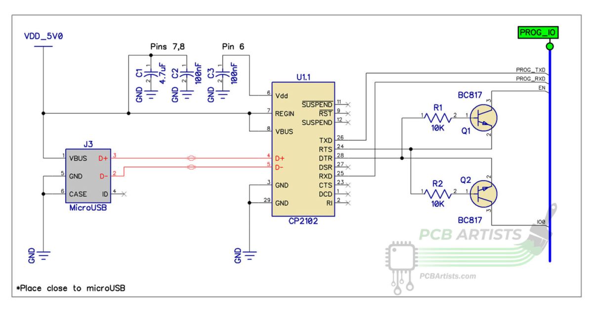

    Yes the soft is uploaded, not mine, but it is and it works, but I want to clear this socket and upload something else. I did a little experiment and it looks like the problems started after that. I don't know how to do it via OTA, while I wonder if it would go via JTAG, because I have some programmer that supports that. I've also read that there are sometimes problems with these ESP32C3s on devices with dedicated PCBs, as here in the S60, because you need an additional circuit on 2 transistors and often there is an additional delay capacitor missing on the EN pin (there is none here in the S60).

    Does anything at all appear on this uart when power is applied? Is there a jumper or switch from the BOOT pin somewhere?

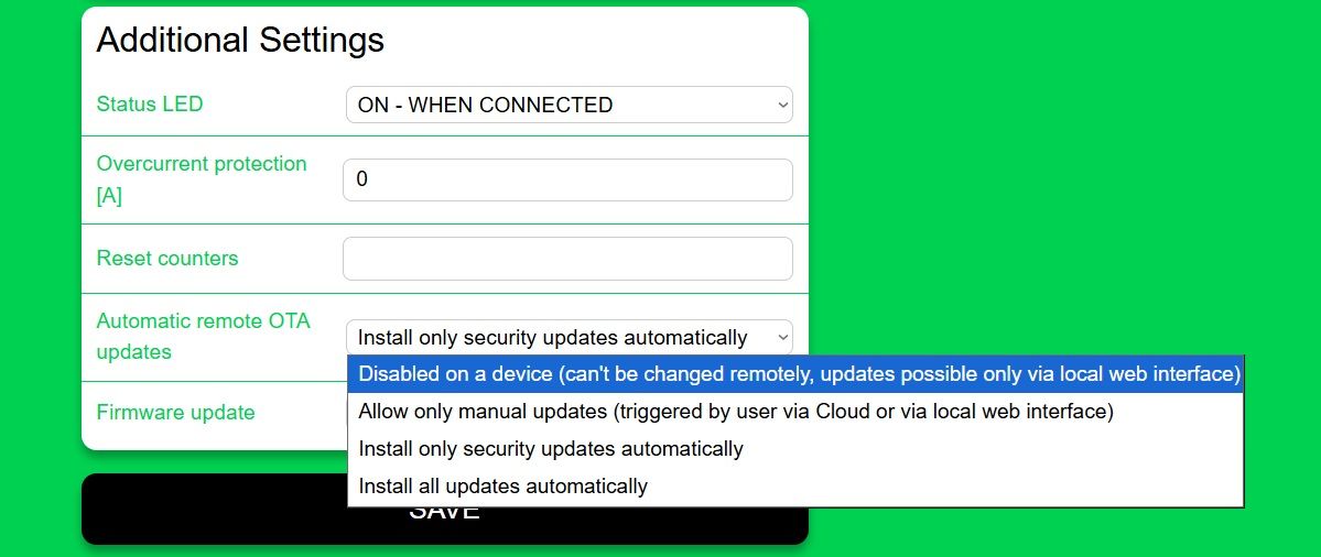

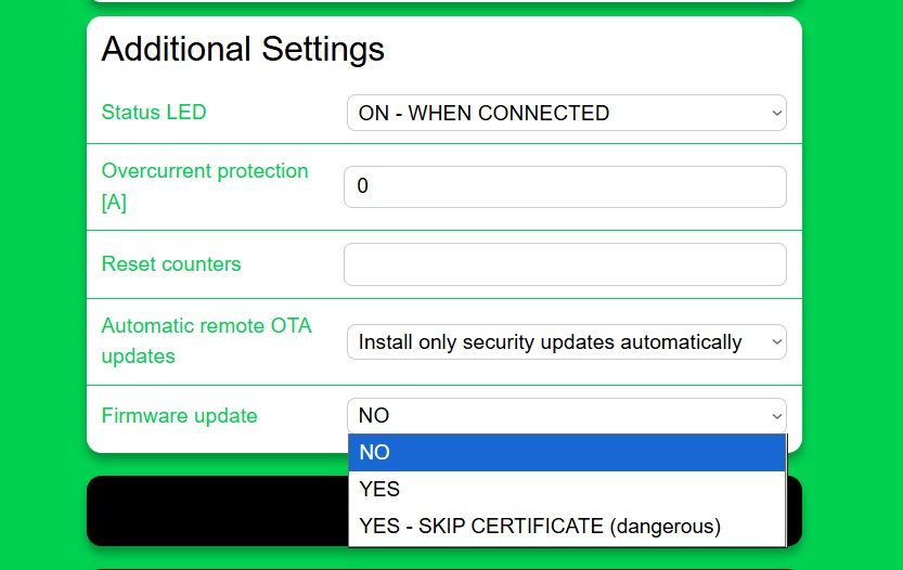

    I think the supli gui-builder had an OTA - but as I remember correctly you had to activate it when creating the "project".
    When you reset the device, a new wifi network will appear - connect to it - go to the standard supla-device IP (192.168.4.1) - the device config will open and there should be a firmware change via wifi (OTA)
    https://gui-generic-builder.supla.io/guide/aktualizacja-oprogramowania
