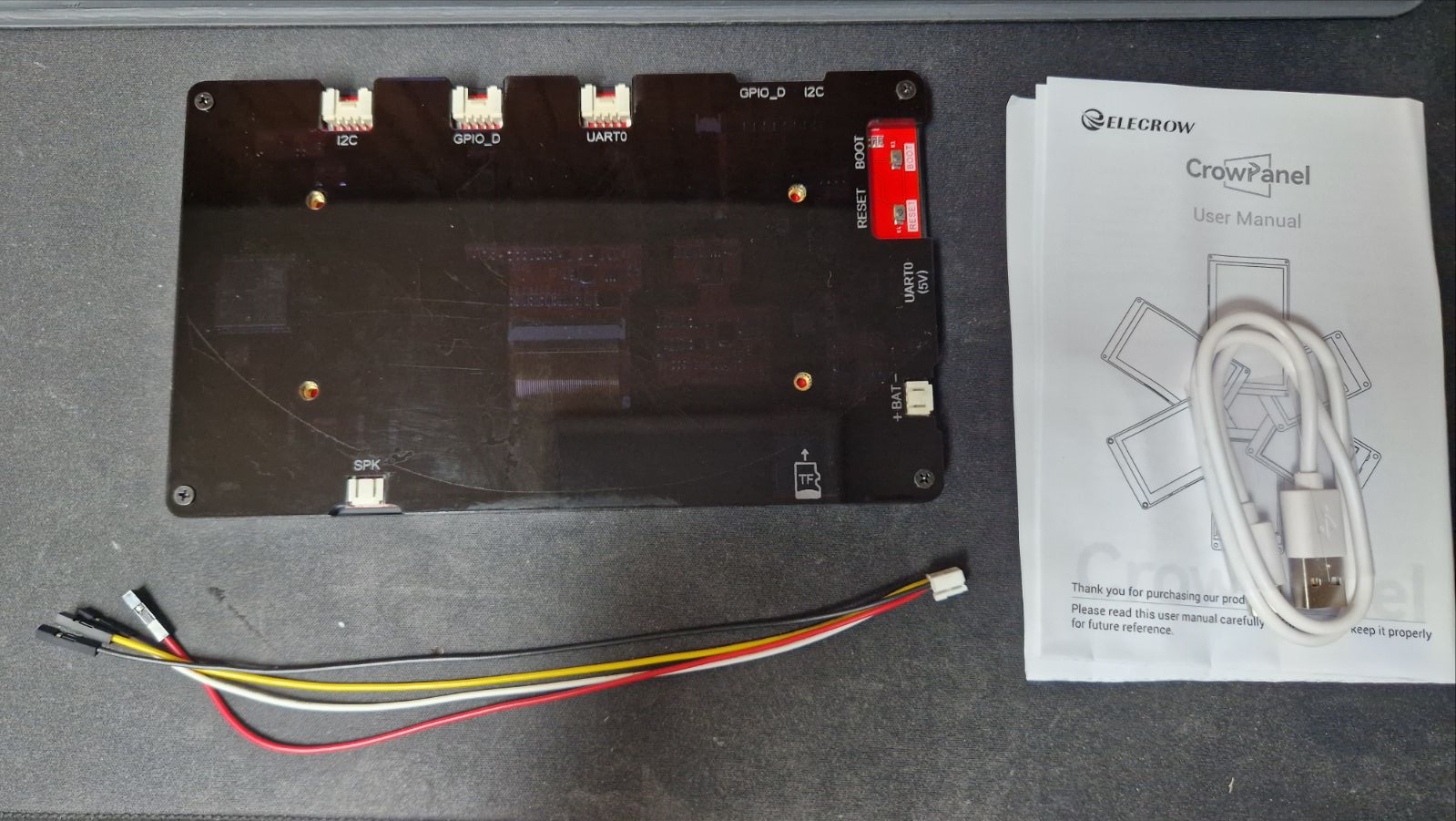

    The CrowPanel DIS08070H is a 7-inch capacitive touchscreen HMI with a resolution of 800×480 pixels, designed as a ready-to-use platform for building user interfaces in embedded systems. The device is based on the ESP32-S3-WROOM-1-N4R8 module, which offers a dual-core Xtensa LX7 processor clocked at up to 240 MHz, 4 MB Flash and 8 MB PSRAM, as well as built-in Wi-Fi and Bluetooth 5.0 connectivity. The TFT-LCD display used utilises the EK9716BD3 and EK73002ACGB control chips, operating in parallel RGB interface mode for an 800×480 panel, enabling smooth graphics in libraries such as LVGL without the typical performance limitations of the SPI bus. This is complemented by additional hardware interfaces (UART, I²C, GPIO), a microSD card slot and audio output, allowing the panel to be used as a solid base for many IoT and automation projects.

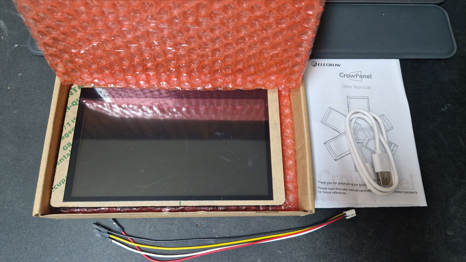

    The device is available to buy for around 100 PLN. It also comes with cables (USB and Crowtail/Dupont) and a brief manual.
    7-inch touchscreen display with ESP32S3 - CrowPanel DIS08070H - how to run with LVGL? 7-inch touchscreen display with ESP32S3 - CrowPanel DIS08070H - how to run with LVGL? 7-inch touchscreen display with ESP32S3 - CrowPanel DIS08070H - how to run with LVGL?

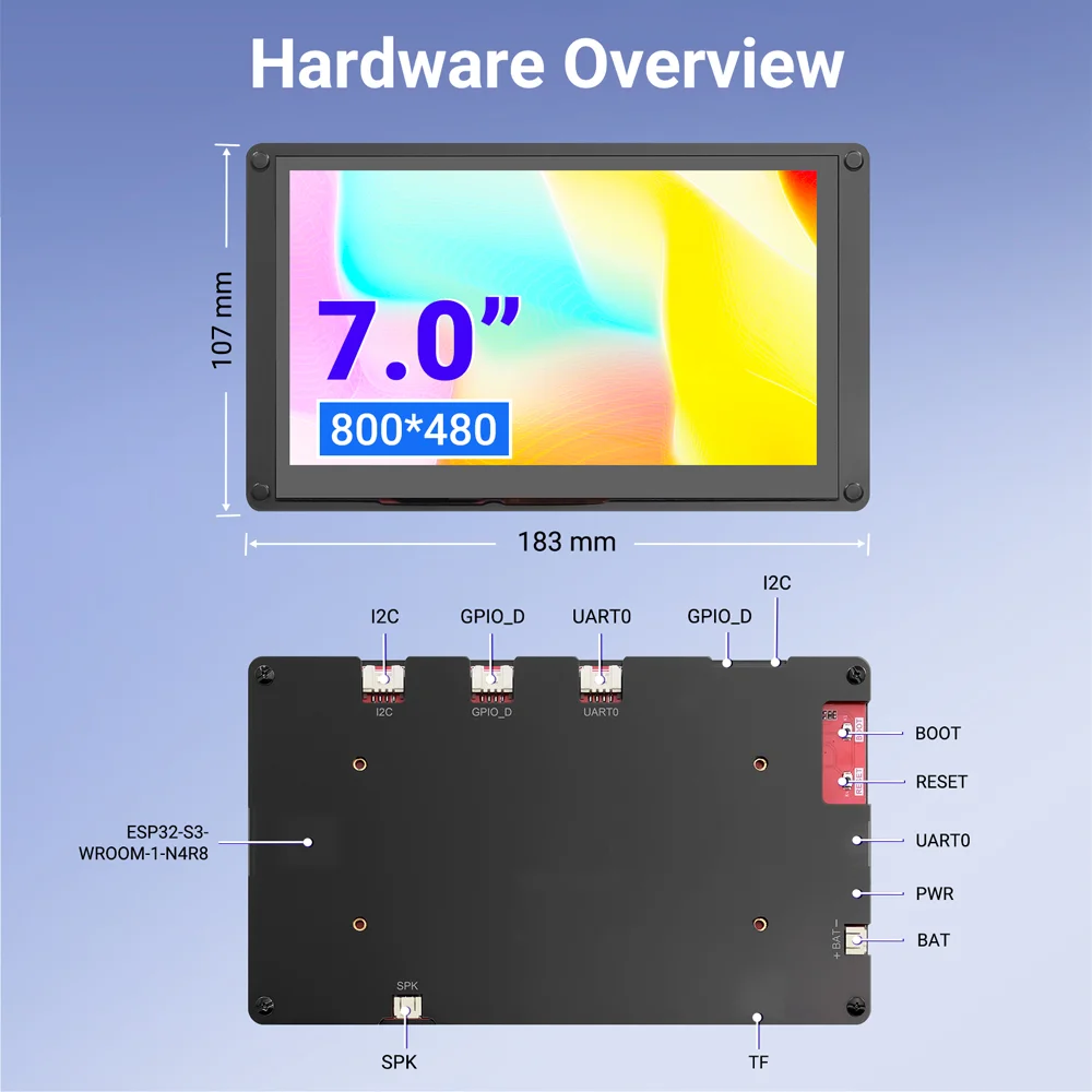

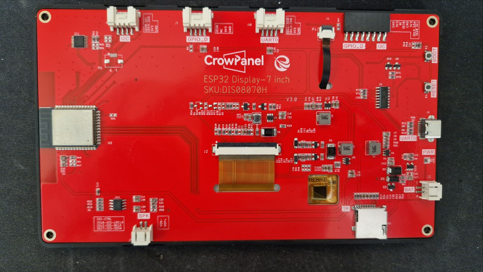

    The specific location of the connectors is shown in the graphic:
    I have included the diagram as an attachment in PDF format.

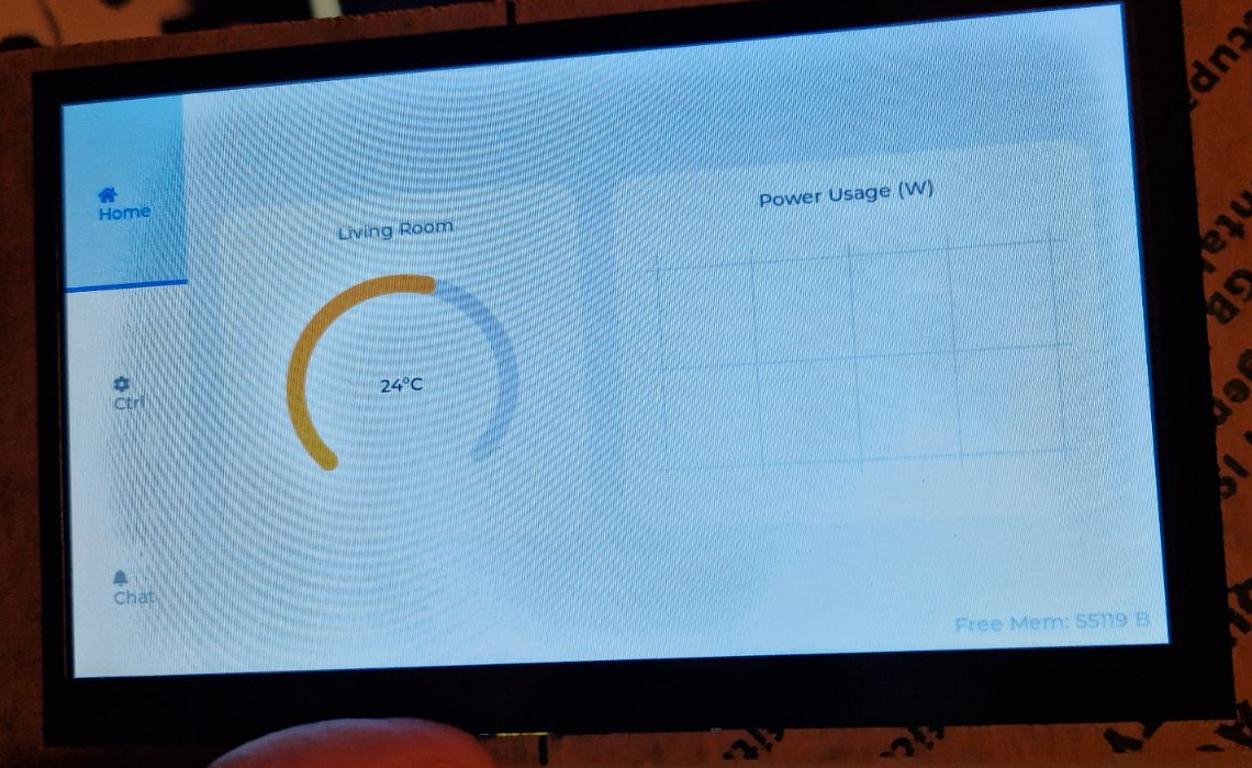

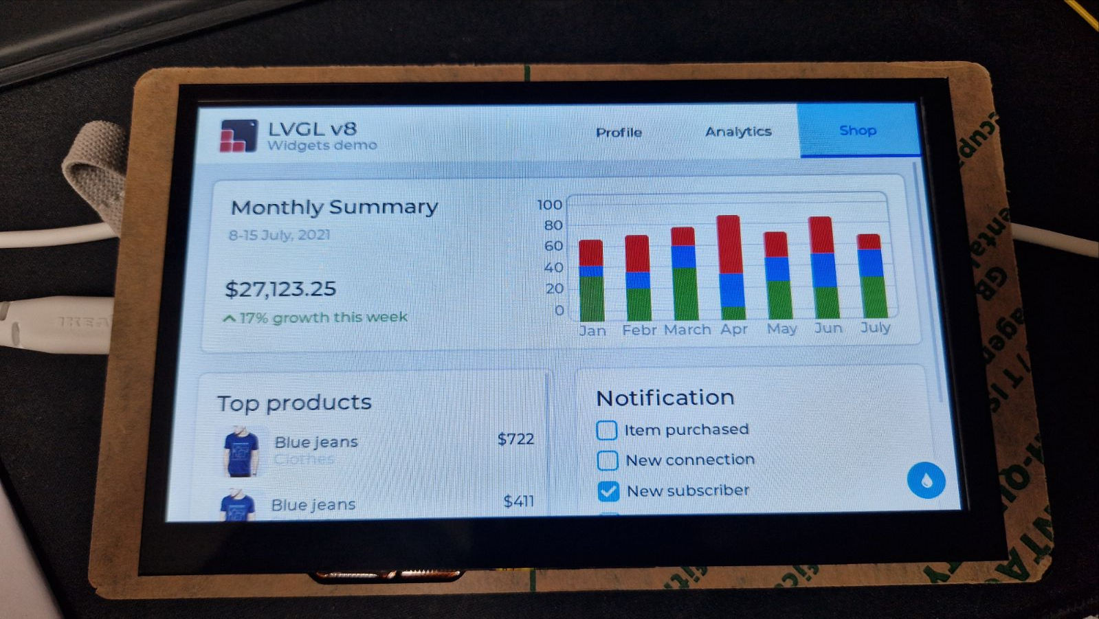

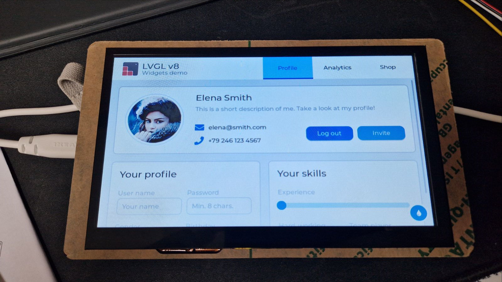

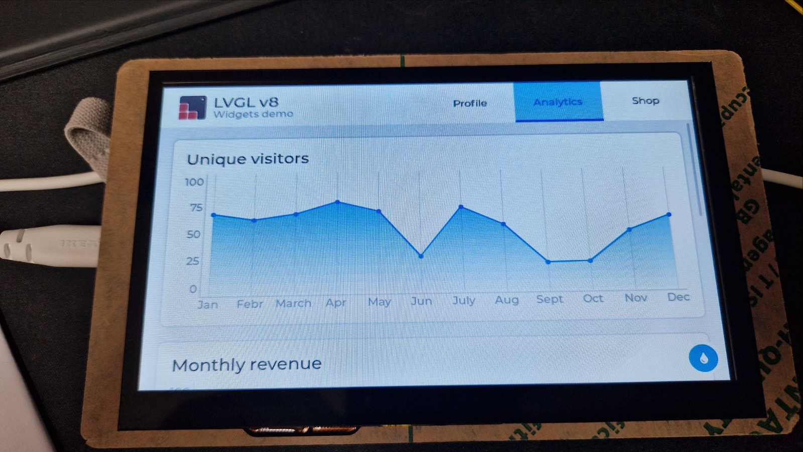

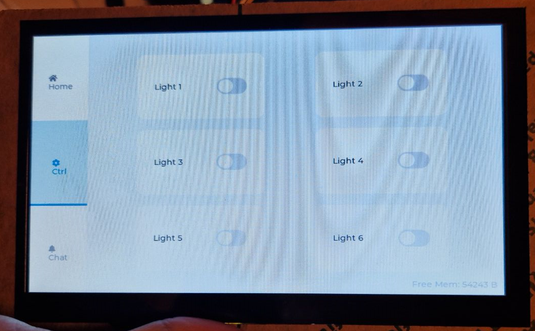

    Here are the results:
    Example code (in our OBK, but in PlatformIO/ESP IDF LVGL would be identical):
    Code: C / C++
    In summary , this was another platform for the LVGL experience. In this particular case, the display was based on EK9716BD3 and EK73002ACGB controllers (RGB interface) and the touch was based on a GT911 chip, but this makes very little difference to the Waveshare discussed earlier, especially as everything is hidden under the hood of the library used. The ESP32 Display Panel has again risen to the challenge and shown that getting started with LVGL is not that difficult at all.

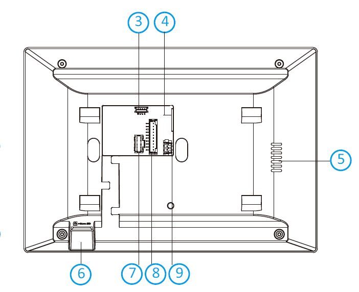

    I am always puzzled by the idea behind the designers of such devices. A nice screen in a black casing and cables going off in different directions? What's the point of something like this? You can neither hang it nor put it up. Below is an example of an indoor panel (touch screen) of an IP intercom with camera:
    Technical drawing of a device’s back with labeled connectors and mounting points

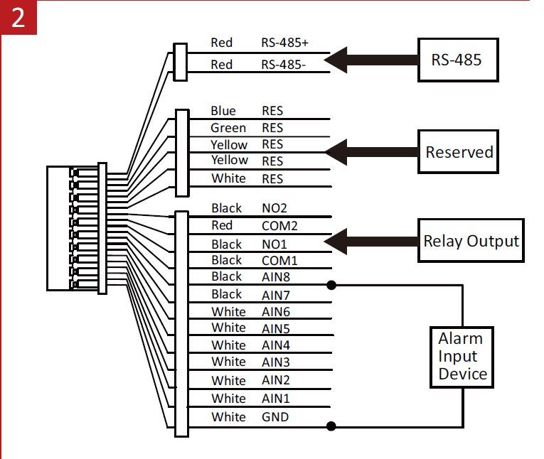

    All the leads (except the SD card slot, which is not visible anyway) are on the back. Mounting on a flush-mounted box. in one place we have Ethernet with PoE, a separate power supply and even an expansion connector:
    Wiring diagram with connector and labels for RS-485, Reserved, Relay Output, and Alarm Input Device.
    Such a thing makes sense.

    @ArturAVS we have uploaded the factory batch:
    This is what it looks like on their advanced GUI. Well it is not Android. You can feel the low FPS. Exactly the same as... in the previous topic in the series:
