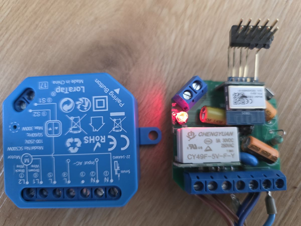

    LoraTap SC500W V4 Template for BK7231N board 2603 OpenBK7231N 1.18.288
    What exactly do you need help with here — verifying this template, fixing a problem, or identifying the correct pin/role setup for the SC500W V4?
    Just to share template for others.
    What firmware/platform are you using this with, and what happens now when you flash/apply this template (works partly, nothing works, wrong relay behavior, button issue, boot loop, etc.)?
    OpenBK7231N_QIO_1.18.288.bin

    Ah, a shutters relay, nice! Thanks for sharing. What's the purpose of startup command script? In OBK, we recently added a dedicated Shutters driver - it should be better for this purpose. I think it's enabled by default in recent builds. Do you original firmware backup, by any chance?

    will @anciglic switch to the shutter driver and will template change?

    Well, as long as pins are correct, it does not matter that much which approach (driver/script) is used.
