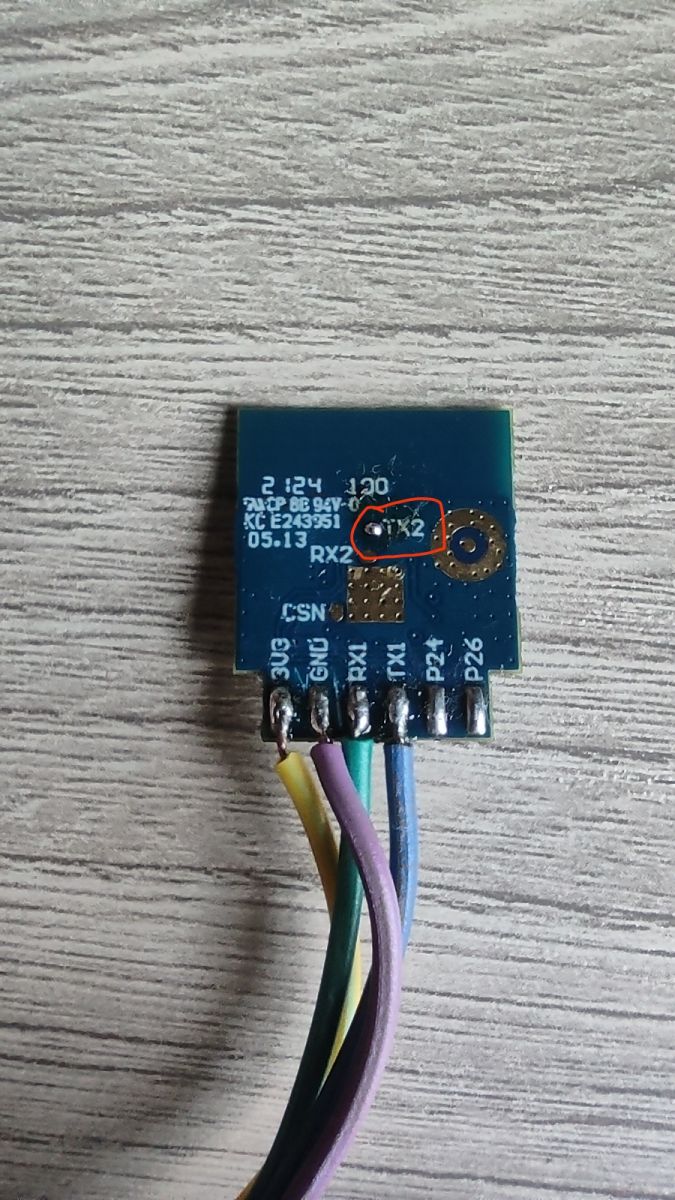

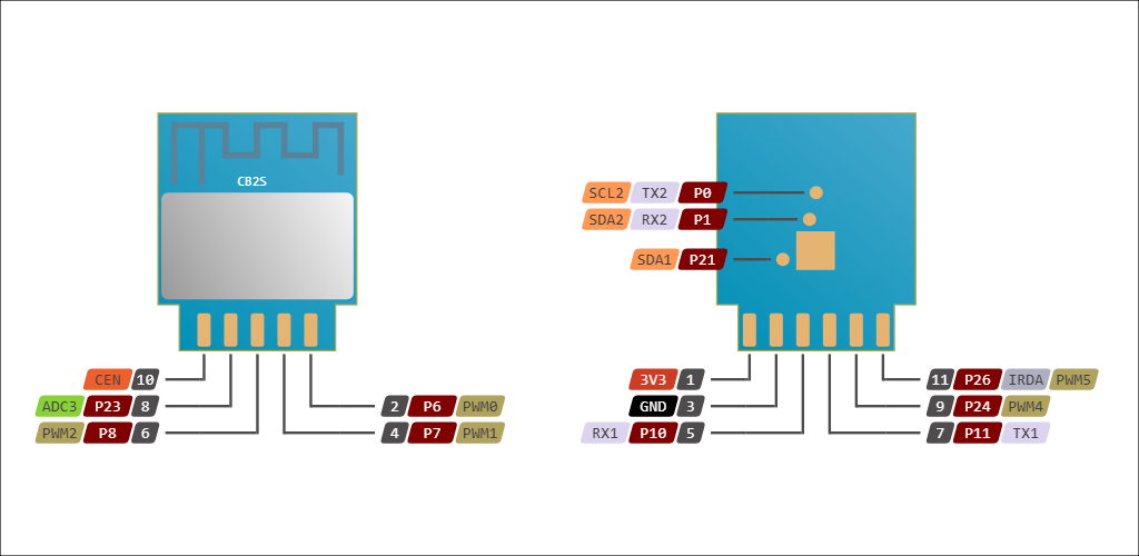

    hmm, not sure what's happening with your device. You firmware dump works OK for me flashed to CB3S.
    To confirm, you're capturing TX2 from the pad on the back as seen here:
    BK7231N DNS_led02 after latest flash wont create a Wi‑Fi AP?
  • #13 21904783
    GreedyMagnetometer
    Posts: 17

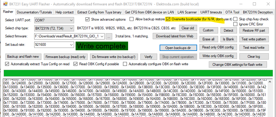

    right. sure. flash again from scratch and choose to overwrite bootloader too?
  • #15 21904893
    GreedyMagnetometer
    Posts: 17
    I downloaded the latest version of the flasher and flashed it the first time, either a coincidence or something else. Thank you for your Time.
