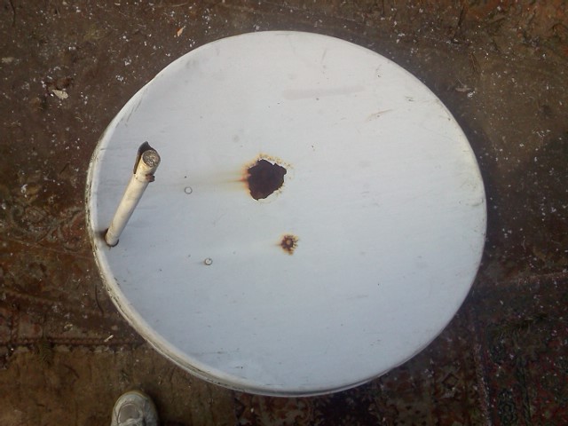

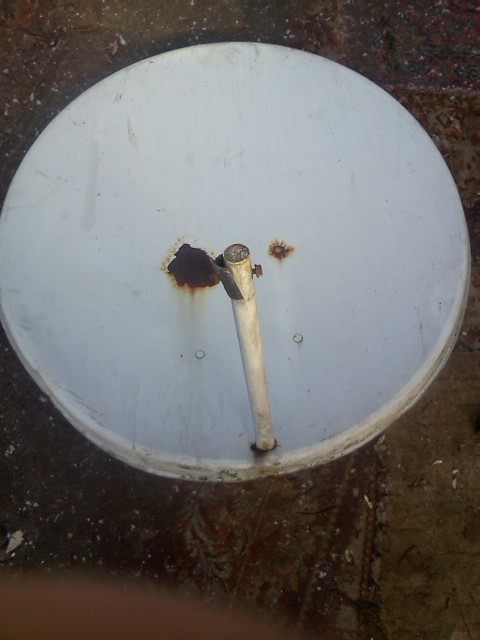

    I found an old plate without a clamp for the converter, I think it is 80cm. Would this plate be fine? It is rusty, but there are no dents like the previous one, the smaller one.

    Well, it's not actually crooked. I think I need to see an ophthalmologist. @new, green we are not learning trash!

    A new 80cm plate costs a maximum of PLN 80 (maybe those from the top shelf are more expensive ...). So cheaper than nbox. Don't feel sorry for Grandma :|

    Thanks to all of you, who advised me how and what, had patience with my lack of knowledge. I greet and recommend :) I bought this converter holder and temporarily set up the antenna using the telephone method. The old white antenna, which I gave in the picture, because my friend changed it, so 150 PLN per decoder 4.50 for the holder for the converter, 60 twin converter together for the satellite I spent: 214.50, I am proud of myself. Signal strength 70%, quality 60% and it goes nicely without disturbances all work, even those for immigrants in Arabic. I do not greet those people who wrote like "call someone who knows and give him a bottle" or "do not immerse yourself" somehow it did not motivate me too much to work.
