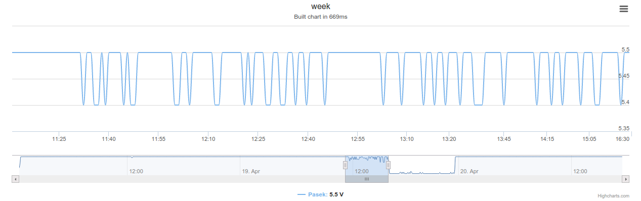

    Please tell me more why I get these readings when reading the ADC:
    How to measure the reference voltage Vref on the ESP8266-12e for the ADC?
    I have trimmed the readings to one decimal place because with two decimal places it is even worse. What does this depend on?
    #6 15617892
    tmf
    Posts: 14318
    Help: 2090
    Rate: 2203
    I don't think there is a converter in the ESP with any exorbitant performance, and the stability of the reference source also leaves a lot to be desired. Perhaps the cause lies in the circuit itself and interference.

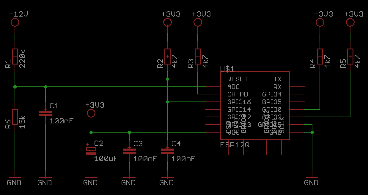

    Hmmm... ESP is certainly not a super design, but I thought it would be better....
    My connection looks like this:
    #8 15618460
    madejpm
    Posts: 13
    Firstly, what are you actually measuring. Secondly remember that the ESP is the transmitter and the wires are the antennas, if you can then try to turn off the WiFi during the measurement, or take a few/some measurements one after the other and average the result. I only used the ADC to measure the supply voltage internally and had quite reasonable results.

    I want to measure the voltage of a car battery.
    With averaging the results I have already tried. By doing 1, 8 or 64 readings and taking an average from that, it doesn't change anything ;(
    I will still try with turning off WiFi for the duration of the measurements.
