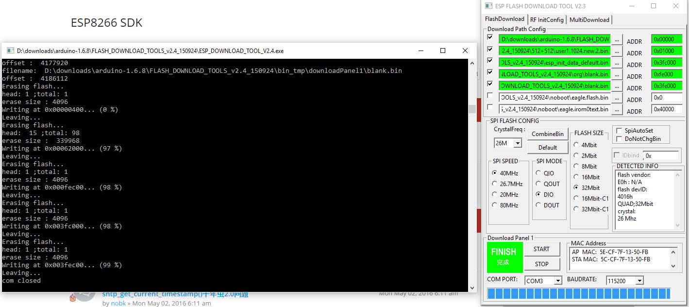

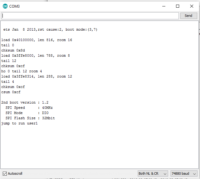

    I've tried the official sdk 1.4, 1.5.3, nodemcu, basic scripts via ide arduino and it looks the same every time - the program is uploaded correctly but won't bot.
    Do you have any idea what could be the cause?
