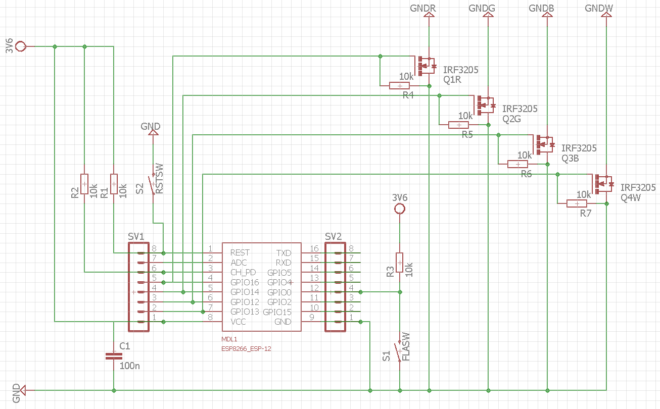

    As a beginner in electronics, I would very much appreciate if you could check if the presented circuit is correct.
    The circuit is based on an ESP8266 chip to act as a driver for an RGBW LED strip over the internet. This is my first circuit drawn in Eagle and the first circuit I want to "iron out" a PCB from.
    Is there anything missing from the schematic (apart from the connectors for the cables, which I have yet to attach to the schematic)? Do I have any errors in the schematic? What is worth looking out for in the future?
    Thank you in advance for any help and advice.

    GPIO15 connected to GND
    GPIO02 via resistor to VCC
    You can give 220uF at the VCC leg of the ESP
