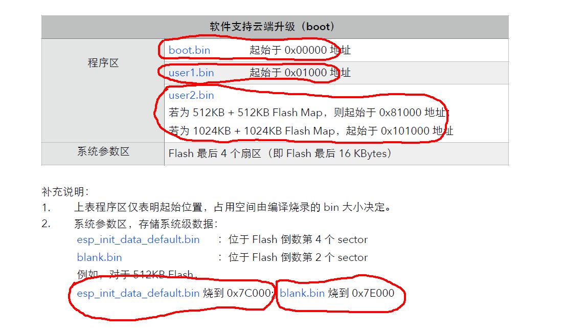

    I want to upload the latest firmware for esp8266 from the website:
    http://bbs.espressif.com/viewtopic.php?f=46&t=2198#p7002
    I need to do this under Linux Fedora 23, and I can't seem to get it to work.
    Please help.

    My glass sphere is broken, so clarify the term "does not go". Read the documentation, especially on connecting the ESP module and using esptool.py.

    It's not going, i.e. I don't know what addresses to enter for each file and on what basis. I have mastered the upload itself. using the esptool.py command.
    Of course I uploaded older firmware where these addresses were given :)
    Added after 34 [minutes]:
    OK. I think we've managed to embrace. I'm pasting the download. Time to learn Chinese :)
    How to Flash Latest ESP8266-01 Firmware on Fedora 23 Linux?esp8266_fi...layout.jpg (93.31 kB)You must be logged in to download this attachment.
    Thanks for your help and apologies for the bullets.... ;)

    Oh no, not Chinese at all...
    After all, there is a README.md file in the archive, in the firmware directory, in English.
