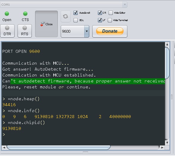

    Hello i have a problem with my ESP once i got the chip i uploaded the latest software 0.9.6 everything uploaded without a problem.Now using the ESP config program i wanted to configure it but the chip doesn't respond at all to at commands it only pops up AT+CWMODE? stdin:1: '=' expected near '+' . Using ESPlorer there is also a lack of response to AT commands sometimes after several minutes the chip responds to which commands ??

    The firmware you have uploaded does not have AT commands. Programming is done in the LUA language.

    I was just wondering why the uploaded programs work and the commands themselves no longer :) thanks for your help
