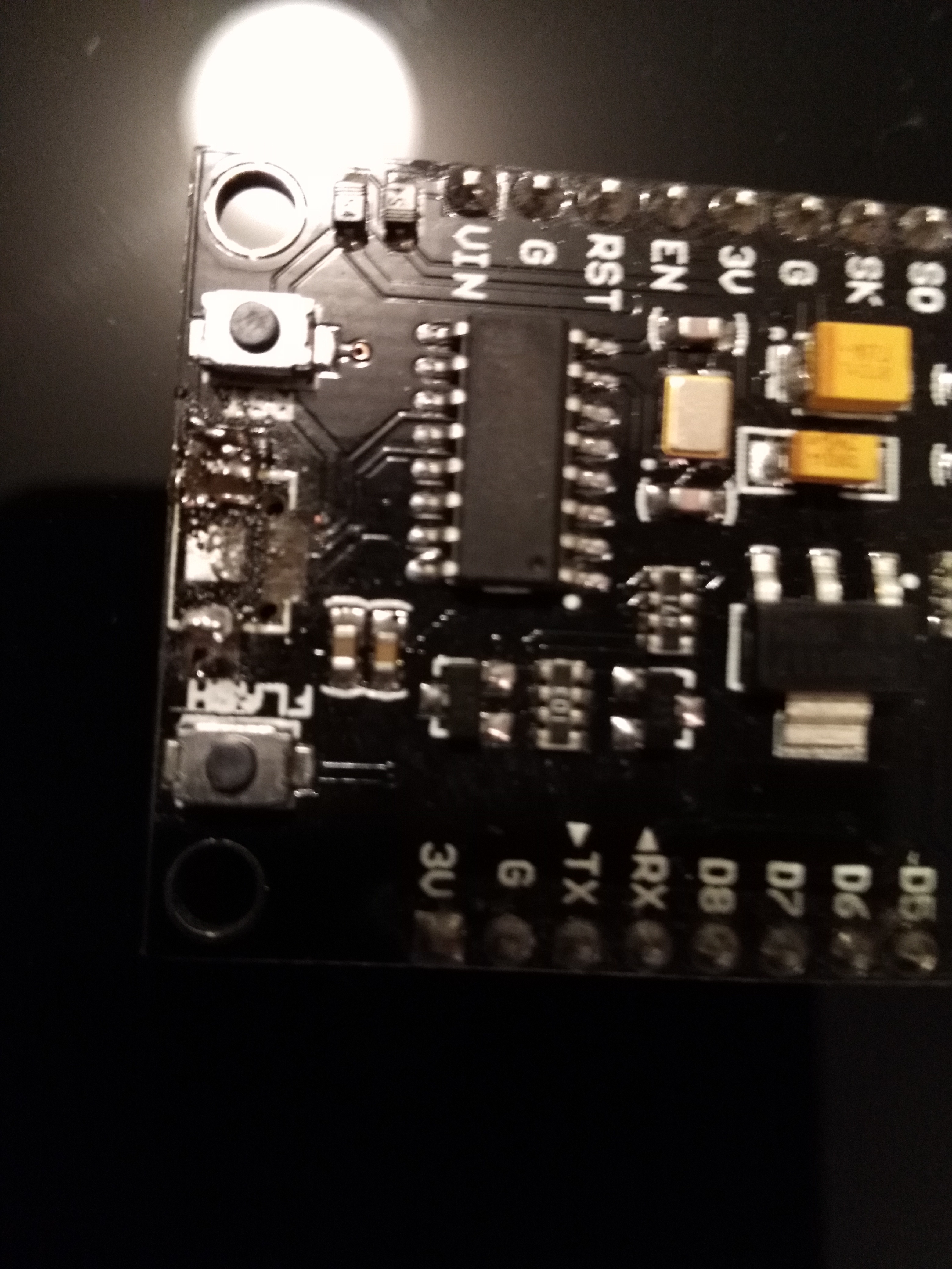

    Fellows I have a nodemcu with a broken usb socket.

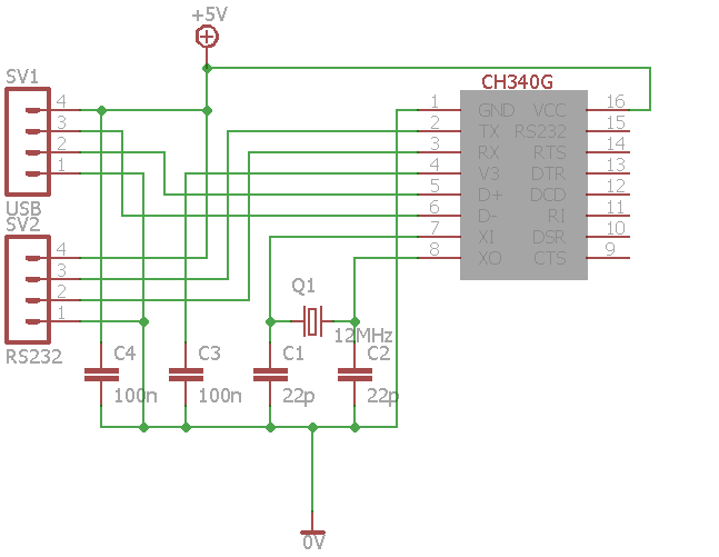

    After an unsuccessful repair attempt by a friend I came up with the idea to hard solder a usb cable.
    Since I bought myself this nodemcu the communication over serial and from the ttl adapter did not work. And here is a request to mark on the photo the usb cable soldering points. I tried to examine this with a meter but the tracks are too small. Nodemcu faulty usb repair

    I know that from the dot. Thank you tomorrow soldering iron in hand.
    I have looked but as you can see not successfully. I am not closing the topic until I fix it. Thank you

    Remember to fix the usb cable - e.g. pass it through a hole

    I soldered the usb cable according to the schematic.
    I only connected the vcc straight to the 3.3v stabiliser.
    As for communication, out of two ttl adapters, not a single one communicated with the nodemcu. I even tried uploading something via arduino Leonardo and nothing.
    But with a working usb I don't need it anymore.
