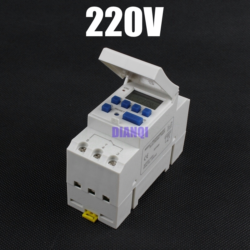

  • #6 16069518
    gigit
    Posts: 204
    Rate: 45
    Witek76 wrote:
    This is sufficient for a single channel timer. To use the NO contact for the first pump, and the NC contact for the second pump.
    Thanks for your interest, could you please send me a link to the contacts and how to connect this. I have a controller like this Link
    I found something else like this
    • Controller for two water pumps 1435732073-626777925.jpg (436.55 KB) You must be logged in to download this attachment.
  • Using relay contacts to alternate two pump outputs
    #7 16072064
    Witek76
    Level 25  
    Posts: 568
    Help: 78
    Rate: 230
    gigit wrote:
    The controller I have is Link
    Here you would need to use an additional relay to switch off pump 1 when pump 2 is switched on by the controller. As MARIUSZ R wrote earlier.
    In this case it will be simpler: mains power - L phase to COM contact (3), you connect pump 1 to NC contact (5), pump 2 to NO contact (4). Of course, on the other side of the controller you need to connect the L and N supply (these terminals are not shown in the photo), and N to pumps 1 and 2.
    I point out that I don't know the software capabilities of the aforementioned controllers, you'll have to check in the manuals if they can be configured in the way you expect.

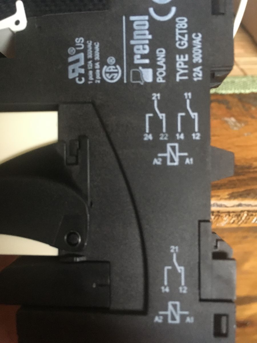

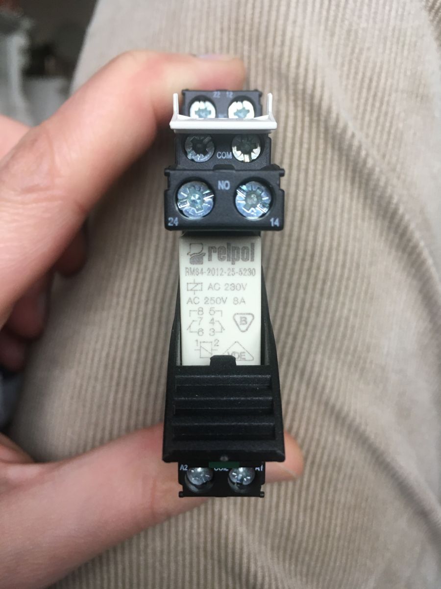

    Welcome to the new year. I have an interface controller but now I don't know how to connect it , could someone advise me how to put it together? Specifically I mean where and how to connect the power supply, where to connect the timer controller and how to connect the two pumps.
    Controller for two water pumps Controller for two water pumps
  • #14 18480810
    kkknc
    Posts: 23787
    Help: 1916
    Rate: 6722
    It is a two-track relay. Not a controller. The schematic is on the housing. If you can't make it, I'll describe it for you....
  • Wiring LEDs for mains power and timer pump status
    #15 18482349
    gigit
    Posts: 204
    Rate: 45
    Actually ... i have looked at this relay thoughtlessly, i.e. the power goes to COM terminals 21 and 11, the pump, which is to be permanently powered, goes to NC 22 and 12, then the timer pump to NO 24 and 14, the COIL switch A1 and A2. I would also like to connect some LEDs to signal the operation of this system, is there anything that can be directly connected to the 230 power supply or will an additional power supply be necessary? Specifically, I want two signals, the first for the entire system that the power is on (e.g. green), and the second that the timer pump is on during operation (red)
  • #16 18482359
    kkknc
    Posts: 23787
    Help: 1916
    Rate: 6722
    There are ready-made diodes have 230V with a socket. So there is no problem.
