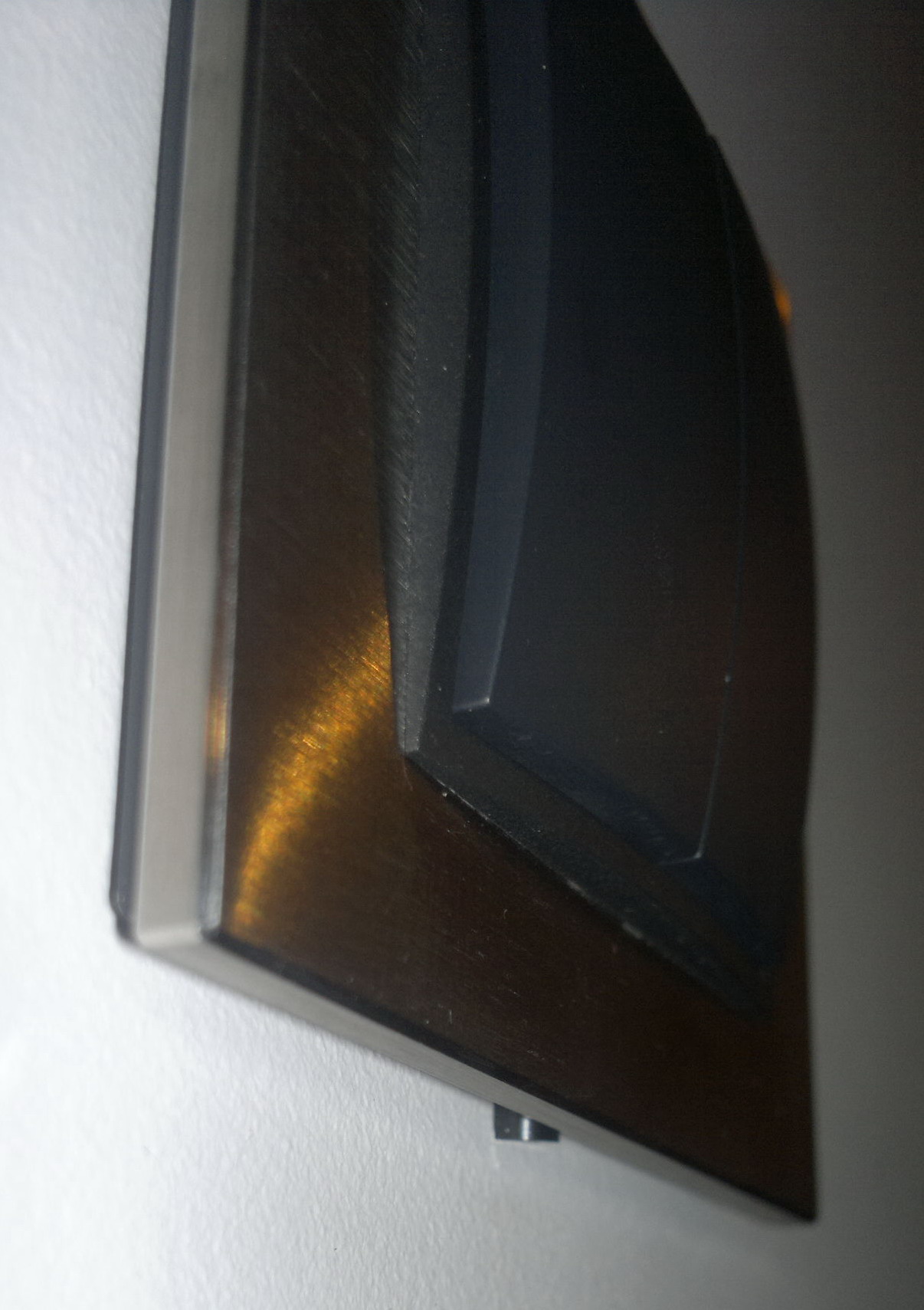

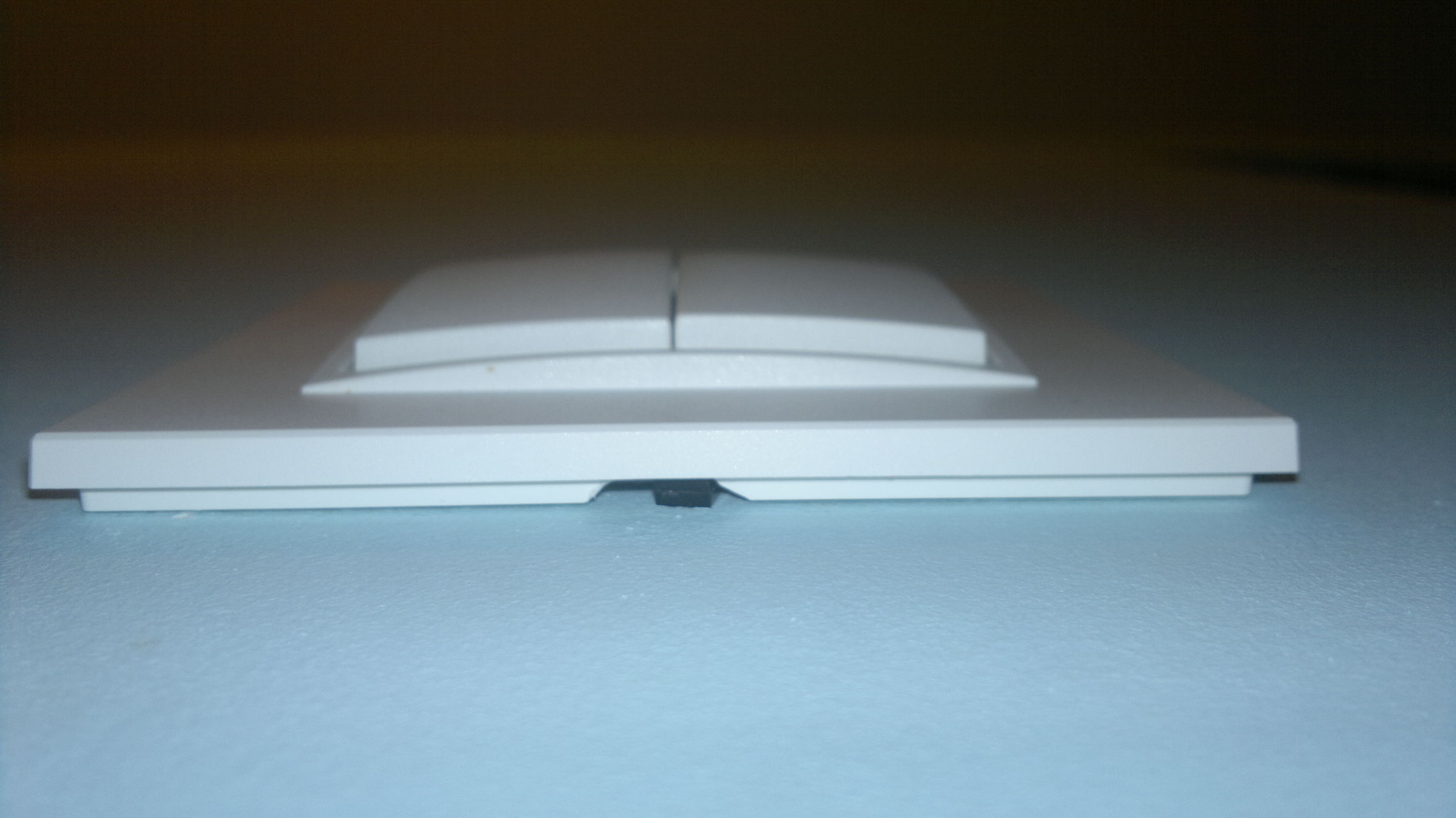

  • #6 16009770
    zulus18
    Posts: 60
    I have fitted DS18B20 sensors in my light switches, more precisely in the cut-out made in the frame on the underside. There is a quick response to temperature changes and the sensor itself is normally invisible. I have Simon 54 and Berker/Hager B7 push buttons.

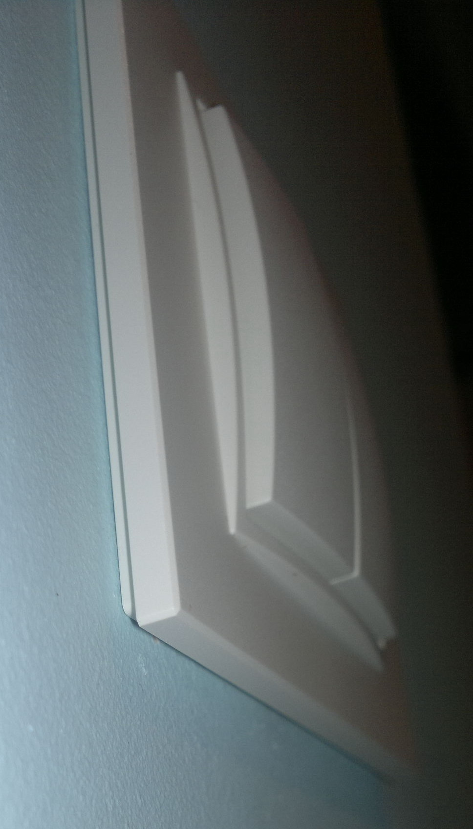

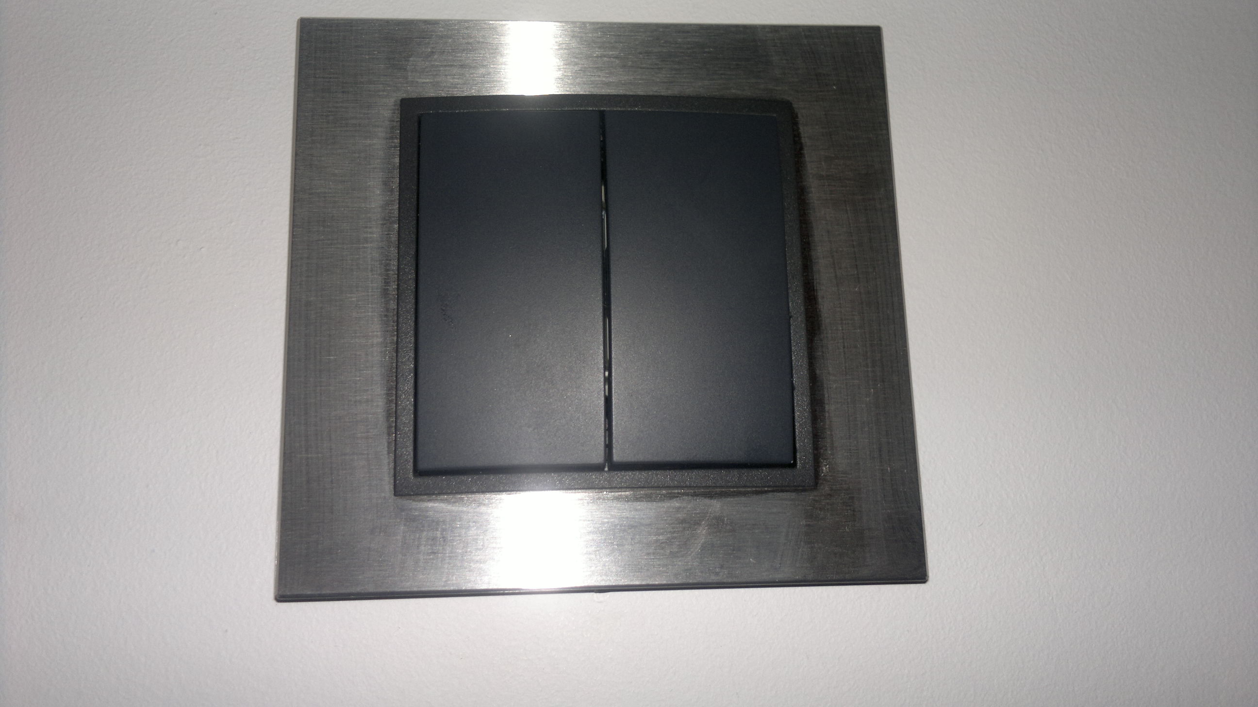

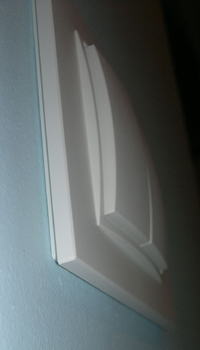

    #9 16026650
    zulus18
    Posts: 60
    In my frames it was possible to do this much more discreetly:

    zulus18 wrote:
    In my frames I managed to do it much more discreetly
    It looks good, I think I'll stick with your version
