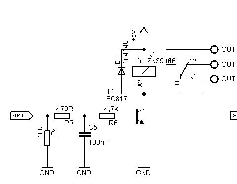

    Is a transistor necessary to control the SSR G3MB-202P from the ESP12E?
    So I would have to use something similar to this ?
  • #8 16140544
    dondu
    Posts: 13906
    Help: 1292
    Rate: 809
    Yes, except that R5, R4 and C5 can be omitted.

    The cognitive suck turned on and I would prefer to do something myself <br/span>:D after a lick of knowledge at the time of course.
    Then I would still ask for what purpose someone would use those resistors there? and what transistor would I use in mine?
