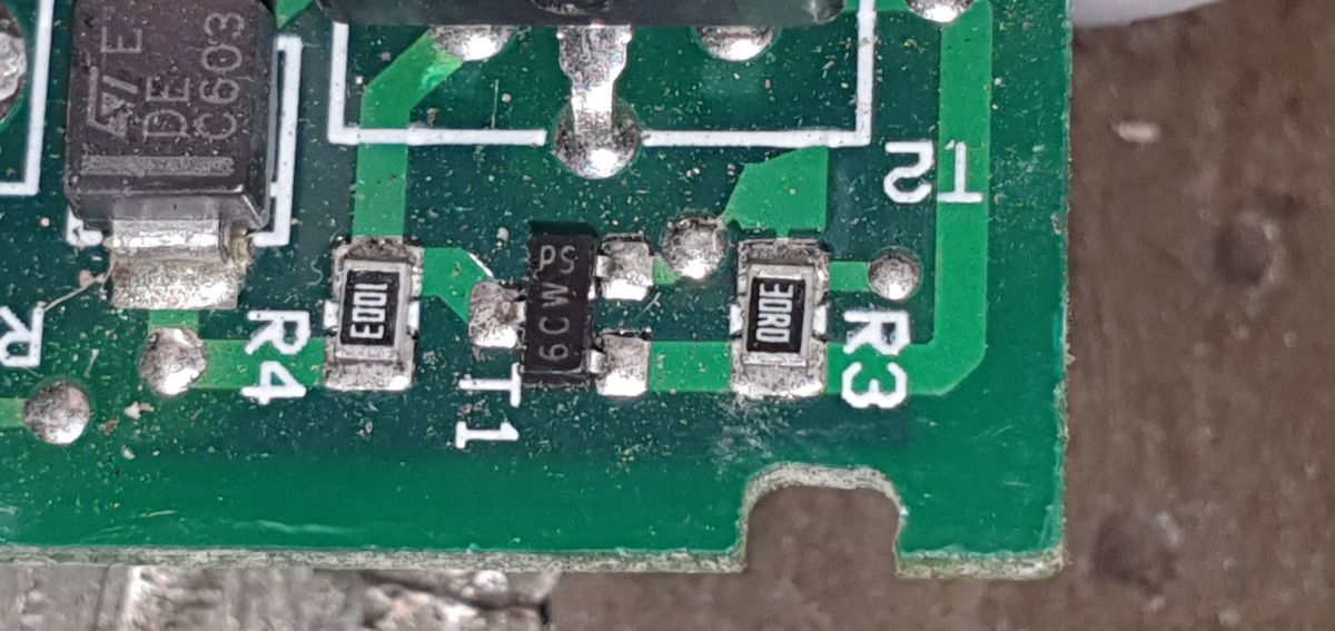

  • #41 20820054
    TomcioK
    Posts: 9
    >>19937305 .
    Hello everyone.
    I have a question. What is the component in the top left corner? C603. In the gate I have, it is damaged and signed as GP137. However, I cannot find it either. I would be very grateful for help.
    Close-up of a circuit board with a component labeled C603 in the top left corner.
  • #42 20822086
    chucu
    Posts: 148
    Help: 31
    Rate: 75
    Transil 6.8V, SM6T6V8A
  • #43 20822128
    TomcioK
    Posts: 9
    Thank you very much. I still have this question. I am just learning electronics, there are a lot of electronic components signed with some designation. Which cannot be found anywhere. And with the schematic is also a problem. From kond you know that it is Transil 6.8V, SM6T6V8A. This is years of practice or are there any books with the markings of this?

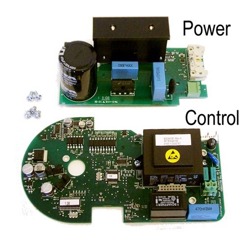

  • #47 21417794
    robertsjolin
    Does anyone know if this PCB is plug and play or it needs to be programmed?
    Two printed circuit boards labeled Power and Control.
  • #48 21417797
    doortech
    Posts: 25
    Rate: 9
    It must be programmed.
