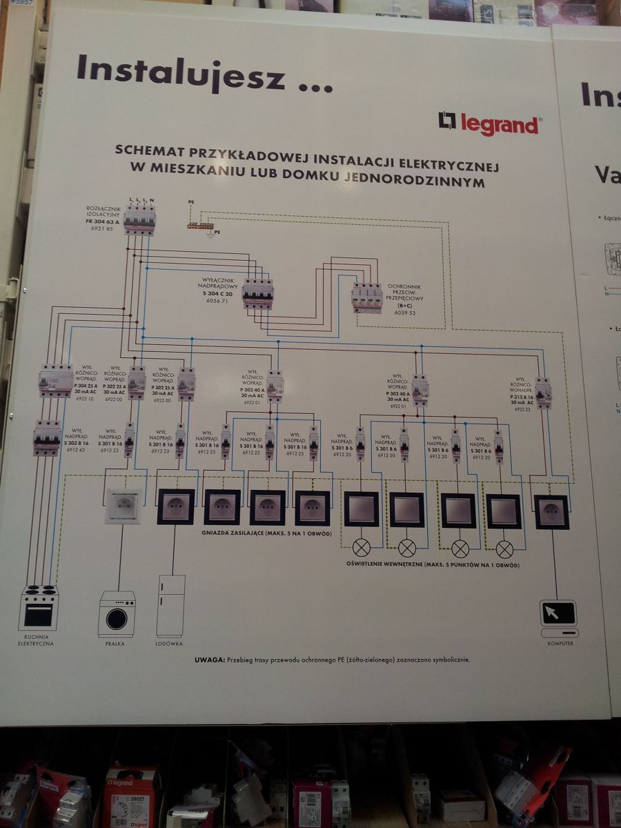

    This terminology blows me up. From the meter I have 5x16 led to the switching station, but the protective one is not connected to anything. In the switchgear, the blue one is introduced to the main disconnector, then it goes to 4 differentials. The AN coming from the differentials are separated into 4 separate buses that connect only those circuits protected by a given differential. And the PE rail is one and it is connected with all the evidence and the strip footing. I repeat once again that when I had the fifth protective one connected to the PE TO busbar the differentials did not work, because in the box with the meter the neutral is grounded.
  • Wiring is actually TT, not TN-CS
    #32 19039585
    kozi966
    Posts: 6922
    Help: 599
    Rate: 1288
    Leave those differentials alone, man.
    You write that you have a TN-CS chip, but in fact you made a TT chip.
    It results directly from this:
    slim24 wrote:
    but protective, not attached to anything.
    slim24 wrote:
    the blue one is introduced into the main switch
    You don't understand that in the TN-CS system, the PEN conductor should first go over the PE rail or the PEN rail. And this rail should also have a connection to the N rail.
    In this case, the disconnector means that you do not have a PEN conductor, you also do not have a PE conductor (because it is not connected), so you also do not have a metallic short-circuit loop.
    The surveyor is right.
    By the way, the operation of the differentials has nothing to do with it. They do not have to (although they can) operate from shorting the PE and N conductors and this is normal (!).

    Electrician With the meter is an employee at the guest who is authorized to perform measurements and issue reports. He was so oriented that he himself did not know that something was wrong. He just walked through all the nests in the house and wrote down the results in his notebook. I found out about the irregularities by phone from the electrician who sent the employee. I did the installation myself.
  • Bring the wiring to code before retesting earth resistance
    #34 19039607
    kkas12
    Posts: 17400
    Help: 1076
    Rate: 4312
    And this blue vein is broken by a disconnector. For what?
    And it is not N but PEN since the green and yellow wire is free.
    And whoever interrupts this mind, firstly, and secondly, since the green-yellow wire is hanging in the air, the guest has measured the ground impedance.
    This four-way WG should be deleted, replacing it with a three-way one, then the blue PEN conductor should be connected to the grounded PE bus, which should be connected to the N bus.
    And then repeat the SWZ measurement, starting from the PE rail in the table.
    This is buttery butter and I suggest not to deal with it, not to deal with it at this stage.
    First, you need to bring the connections to the standards-compliant state.

    Then I misunderstood it myself and thought it was TN-CS. I was building an installation based on this scheme.
    Homemade method of measuring earth resistance .
    I thought N had no right to meet PE in this switchboard anymore. I am supposed to understand it so that this bench grounds it sufficiently only I have it badly connected?

    This is a TN-S installation diagram, and incorrect. And you forgot about that PE. The PE in this drawing would start in your situation with a PEN wire that you did not connect properly.

    In a TN-C system (if you are actually dealing with it) there is no such thing as "sufficient grounding".
    The foundation earth electrode is an equalizing earth electrode and the resistance of such earth electrode is irrelevant for the protection against electric shock.
    If, however, you had a lightning protection system, then its grounding resistance should not exceed 10 ohms.
    If the division of PEN takes place in the junction, under no circumstances can PE and N join again in the table.
    However, such a division in the connector distant from the building does not make any sense and in unfavorable circumstances (loss of the continuity of the N wire) brings measurable financial losses, because in this case, 400V voltage may appear on the terminals of single-phase receivers, which will definitely lead to their damage.
    Today, energy suppliers even make it impossible to connect the fifth wire in the meter cabinet.
