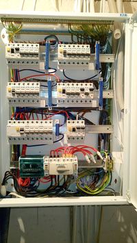

    I know that I'm about to be flooded with criticism about my inability to make a valuation.
    I sewed the client only the switchgear (it was mounted).
    I have selected the cameras according to the number of circuits, I figured, and the description of the switches will be using the yellow tape from the brother printer. I am still waiting for the limiters I ordered. The material is paid by the customer separately.
    And I have a slight pricing dilemma. Tell me if the price of PLN 600 is affordable for both parties?

    I think 480 PLN. it's a good price.
    By the way, I apologize for your comments right away. Where is the marking of the PEN conductor :?: its cross-section is also questionable, but it's not your fault.
    About this switch and connecting the aggregate to the network has already been sufficiently written in the thread of its selection, conclusions have not been drawn.

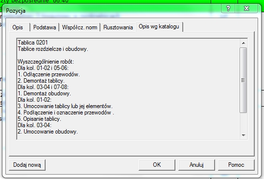

    kozi966 wrote:
    It is close to the price with KNNR (KNNR 9 0201-04) - replacement of housings with an area of more than 0.5 m2 - PLN 491.37.
    Where does your colleague see "housing replacement"?
    Because, according to KNNR 9 (0201-04), I see:

    elpapiotr wrote:
    KNNR 9 (0201-04)
    I opened a catalog of Bistyp unit prices, there is no list of works in the paper version.

    Besides, the area of this enclosure / board certainly does not exceed 0.5 m2.

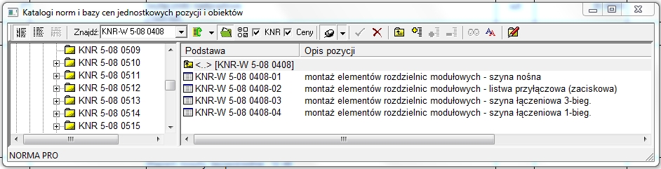

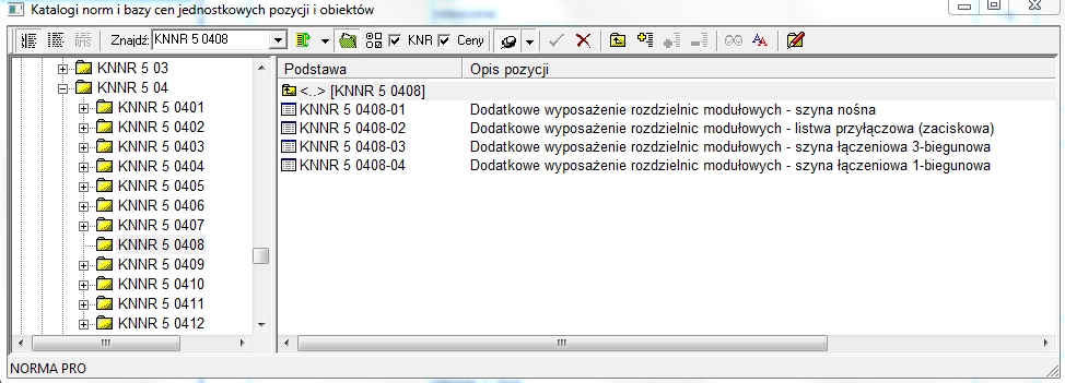

    Of course you can.
    Installation of Switchgear Valuation: Assessing Fair Pricing for Mounted Cameras & Limiters
    Previously, I gave only modular cameras, from the paper version. The next table from KNR 5-08 is No. 0408, and there we have rails, slats, etc.
    We add the following table:
    Finally, we insert the rg rate, and the client has no right to question the valuation.

    Buddy djlukas - here's a mistake:

    And the SVN129 controls do not require back-up?
