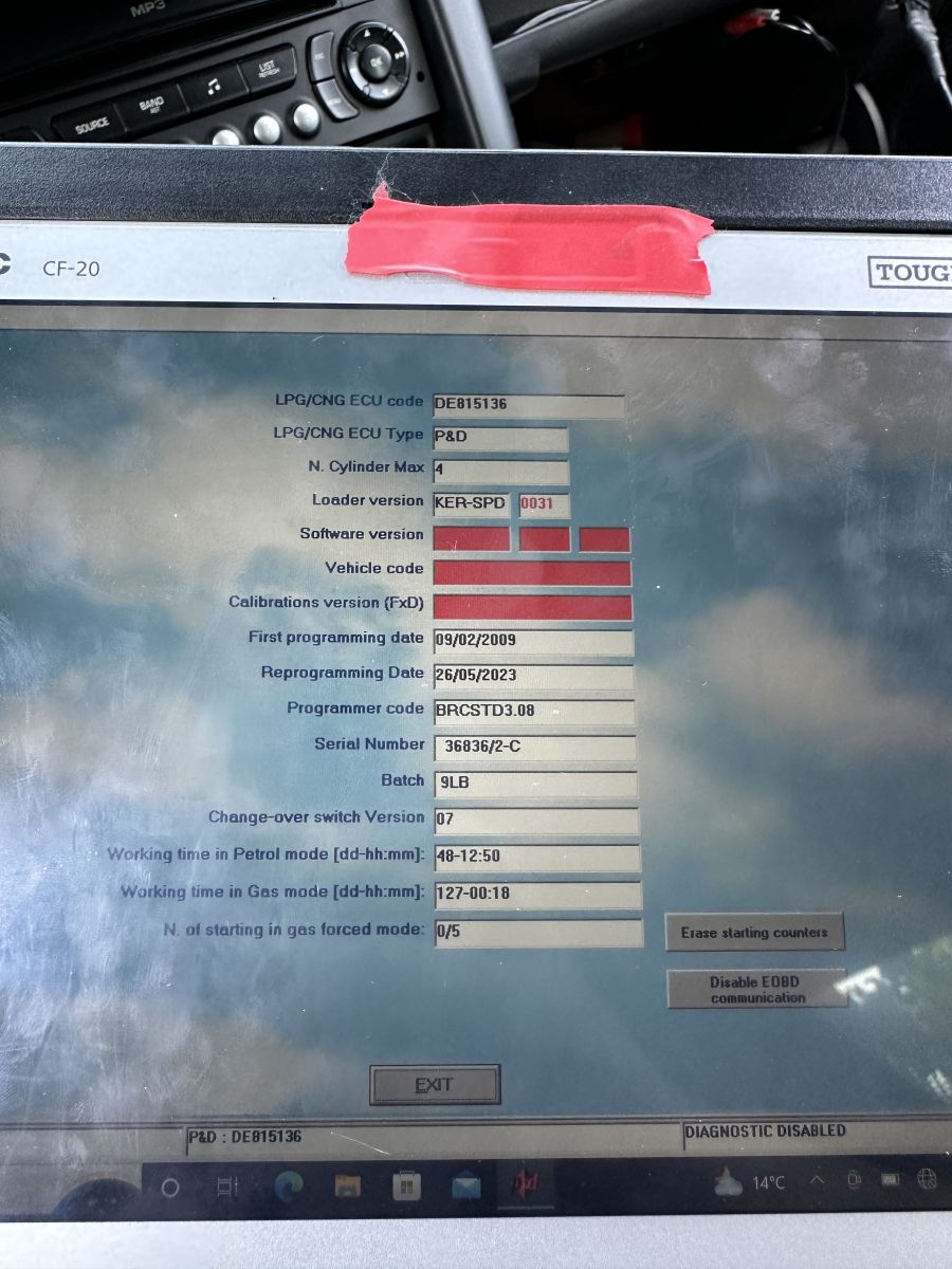

How can I access the BRC Sequent P&D settings when the software only shows the ECU version—is the wrong program being used or is the controller locked?
The controller may require BRC Calibration Tool rather than Sequent P&D/P&D Plus; for Sequent 32, the limited view was specifically attributed to using the wrong P&D program, not a lock [#17807806] Calibration Tool requires a license and is available through factories authorised by the BRC distributor in Poland [#16317165] [#17871615] Some factory-installed controllers are nevertheless locked, in which case the software cannot remove the restriction [#16315418] The reported remedy is a paid unlock service through Czakram in Tarnów, quoted as PLN 200 net plus forwarding; the controller’s DE81… code can be checked for a lock [#17163523]

    Paid service PLN 200 net + forwarding. Enter the driver code lpg DE81 ....... check if it is blocked.
    can you check please, if mine is factory locked too?
    Sequent P&D DE815141
    I have the same sympthoms. Unfortunately, mine was erased in local garage and they cannot program it back.
    Do you know if Czakram in Myslowice can unlock this? What is price for this service anyway now?
    Thank you

    Blocked. Unlock topic only in Tarnów.

    Please check the presence of the lock on the DE815033-2 driver.
  • #35 20596466
    dmxhabib
    Erased the ecu with p&d but can’t program now. Is this factory locked?
