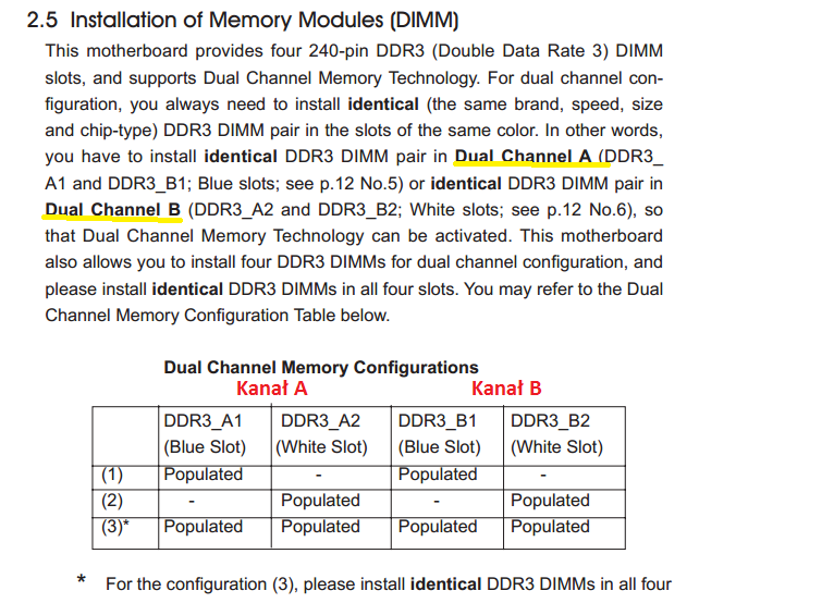

    Understanding Dual Channel Mode: RAM Memory Slot Colors & Configuration (A1, B1, A2, B2)
    You see him writing. The first to connect to channel A, put the dice in places A1 and B1 and the second is the same in channel B, put in places A2 and B2. And it's badly spelled because we don't put two memory dice in
    into one canal and one bone into two canals.
    It should be written to connect the first way dual channel should be inserted into sockets A1 and B1 and in the second way to sockets A2 and B2. Yes she washed it off.
    That's why I wanted to make sure what it was like here, that's why I asked a question.
    Now I know that in most discs the same bank colors correspond to two channels and that there are two banks for each channel. But it is known that all bank colors can be the same, and it is enough to describe A1, A2, B1, B2 or similar to distinguish which bank corresponds to a given channel.
    The end of the deliberation well lightened up.
    I have other questions.
    1. In most boards there are banks described in the following way: Channel A slots A1 and A2 channel B slots B1 and B2 and writes that the duals should be combined in: A1 with B1 and A2 with B2. Ok, that's what I write in the manual. And now I wonder if he writes this for the peace of mind for the drummer to make it easier for the fitter to insert the bone correctly without thinking how to insert it.
    Because if I put one dice per canal, but in a different configuration, eg A1 with B2 or B1 with A2, there is also one dice per canal.
    Does it have any meaning for the work of the computer or will I put in the A1 configuration with B1 / A2 with B2 or with the A1 configuration with B2 / B1 with A2 ??

    Well, that unfinished sentence was supposed to push you towards the controller. If you mount it as you wrote A1 from B2 it will be rather a single chanel. The controller has 2 channels and 4 banks. A one-sided and two-sided module is something else for the controller. It has a different physical structure and therefore it is different is addressing . As I wrote to you that you will not understand it, it is not because I wanted to bother you or something - it just makes no sense to try to understand it because at this stage you have to analyze a specific example (controller, BIOS board). This addressing is where the key is. Something on the border between hardware and software. You have time and willingness to read it - I never wanted to think about it. After all, I will not design the motherboard anyway.
    BTW, if I will clean the PC, I will check out of curiosity how the PC with A1 B2 memories will work so as to be sure :D

    Well, I will also not design the albums and I do not have to think about it as it is physically and softly solved, because it may even be a secret of the manufacturer. I am only interested in the information that the assembler has when assembling the computer. I am not green in computers because I have assembled a lot of boxes but I never paid attention to it and it always worked. Now it interested me, but unfortunately I do not fold the boxes anymore because it is the age of laptops and I also got rid of the boxes from home, so I have no way to check it.
    And why should there be a single, if there is one bone in two channels and the data will be two channels, whether you like it or not. If there were already a single, one of the dice should not be seen and only one would work. This is how it seems logically. I would like to check it too, but all of me have laptops.
    And when it comes to single-sided and double-sided dice, it needs the information that the computer fitter needs. If it happened that I would fold a computer one day, I will not order a memory bag to try different configurations only as much as I need and I would like to know whether to take two-sided or one-sided, and do not refer me to the CD manual because I have already looked at a few manuals and nothing it writes about whether it is two-sided or one-sided.

    golec2604 wrote:
    It always worked.
    It doesn't always have to.
The discussion revolves around the understanding of dual channel memory configuration in motherboards with four slots, typically color-coded (e.g., red and yellow). The main inquiry is whether two slots of different colors represent separate channels, and if dual channel operation requires identical memory modules to be installed in corresponding slots. Participants clarify that dual channel architecture allows for increased memory bandwidth by utilizing two 64-bit channels, effectively creating a 128-bit data bus. The configuration can vary based on motherboard design and memory controller capabilities, with some boards allowing for mixed memory configurations. The consensus is that to achieve dual channel operation, at least two identical RAM modules must be installed, one in each channel, typically in slots of the same color as indicated in the motherboard manual.
TL;DR: A matched dual-channel kit can deliver up to 30 % more memory bandwidth [TechPowerUp, 2021]; "always follow the manual" advises 310artur [Elektroda, 310artur, post #16245927] Check the board guide, place one DIMM per channel, and verify in BIOS.
Why it matters: Correct slot pairing unlocks 128-bit throughput instead of 64-bit single-channel speed.
• Bus width: dual = 128-bit, single = 64-bit [Wikipedia, Dual-channel]. • Minimum hardware: 2 identical DIMMs, one per channel [Elektroda, Kasek21, post #16246059] • Real-world gain: 15–30 % in memory-bound apps [TechSpot, 2022]. • Flex/Pseudo dual: mixed sizes run part dual, part single [Intel, Flex Mode]. • Odd DIMM counts can prevent POST on some boards [Elektroda, 310artur, post #16245762]
1. What do the coloured RAM slots (A1, B1, A2, B2) actually mean?
Colours group sockets that share a channel pair. A1 and B1 are one preferred dual-channel pair; A2 and B2 are the other. Labels, not colours, are authoritative because many boards ship all-black sockets [Elektroda, golec2604, post #16246035]
2. Do I always put identical modules into same-colour slots?
Yes. Install matched DIMMs into the two slots with identical colour or label (e.g., A2+B2). That places one DIMM per controller channel and enables the 128-bit bus [Wikipedia, Dual-channel].
3. Can I mix sizes or brands and still get dual channel?
If sizes differ, many Intel/AMD chipsets enter “Flex Mode”: matched portions run dual, the rest single [Intel, Flex Mode]. Mixing brands works when timings and voltage match, but failure risk rises [Elektroda, golec2604, post #16248376]
4. What happens if I install three DIMMs?
Possible outcomes: PC fails POST, runs all three in single channel, or runs 2 + 1 (dual + single) depending on controller design [Elektroda, 310artur, post #16245762]
5. Single-sided vs double-sided RAM: does it matter?
Controllers treat each rank (side) separately. Some older boards allow only one rank per channel, so two-sided DIMMs block the second slot. Modern boards rarely limit you [Crucial, Rank FAQ].
6. How do I verify dual channel is active in Windows or Linux?
  1. Install RAM.
  2. Boot and run CPU-Z (Windows) or dmidecode -t memory (Linux).
  3. Check “Channels #” — it should read “Dual”. This 3-step check takes under one minute [CPU-Z Guide].
7. Why does my board recommend A2+B2 first, not A1+B1?
Outer sockets (A2/B2) sit farther from the CPU, giving shorter trace length difference and cleaner signalling at high DDR speeds, so vendors prioritise them [ASUS, 2023 Manual].
8. Will dual channel improve gaming FPS?
Average uplift is 5–12 % in GPU-bound titles, but up to 25 % in integrated-graphics systems [TechPowerUp, 2021].
9. What is “Flex/Pseudo dual channel” mode?
Chipset maps equal-sized regions of mismatched DIMMs to dual channel; the surplus runs single channel. Example: 4 GB + 8 GB gives 4 GB dual + 4 GB single [Intel, Flex Mode].
10. Edge case: My PC won’t boot after adding RAM—why?
Mixed voltage, unsupported rank count, or wrong slot order can halt POST. Removing the new DIMM or resetting BIOS usually restores operation [Elektroda, 310artur, post #16245762]
11. How-To: Install RAM for dual channel in 3 steps
  1. Read the motherboard manual page labelled “Memory Configuration.”
  2. Insert identical DIMMs into the two recommended slots (often A2+B2).
  3. Power on and confirm “Dual” in BIOS/CPU-Z. Total time: ≈5 minutes [Elektroda, sylweksylwina, post #16246135]
