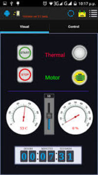

    Hello everyone.
    Connecting Virtuino to ESP8622 from Different Router: Experiences and Suggestions
    I started using Virtuino to control devices via ESP and got stuck on internet communication from another router i.e.
    ESP is connected to the router at home and I am trying to connect Virtuino, for example at a friend's and unfortunately I fail.
    There is not much about Virtuino because this application has recently appeared, but for me it is great and, importantly, FREE.
    You can tell us how to deal with this problem.

    Any IP address has this device assigned? There are two options, set up a VPN at home or find out what port in the router you need to redirect and to which IP address

    The address is assigned for ESP 192.168.100.110 port 8000
    However, in Virtuino I enter the same IP address and port. - works at home

    And there is another way out - the router is managed by the ISP and it won't give me access to the router.

    Read the contract and, depending on what you have in it, ask / request appropriate settings.
