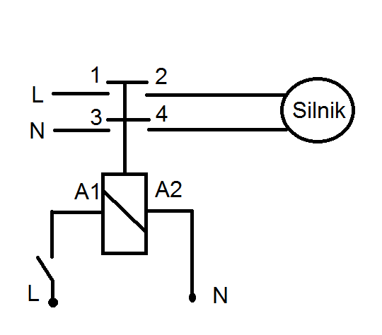

    Hello I have a small problem the fire controller at the central heating cooker has the ability to connect a pump with a maximum power of 100W and I need a pump with a power of 700W in the shop they said that you can connect the pump through a contactor. I bought a Schneider ICT 25A contactor but the professionals don't see how to connect it has inputs 1,3,2,4 and A1 and A2 . Can someone draw a wiring diagram for this contactor. Thank you.

    The colleague is aware that he is interfering with the system to some extent? How do I connect the 700W CH pump via the Schneider ICT 25A contactor to the Ognik controller? .
    The diagram I am enclosing is only an illustrative diagram and requires the selection of appropriate protection for the motor. Which motor is to be used single phase or three phase? The contactor is designed for a single-phase system.

    So we connect the wire from the controller to terminals A1,A2 and the pump to terminals 1,3

    Supply 1.3 or 2.4 depending on how it suits you in your connections.

    That is, the wire from the controller under terminals A1 and A2 and the pump under 1.3

    A colleague put it very well.
  • Contactor wiring requires coil voltage and fused power

    I bought a Schneider ICT 25A contactor but the professionals can't see how to connect it
    I suggest you change the professionals. I understand that the contactor coil is for the correct voltage, yes?
    After all, the contactor contacts still need to be powered, not to mention the fuse.
