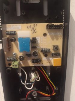

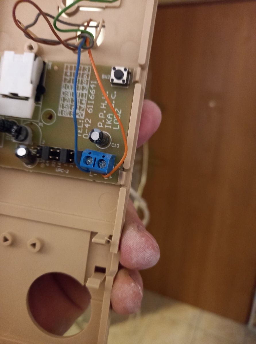

    Hello, maybe I can fix something, I have the same problem with the intercom. Old as in photo 1 changed to Smart digital as in photo 2 at the bottom in front of the staircase is CD-2502 apartment number 42 and why the jumpers in photo 1 in the old intercom are set like this I have no idea, I've tried everything setting the number 42 setting it as in the old one and nothing happens only when I hold the handset to my ear and press the bolczyk that hangs up the handset I hear a single knock/click, but it is also sometimes hollow. The code for opening works normally.

    Check the voltage on the line and if it is, use a uniphone dedicated to this system, not some substitute

    filipwyderkiewicz wrote:
    will this one be ok?
    Yes

    I bought the lm8/w6 laskomex as I sent above. Everything works - opening the call, answering. You can hear the sound of using the code, but you can hear the person calling the apartment downstairs very quietly. It's fine and nothing can be understood in the linden house. You have to shout under the cage.

    it's terribly quiet you can hear the person calling the apartment downstairs it's fine and in the linden house nothing can be understood you have to shout under the staircase
    Report this problem to the administration / cooperative / manager, because you will not be able to do anything about it yourself.

    Yes, it looks like a line adjustment problem - it's possible that it's also a problem with mixed uniphones (different versions, models, manufacturers, etc.) - hell for installers in terms of volume control - it may even be simply impossible to adjust it so so that somewhere "not beeping" or "not too quiet".
