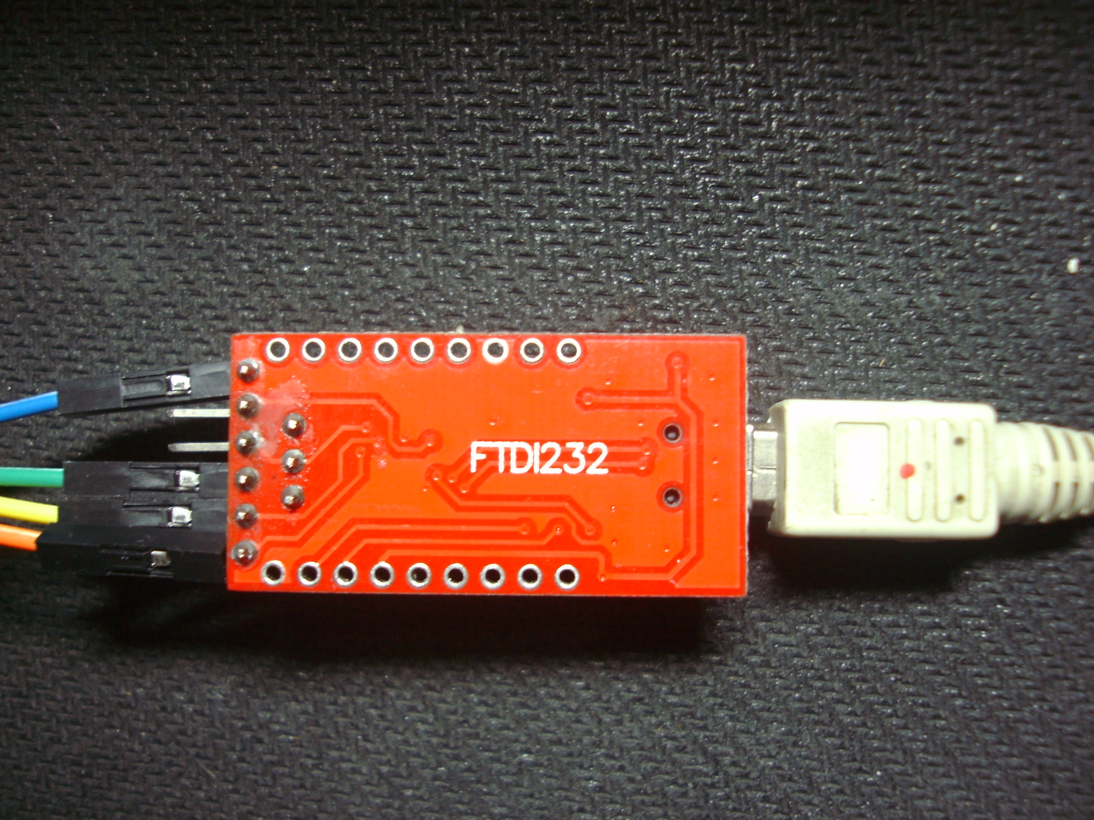

  • Hello.
    Before buying, it is worth checking what version we are dealing with.
    The point is whether the version is original or not. If we have non-original versions, after the update you will see the message: This board is Fake!
    This applies to the version with the serial number shown in the picture.
    Fortunately, there is an update that eliminates this problem. In the file
    DSO150 Modification of software and hardware.zip is an appropriate hex
    I attach instructions on how to and how to do it. Description in PDF
    There is a description of the modification in the file but I did not do it for those moments.
     Watch out for pads and power supply socket because it is very delicate.
    On FTDI232 It should be switched to 3.3V !!!!!!!!!!!!!!!!!!!!!

    • DSO150 Modification of software and hardware.zip (1.77 MB) You must be logged in to download this attachment.
    • DSO150_HowToUpgradeFirmware.pdf (1.64 MB) You must be logged in to download this attachment.
