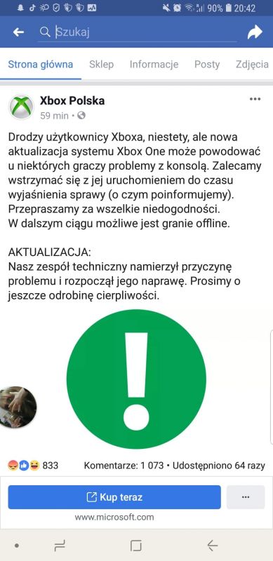

Most likely the console failed during a silent update or after a power/write interruption, which can corrupt the boot/cache state and leave it hanging on the green logo screen [#16989685] First, let the console freeze, unplug the power cord for about 30 seconds, and try a cold restart [#16989685] If that does not help, perform an offline system update from a USB flash drive and use safe mode: prepare a USB drive of at least 4 GB formatted as NTFS, copy the $SystemUpdate folder to the root, turn the console fully off, then hold BIND + EJECT while pressing the Xbox button until you hear two power tones [#16990427] If you are on a wired network, disconnect the network cable before doing this; Wi‑Fi does not matter until the system is loaded [#16990427][#16990489] If the update still fails, try the OSU2 package first and then OSU1 [#16990427]

    It doesn't work for me either. It turns out that Microsoft has made an update and just after connecting to the Internet, the console stops responding. Try to disconnect the console from the Internet, it will work again.

  • #36 17743347
    darkowski001
    It already works online ?
  • #37 17743366
    otaru
    Posts: 11
    ok it's working now
  • #38 17750682
    habinka
    Posts: 192
