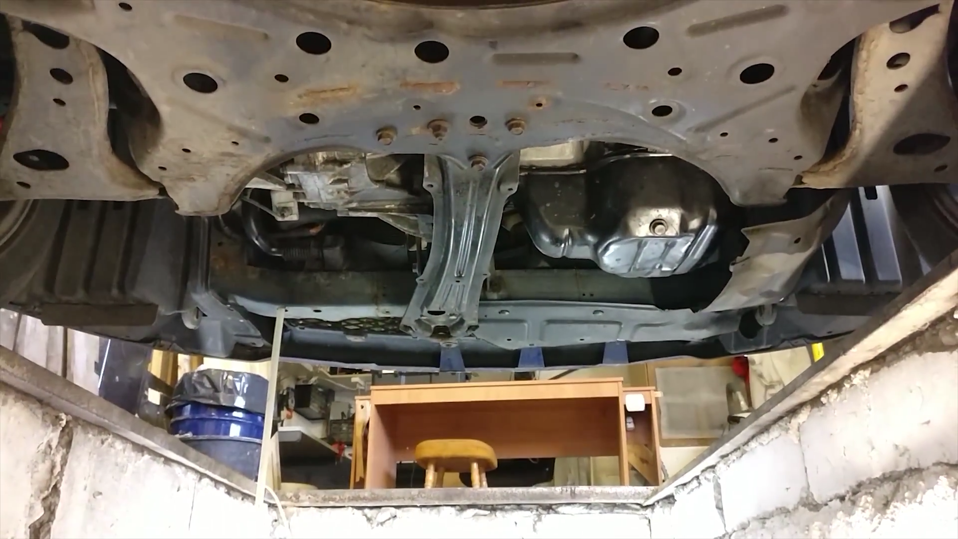

    Hello. On the way back from a long journey, after checking the oil level in the engine, it turned out that there was too little oil, so I refilled it.
    I checked on the second day, it turned out that I poured too much and it is about 3 mm above the max. I tried to get rid of the excess oil with a hose and a syringe, I pulled it out a little, but it can't be done anymore. So I figured the best way would be to loosen the drain plug and drain the oil. The problem is that I can't do much, only what I can do is in the parking lot. Would it be a good idea to jack the car up, unscrew the wheel and get to the screw (drain plug)?

    I see. Ideally, I would like to get rid of the oil after unscrewing the drain plug, but will it get to it after lifting the car on the jack and unscrewing the wheel

    Are you sure the drain plug is there?
    If the oil is drained by unscrewing the filter, it will not be easy on the jack.

    Yes. There is a drain plug

    It is possible that I sucked a little oil because I had a tube of about 50 cm, is it the length you need?

    Compare with the marks on the dipstick.

    Rate: 21
    I do not recommend because there were those who lost their lives in this way. For example, despite the fact that I do not have a channel, I drained the coolant in such a way that I drove to what edge so that the wheels were on the top and I could easily get to it from the bottom. only if you unscrew the cork, you can drain too much. these 3 mm should not hurt.

    Hello. I sucked the oil out of the syringe
