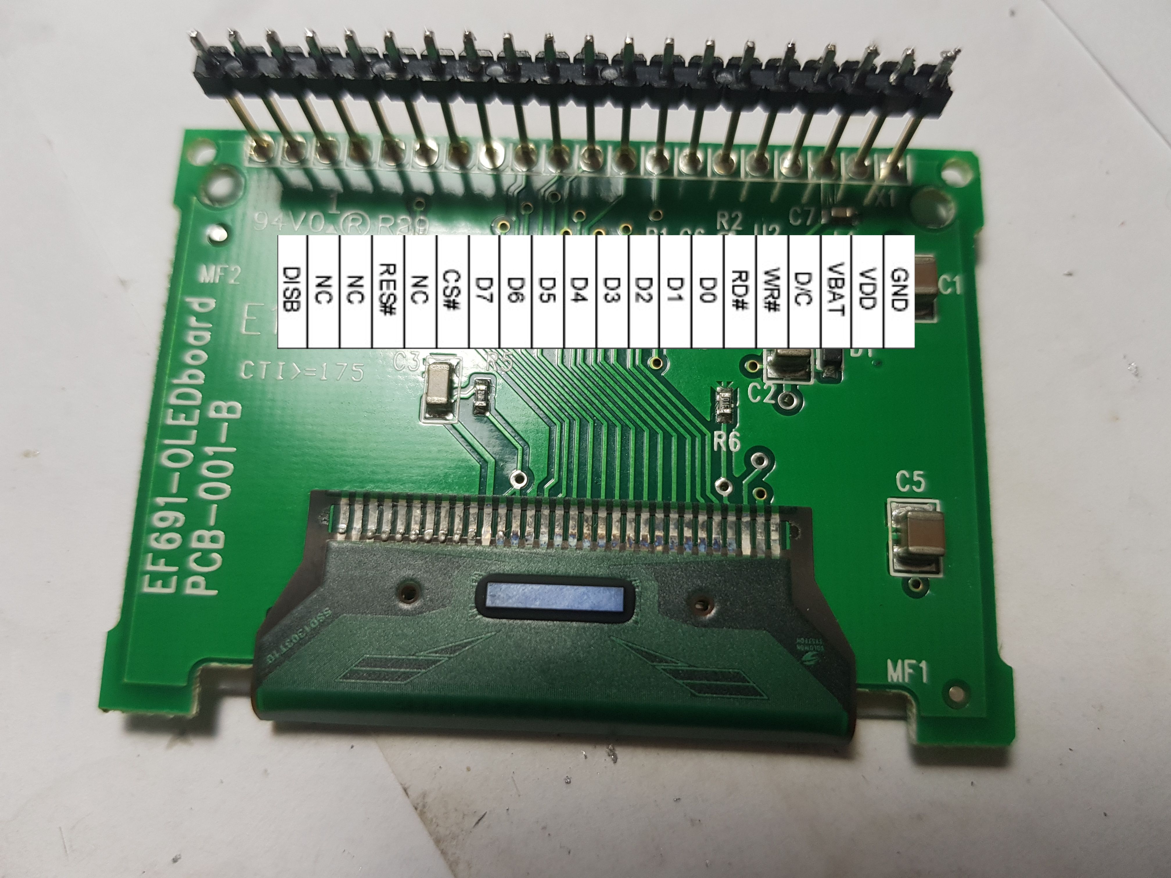

    satanistik wrote:
    If you confirm that sdp0301 will work, I can try to make a plate.

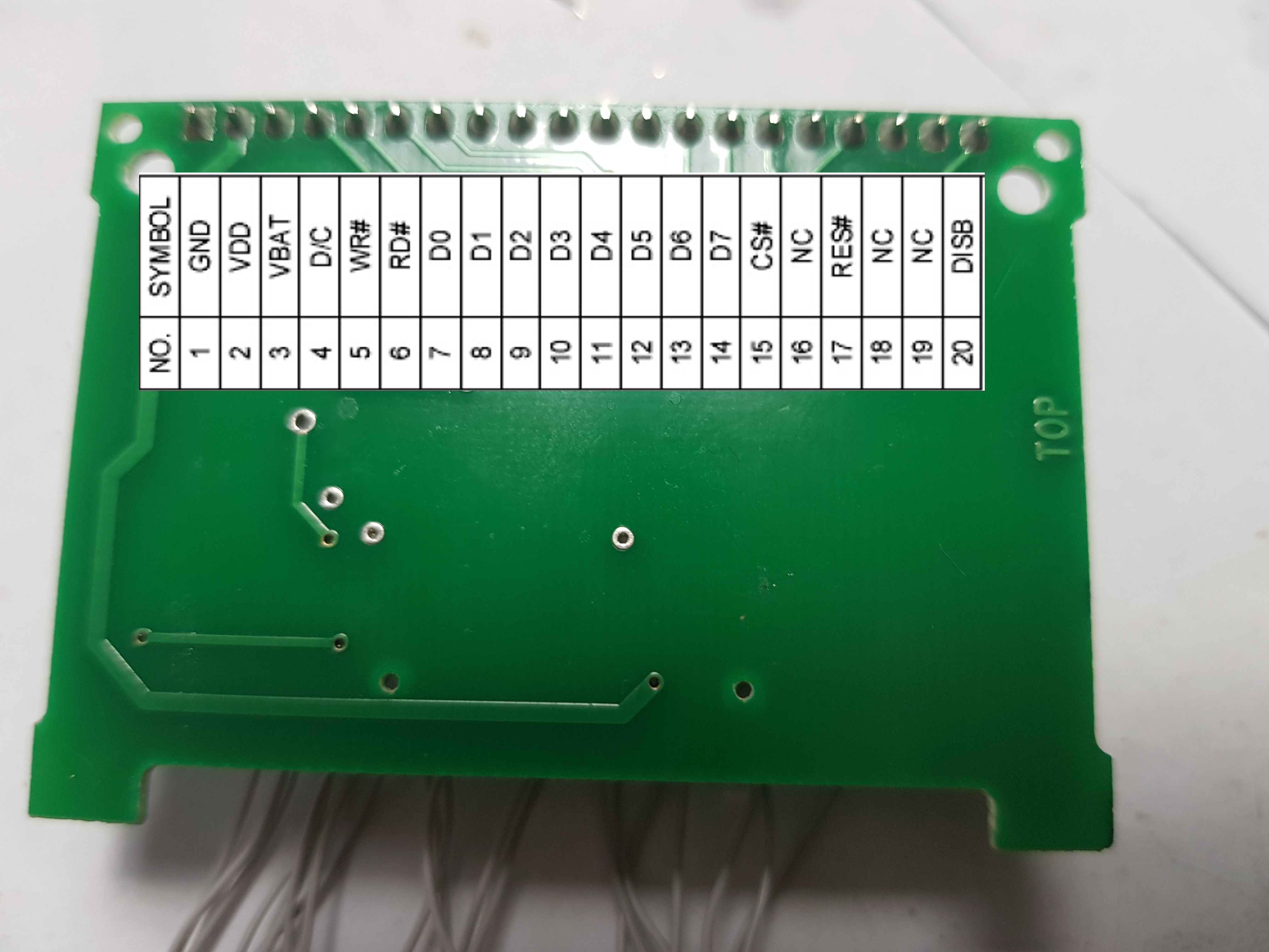

    Ok. Plate with your layouts prepared. I am still waiting for the FFC-24 adapter for pins. If I get, I'll put together and let me know. NIVONA Caferomatica 830 Coffee Machine: Damaged Display Repair, AliExpress Replacement

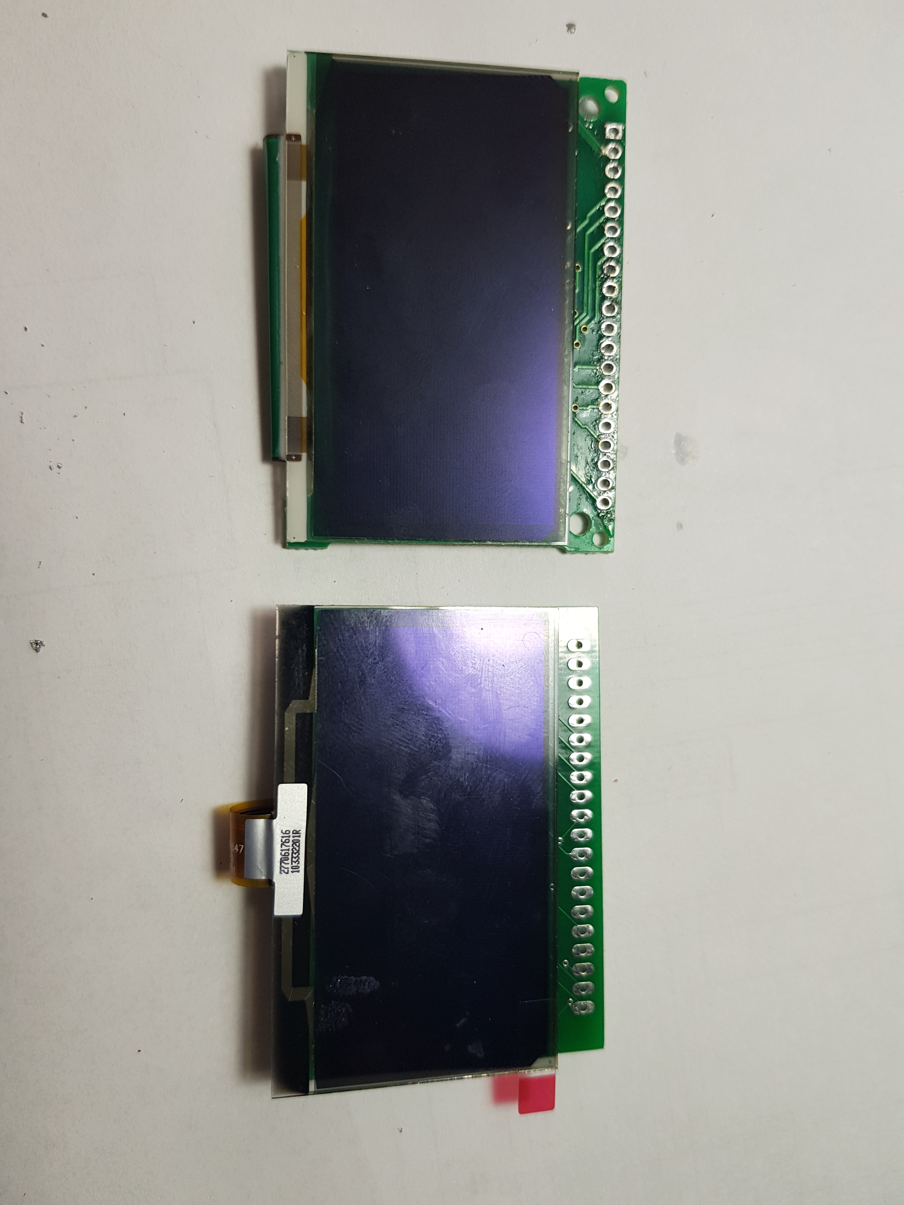

    satanistik wrote:
    Everything has to be done, but it will be a double-sided tile.

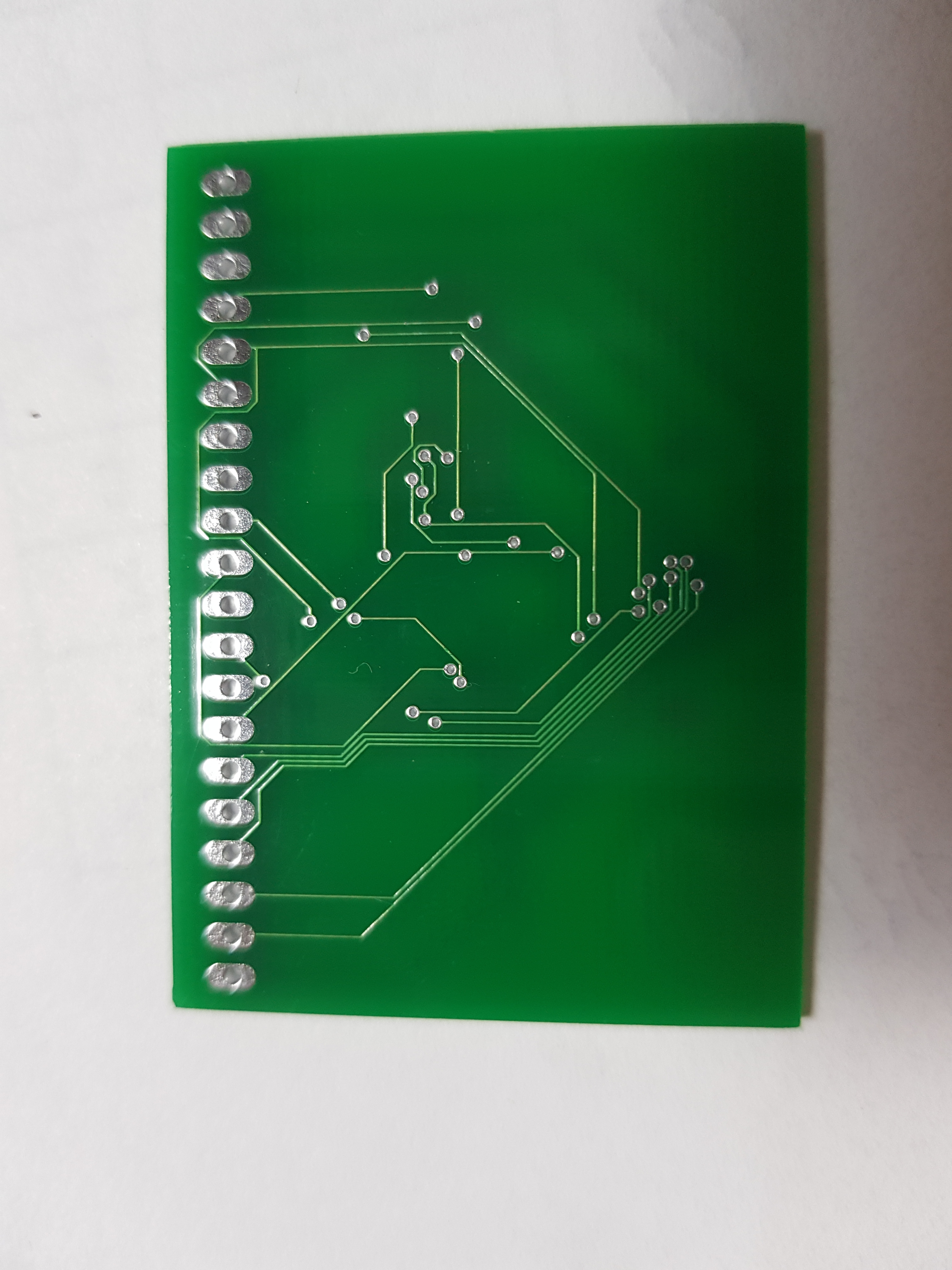

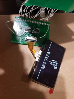

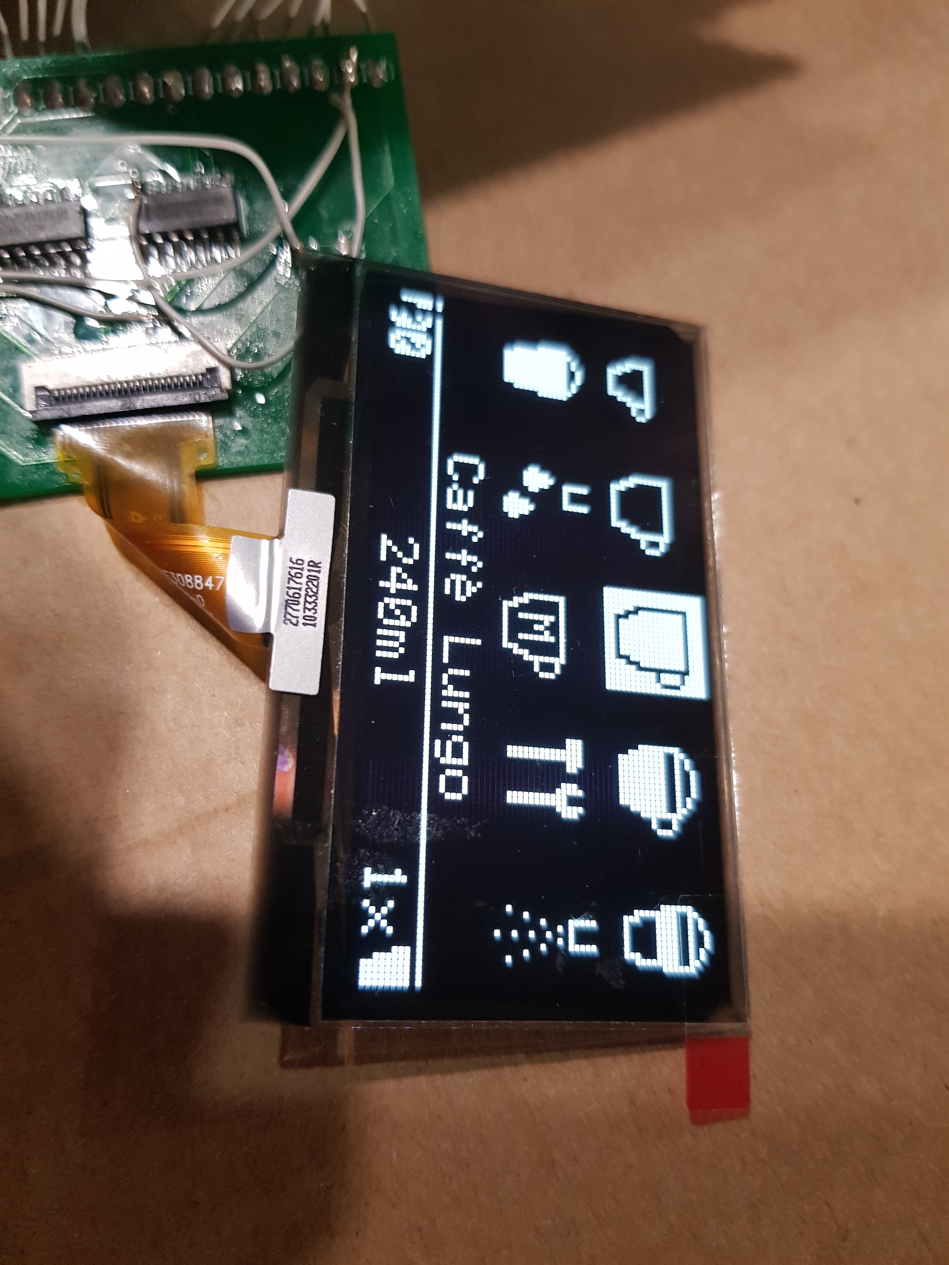

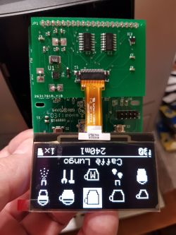

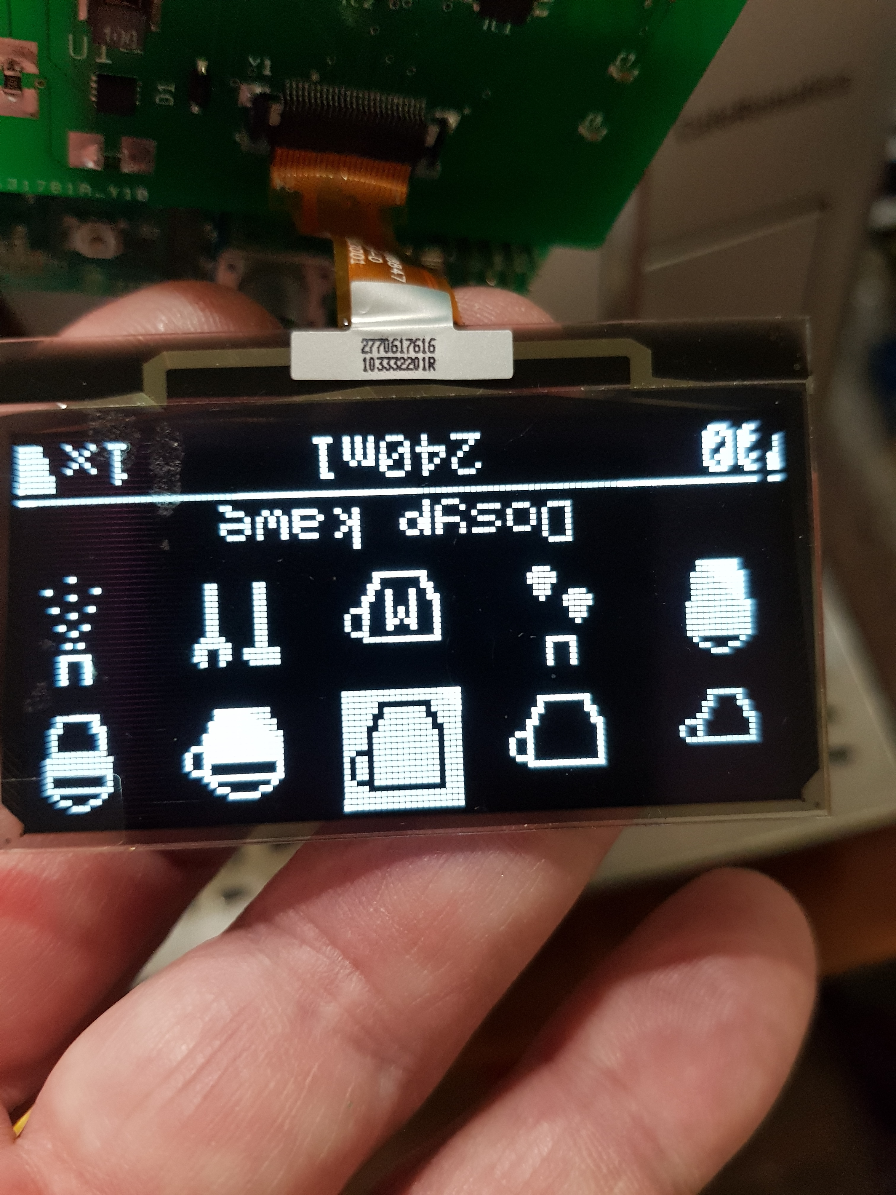

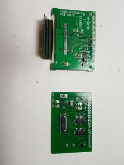

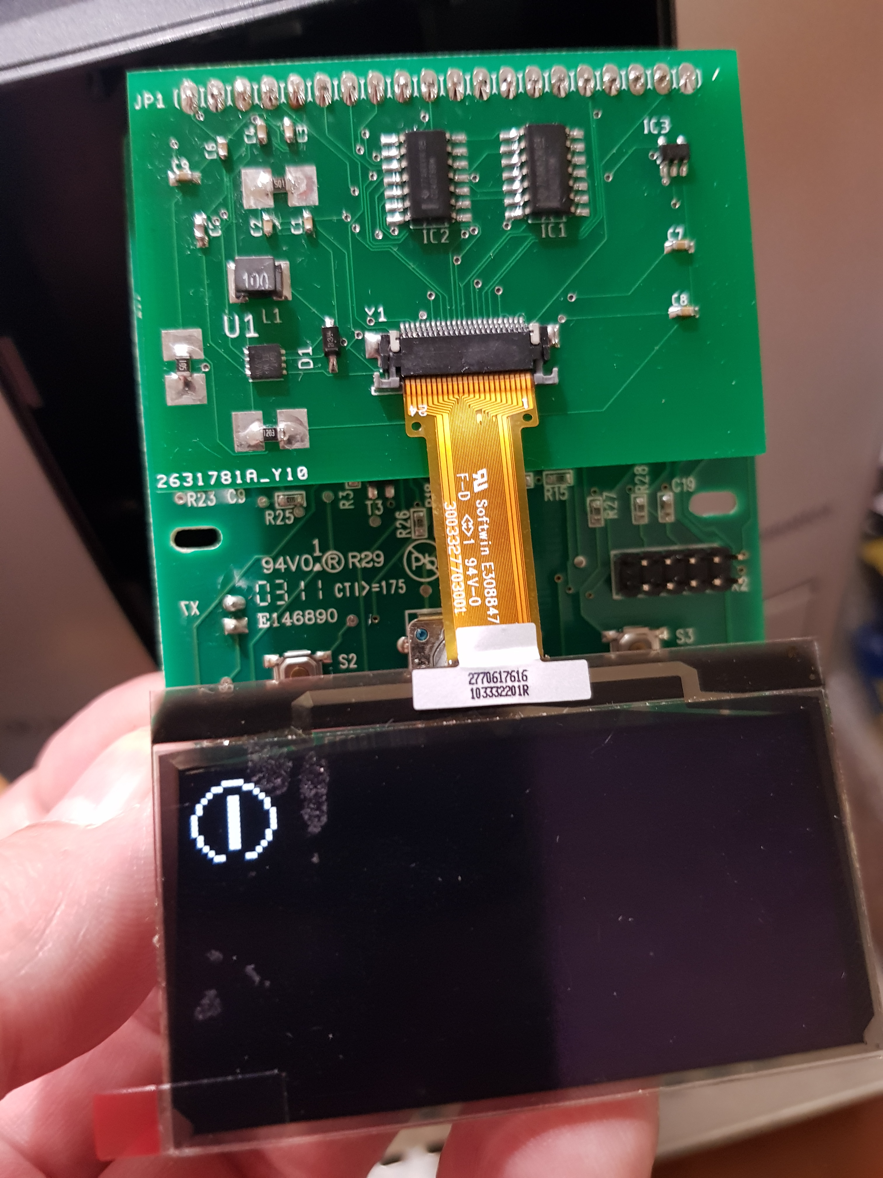

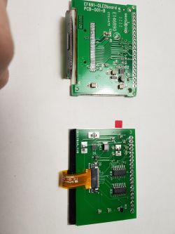

    In the end, I got my parts. The sdp0301 display can be connected, but in fact the image is inverted. The circuit made by Satanistika works.
    Display module connected to a green PCB with wires. NIVONA Caferomatica 830 Coffee Machine: Damaged Display Repair, AliExpress Replacement NIVONA Caferomatica 830 Coffee Machine: Damaged Display Repair, AliExpress Replacement
    It's a pity there's no way to put it into 132x64 mode, but the lack of lines doesn't bother you too much.

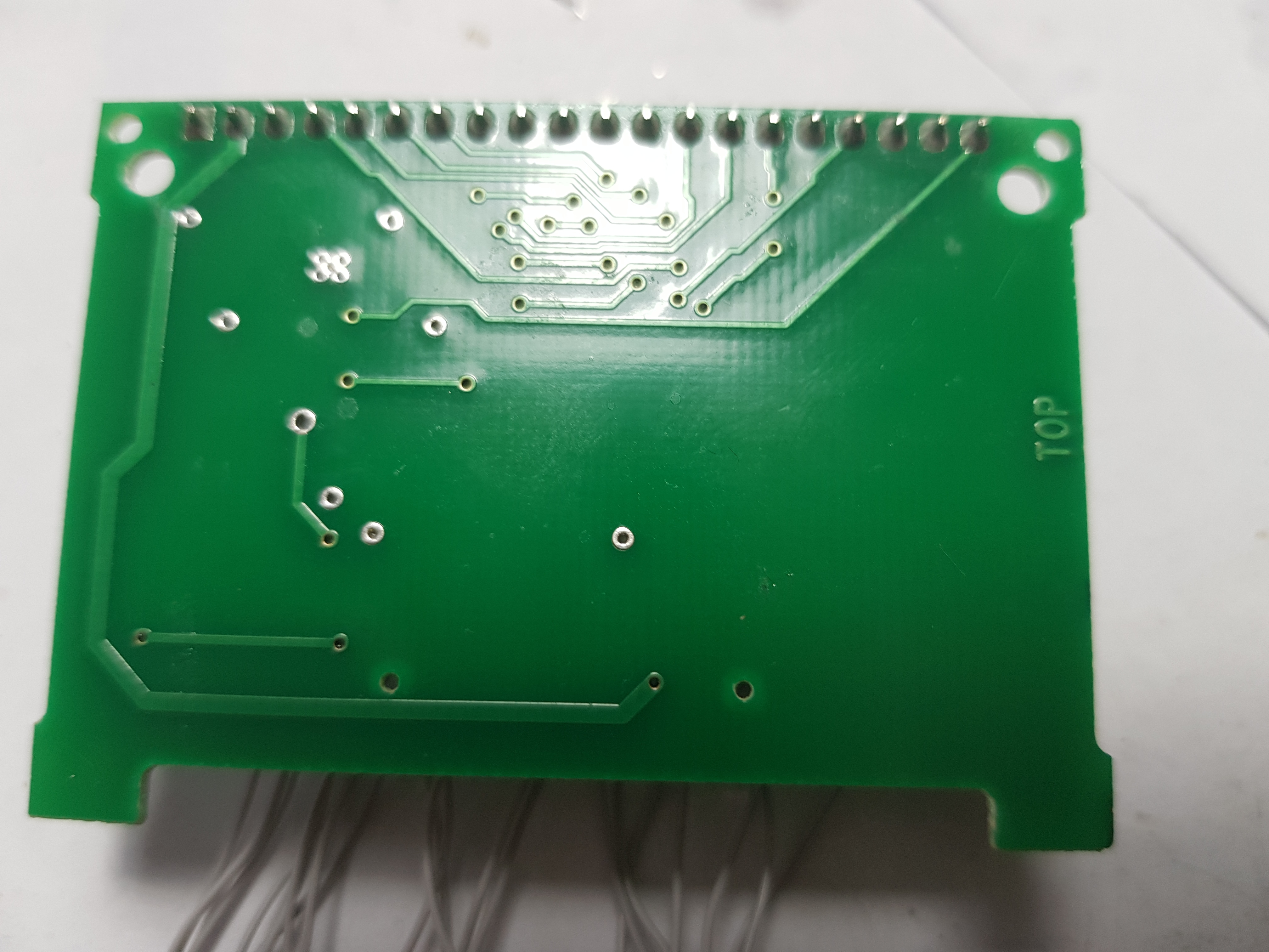

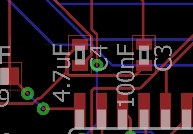

    I made PCBs, but unfortunately I gave the voltage for the systems from VCC instead of VDD and I had 13V instead of 3.3V: / I had to modify the PCB a bit :( I need to correct this in the schematic.
    Tiles ordered from China, but done very nicely
    NIVONA Caferomatica 830 Coffee Machine: Damaged Display Repair, AliExpress Replacement NIVONA Caferomatica 830 Coffee Machine: Damaged Display Repair, AliExpress Replacement NIVONA Caferomatica 830 Coffee Machine: Damaged Display Repair, AliExpress Replacement
    Generally, if you add a converter to the VCC to the diagram, the board can be modified so that it will be replaceable with the current one, because only VCC is missing from the 20-pin link. Then the problem of how to connect to the connector of the old display would be solved.
    After all these combinations, with higher voltage treatment, the display started to behave like this https://www.youtube.com/watch?v=9Ji3bN0IqFo. I think I tired it a bit or it's the soldering effect on the spider ;)

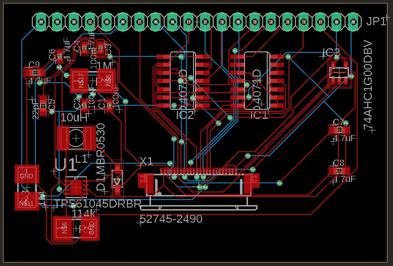

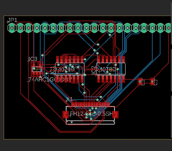

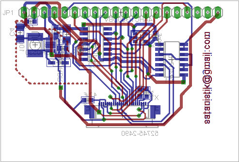

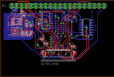

    When designing a tile with such a large amount of space, try to move away the guides from the paths, the paths themselves are worth doing as short as possible. Ogulnie I'm glad that it works.
  • #129 17953204
    amigos
    Posts: 309
    Rate: 131
    Thank you for valuable tips. It's my beginnings with Eagle and tile design, so I'm basing on his autoroute. Now I made a diagram with a converter and adapted to a 20-pin connector. I probably mistake something again, but we'll see how tiles come. On it I just mixed up with the lengths of paths and guides :D I enclose the diagram. If you had a moment, maybe you will look and check. If you catch a mistake, let me know. Probably it is not perfectly ordered but it is done so quickly. The most annoying, however, is this lack of vertical lines. Atmel blocked before reading so from the software side nothing will happen. Spd0301 provides 132x64 mode, but for the disease I do not know if it is possible to force him to use this mode in hardware. ssd1303t10 had 132x64 by default and only the ability to force 128x64, and sdp0301 unlike: / I see that you have a lot of idea, so if you do not come up with anything, nobody will. Thank you for your contribution to this topic so far. Without your scheme, nothing would move, and now there is some hope for a solution ;) There are new modules for this Nivon. If someone had one in their hands, they could check on what display they are built because I doubt that it would be an old ssd1303t10. Maybe some photos? :D Greetings!

    Attach eagle files to glance, because if you have a long circuit inverter on the whole board, it may be poor.
  • #133 17954054
    amigos
    Posts: 309
    Rate: 131
    You have attached. Eagle 9.4.0. I made 2 tile designs with different ffc. We'll see what comes out ;) I will have plates for about 2-3 weeks. If you feel like it, you can use it calmly. I do not reserve copyright :D I reserve, however, that it has not been checked. They do not have to act and I am not responsible for any damage ;) Maybe someone will modify it so that it has hands and feet ;)

    I slightly improved the board but I did not check the correctness of the scheme 100%. NIVONA Caferomatica 830 Coffee Machine: Damaged Display Repair, AliExpress Replacement and even a simple version to be made using the thermo-transfer method: NIVONA Caferomatica 830 Coffee Machine: Damaged Display Repair, AliExpress Replacement

    The power paths should be run as thick and short as possible, the filtering capacitors 100n distant from the systems no longer have their function, they can not be soldered. The inverter can not be a tangle of wires - the generated interference can interfere with digital signals and cause unstable operation. In addition, the same use of the machine can be improved by setting the elements: NIVONA Caferomatica 830 Coffee Machine: Damaged Display Repair, AliExpress Replacement It was enough here to rotate condensation. As for the placement of elements - since my monster with 2 plates of cables and glue could fit there and so 5mm of clearance was left, I do not see a problem. The board is not a matter of a clear appearance - long paths act like capacitors and coils, and here the display works on Mhz - there may be effects in the form of random disturbances, flickering or in the extreme case of crashing of the processor.
  • #137 17954722
    amigos
    Posts: 309
    Rate: 131
    Ok. The thickness of paths may actually increase a bit. I sent tiles to do. We'll see at the ready if it works ;) The tiles are ready, but this time I did not take a courier, so I will wait 3 weeks: / Unless I think of another project until the evening, I will do it and change it into a courier. Then they will be at the end of next week :)

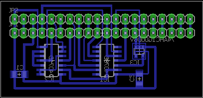

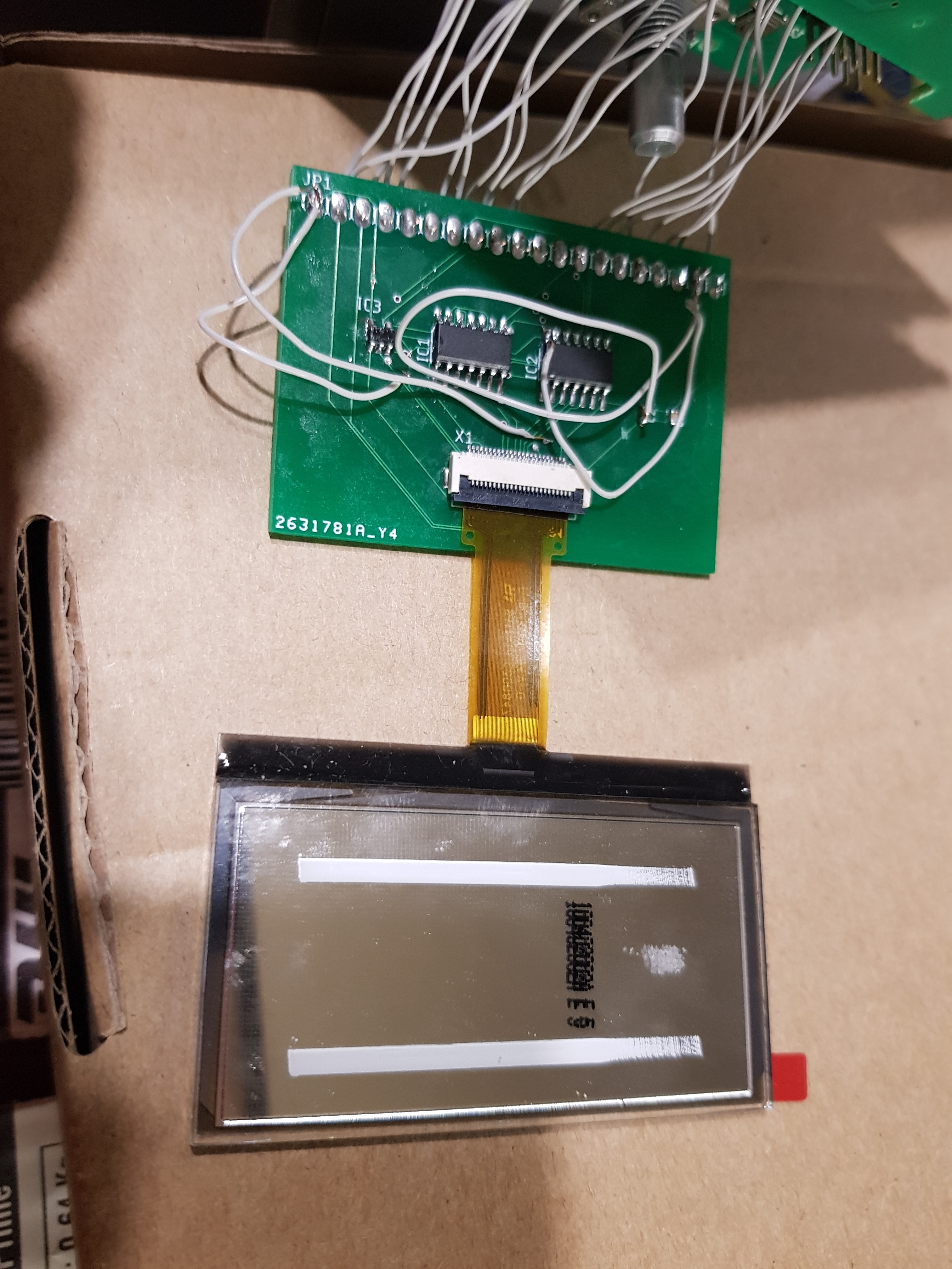

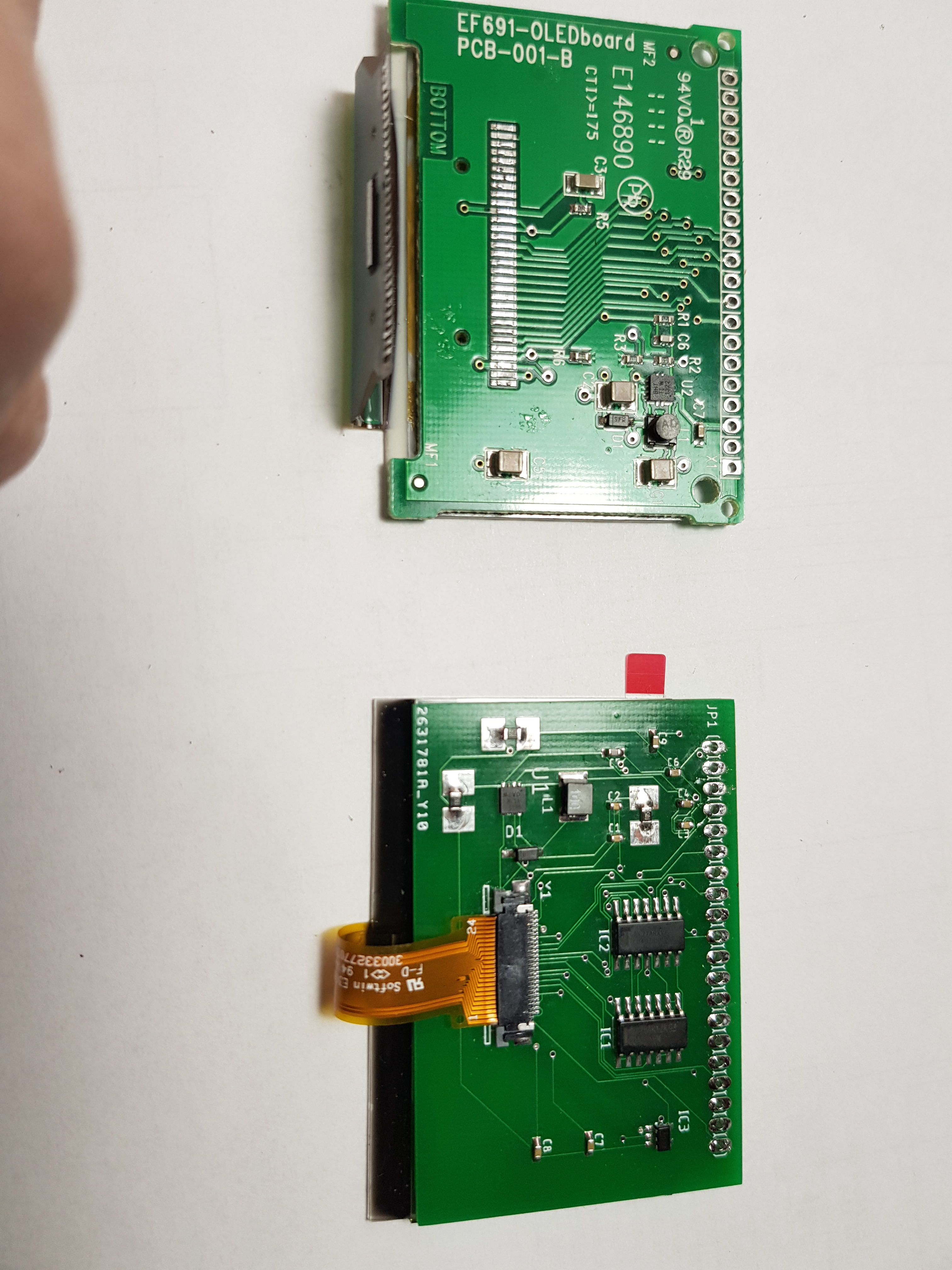

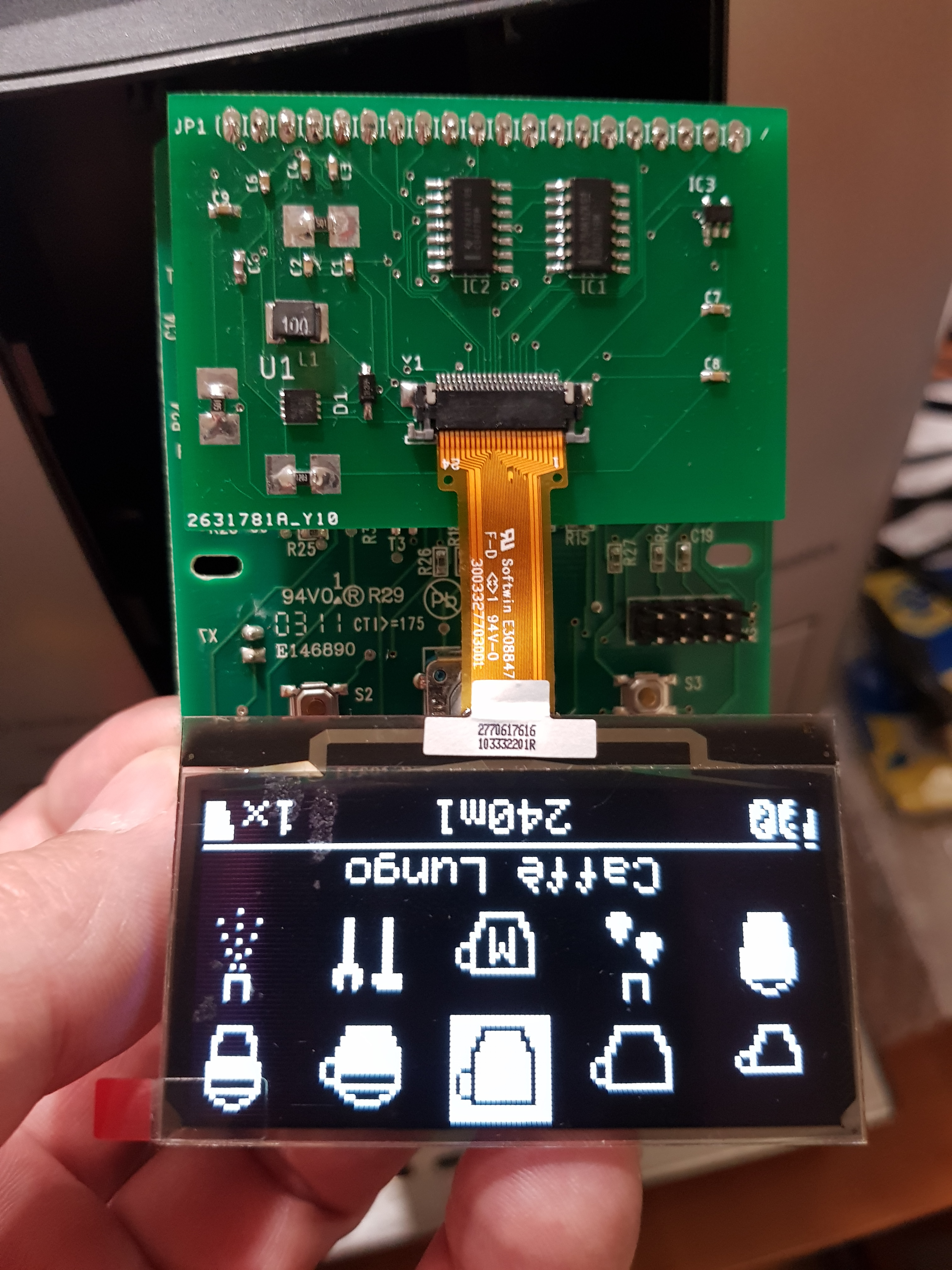

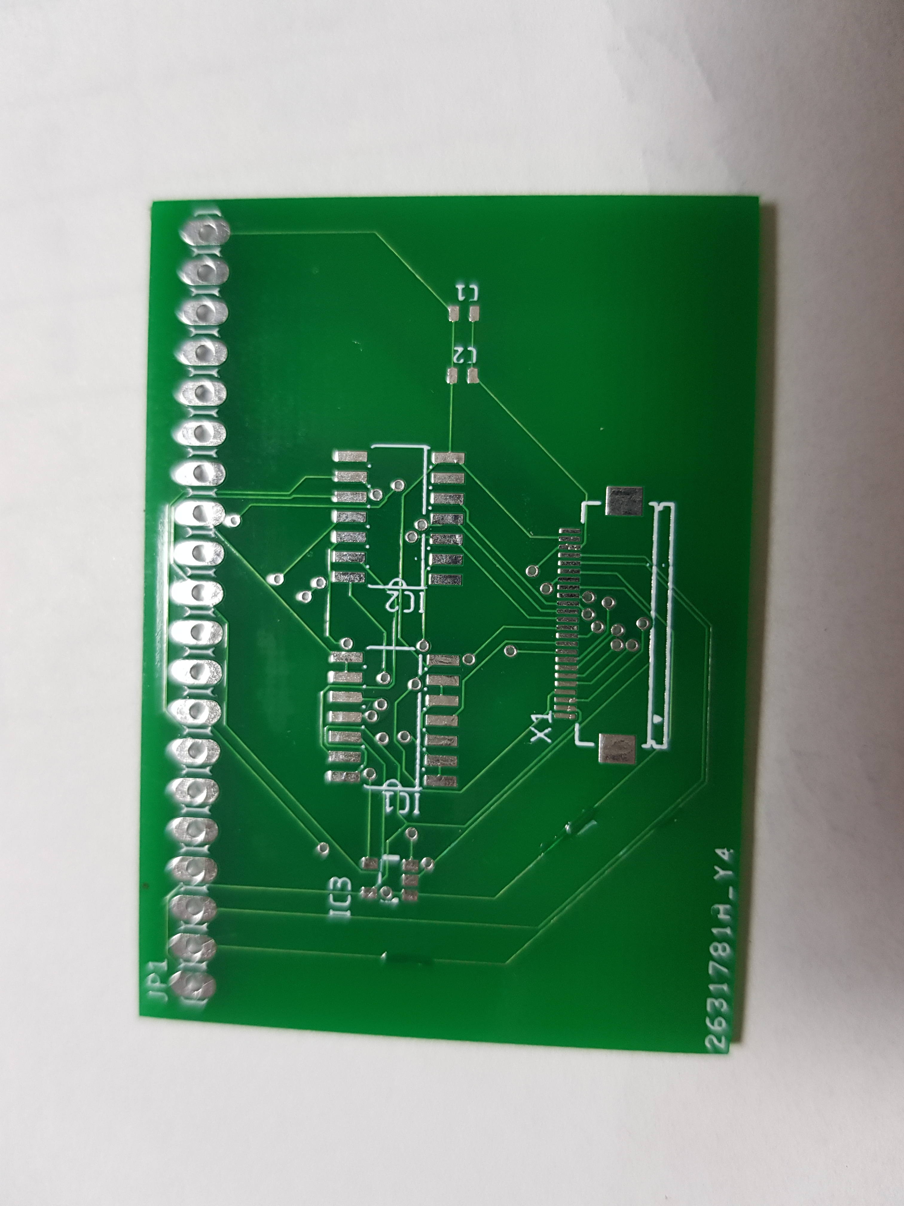

    I am after checking my concept and it looks like this:
    It is a plate with an inverted 20-pin connector. In the last project I threw tiles with a good joint setting but I have not ordered them yet. When properly set up, the electronics will be on the bottom as in the original, and the display on top. As you can see, the display must be turned over and therefore the need to reverse the JP1 connector. At the plate from this post you must reverse the connector 20 pin / cross / and it will be ok. Below in the pictures the above is the original, and below my project partly based on Satanistika scheme and praise him because without him this topic would not move.
    Later, when I find a moment, I will put it all together in the post and correct it ;) The most important thing is that it works and it is an alternative to the expensive original ;)

    I am glad that the project begins to live its life. I attach a revised plate with an inverted joint and elements from one side. NIVONA Caferomatica 830 Coffee Machine: Damaged Display Repair, AliExpress Replacement As for the break - it does not have to be a matter of display only the control method used in the meter. The espresso on each line addresses the new one using a special command, but there are several other modes.

How to flip the mirrored image on SSD1305/0301?
Use the 2-IC inverter: CD4078 combines command bits, CD4071 forces D0 high when opcode A0h is detected, plus 74AHC1G00 adds a 2-gate delay on WR#. Full schematic in post #18507781.
