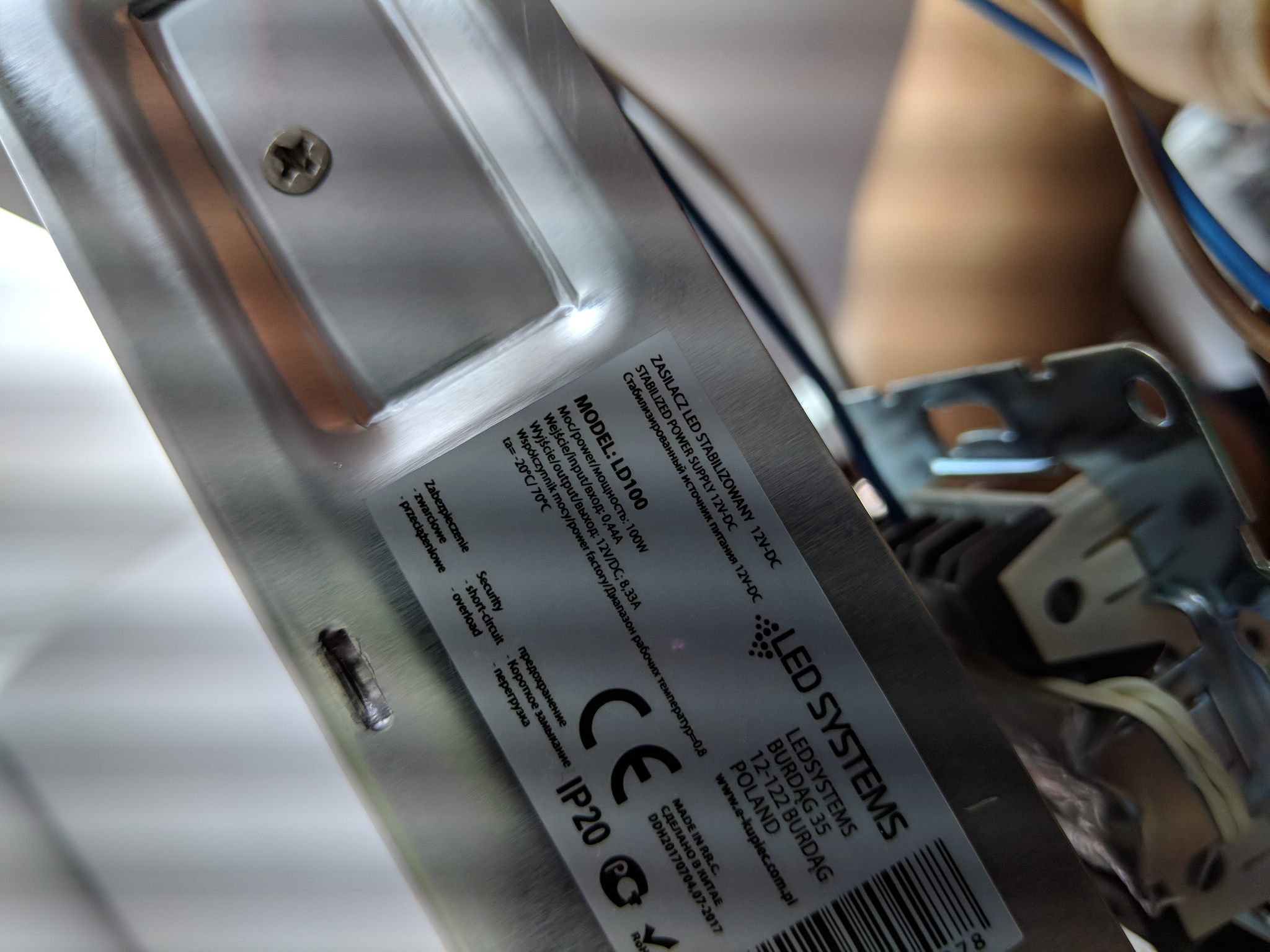

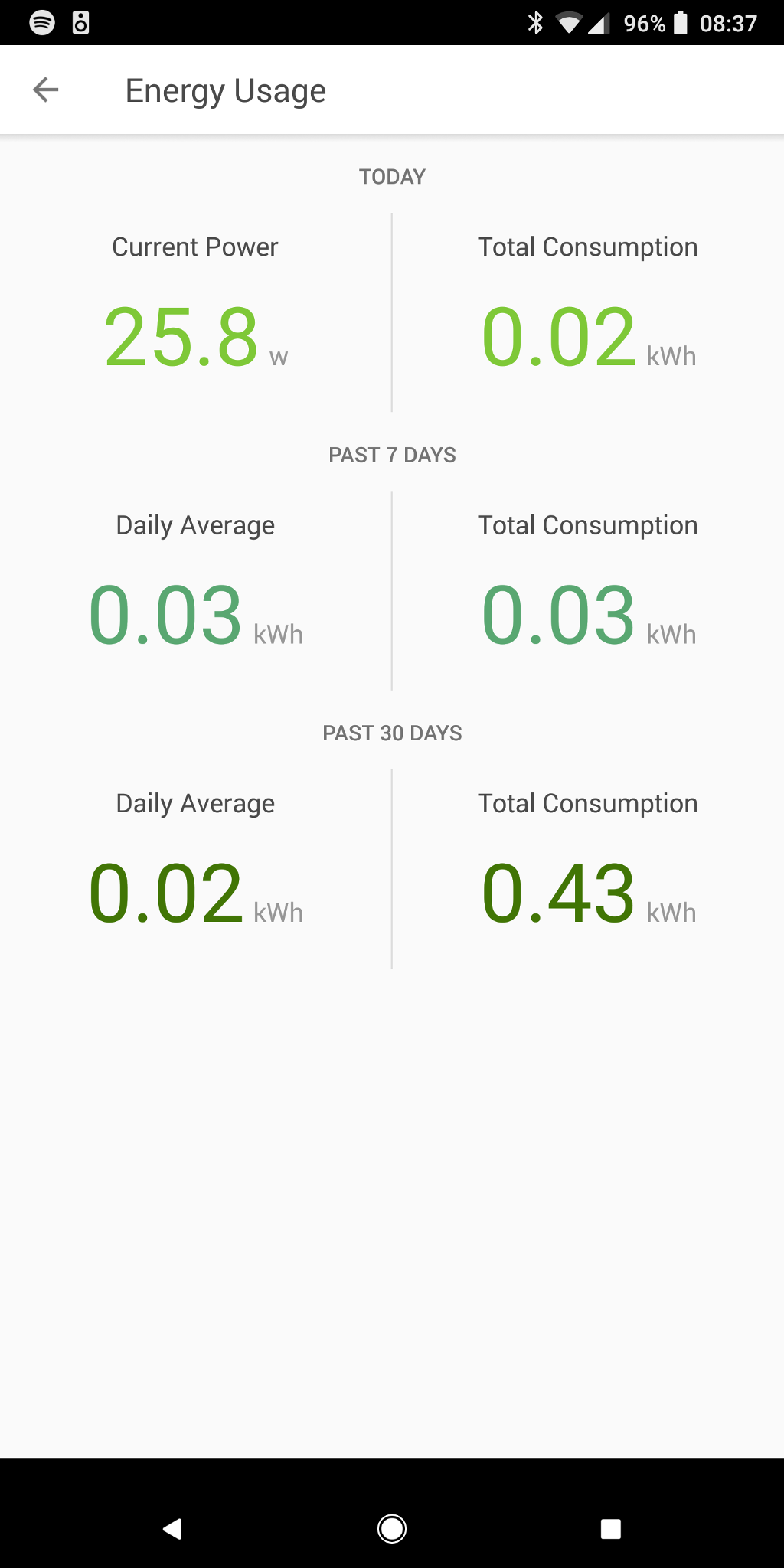

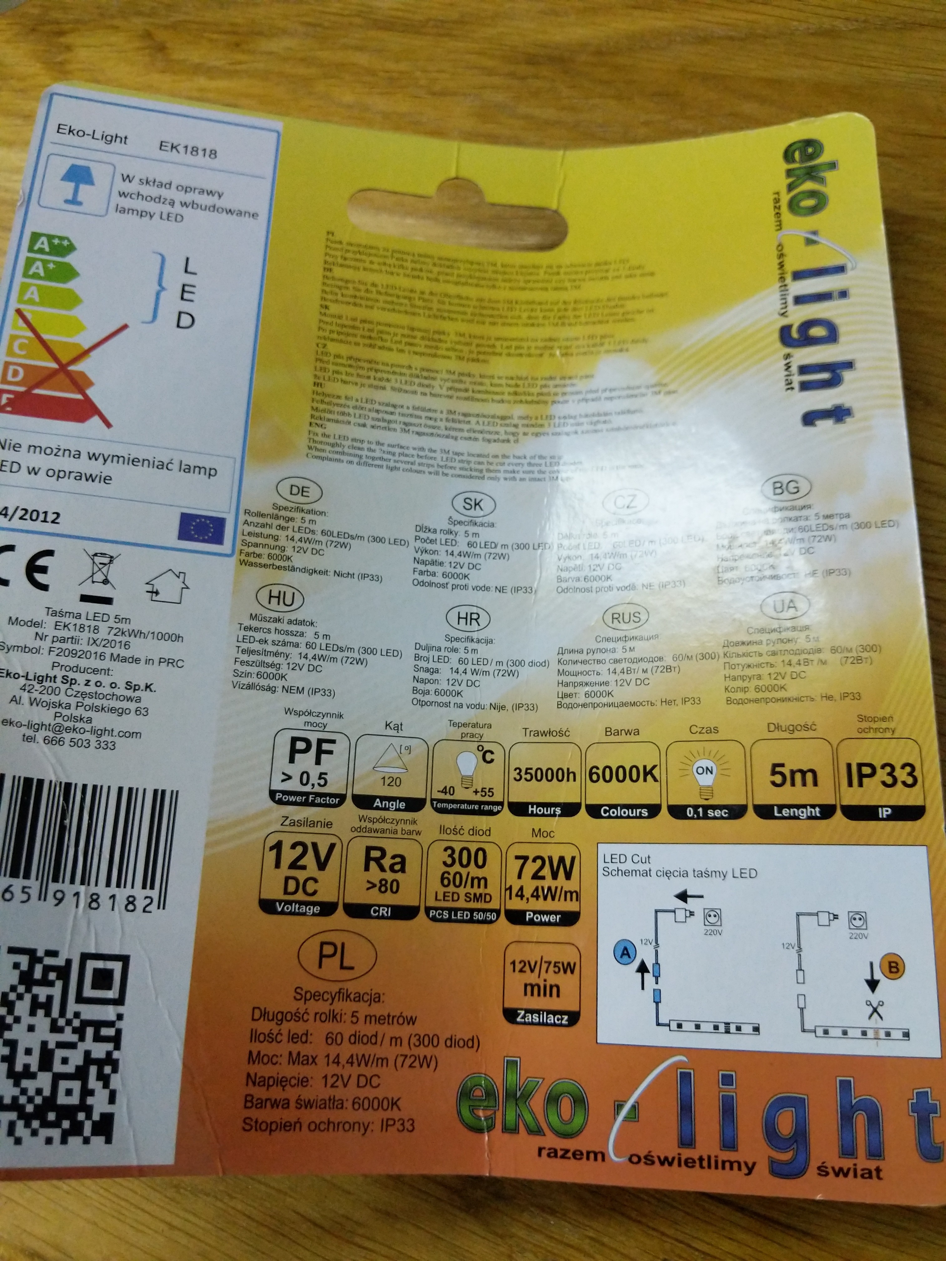

    I bought a 72W ribbon (14.4w/m, 300led / 5m, 5050) and a 100W LED power supply as a trial and connected to Fibaro RGBW via Smartthings. The connection is on one side only but it is 5m and there is no visible voltage drop.
    After checking the power consumption at 100% my 'smart plug' reports a consumption of 25.4W.
    Why 25W and not 72W?
    This means that I can connect my whole setup above on one Fibaro without RGBW amplifiers, because even 4 tapes will only consume 100W and not 288?

    Your "smart" plug measures the current consumption on the 230V side of the power supply, while you are interested in the current consumption of the LED strip on the 12V side (Fibaro RGBW load). Take a meter in your hand and measure the current consumption of the LEDs behind the power supply.
  • #9 17109272
    kood
    Posts: 1896
    Help: 259
    Rate: 443
    alster1 wrote:
    Your "smart" plug measures the current consumption on the 230V side of the power supply, while you are interested in the current consumption of the LED strip on the 12V side (Fibaro RGBW load). Take a meter in your hand and measure the current consumption of the LEDs already behind the power supply.
    From what he showed the plug shows not the current consumption but the power consumption. And upstream and downstream of the power supply should come out similar (upstream a little more due to the efficiency of the power supply)
    Probably the manufacturer of the LED strip overestimated the parameters, or the fibaro shows wrongly, but I would bet on the former.
