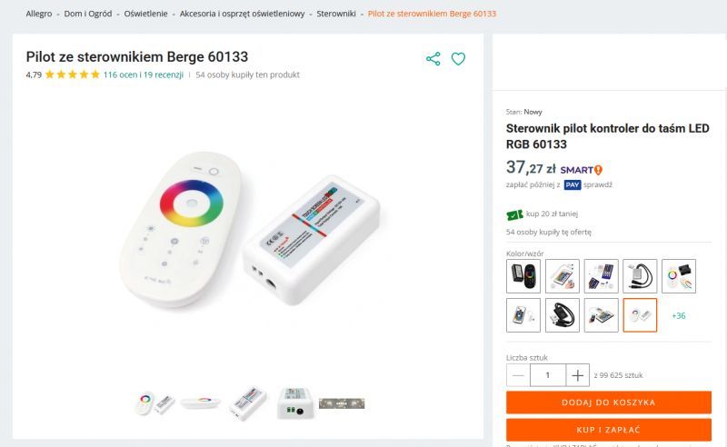

    You can buy the gadget for just under PLN40, but note that the LED strip is not included, nor is the power supply:
    RGB RGB LED strip 18A 216W driver EC79777 EC Light - interior, standby current consumption .
    Plus for the seller for showing the contents of the kit in the picture. Someone else would have put the whole thing with the LED strip on the picture and then non-reading buyers would have had a surprise that there was no strip included.
    Model according to the seller: 60133 Berge

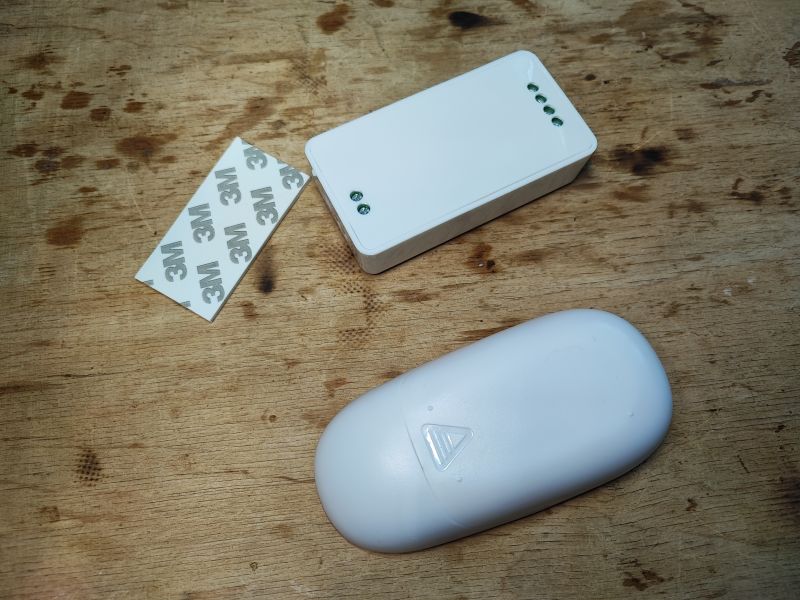

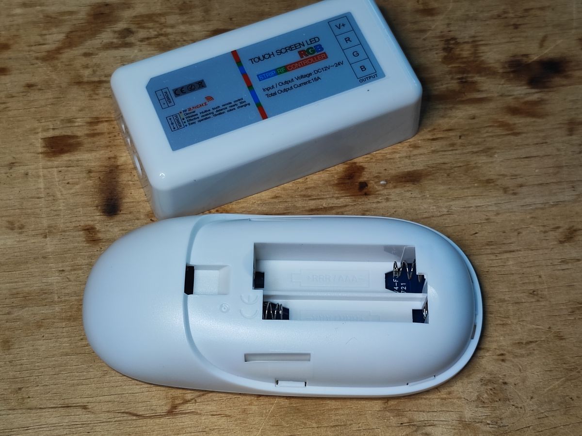

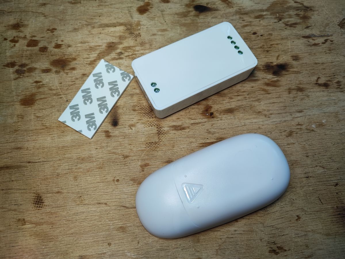

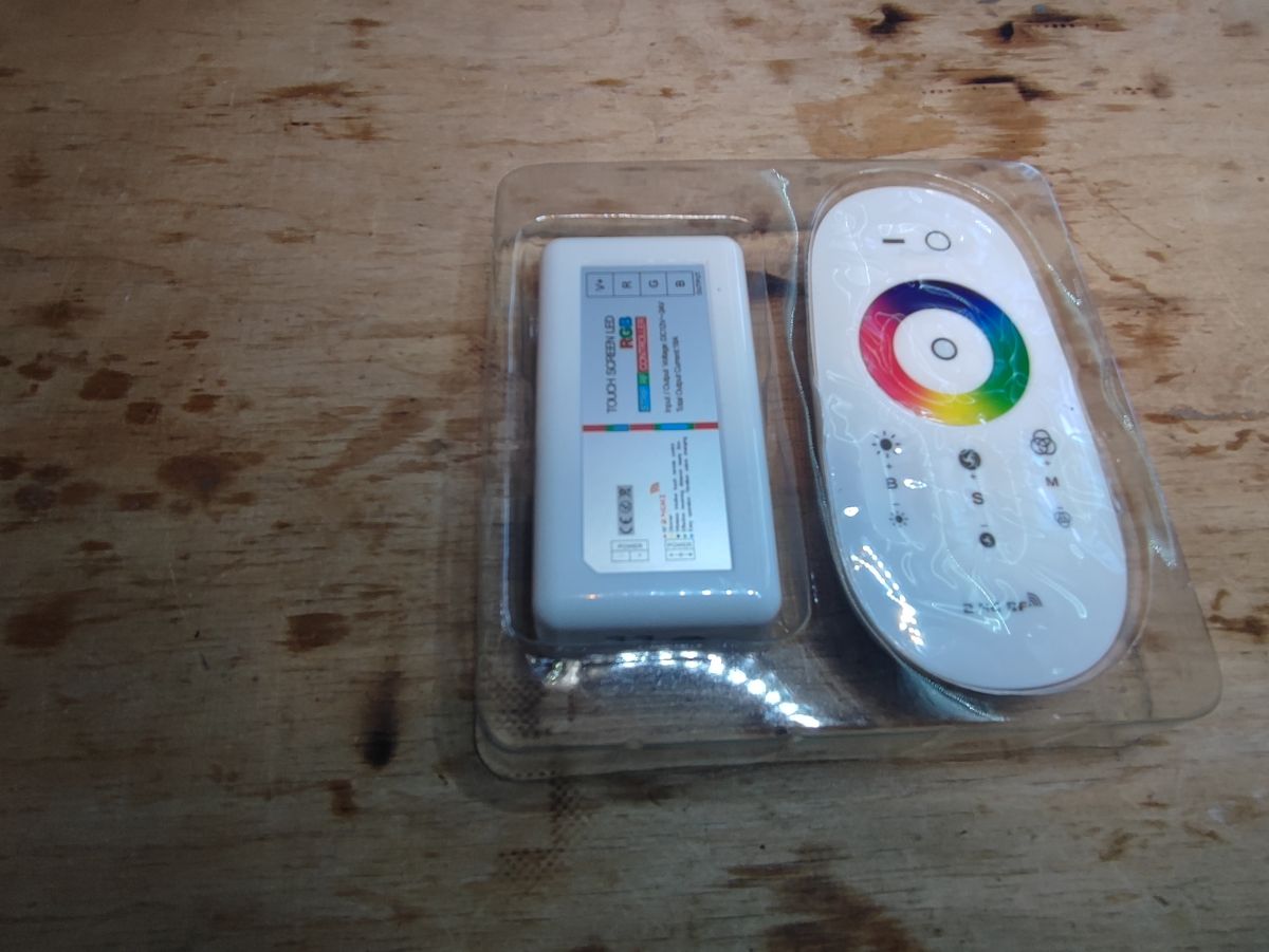

    Kit received:
    RGB RGB LED strip 18A 216W driver EC79777 EC Light - interior, standby current consumption RGB RGB LED strip 18A 216W driver EC79777 EC Light - interior, standby current consumption RGB RGB LED strip 18A 216W driver EC79777 EC Light - interior, standby current consumption .
    The seller has not forgotten the strip of double-sided tape, but the battery for the remote control is not included:

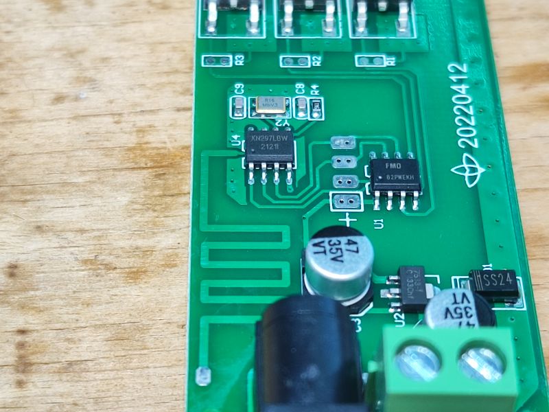

    I can at most measure the current in standby, i.e. when the LEDs are off:

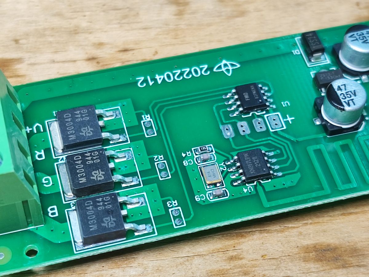

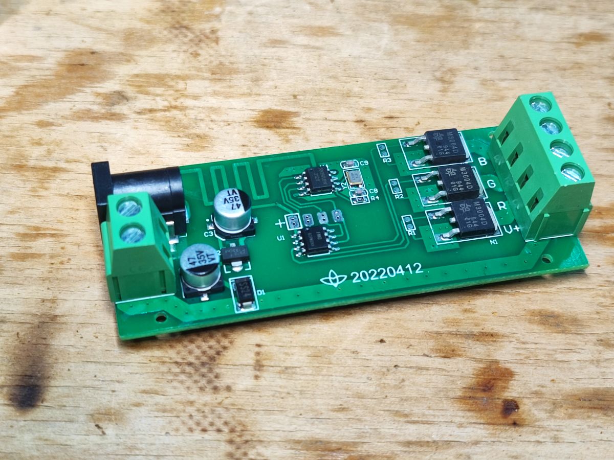

    Wait a minute, that 18mA is probably a bit much? But on the other hand... with 12V from the power supply it's not that much . Plus, inside, the manufacturer probably skimped on the step-down converter to power the RF receiver....

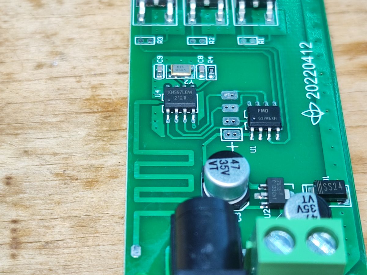

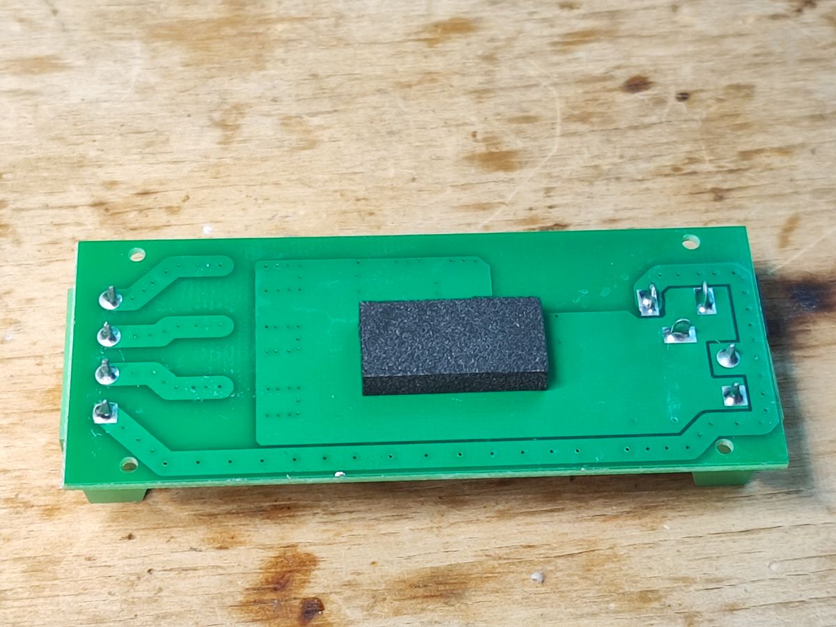

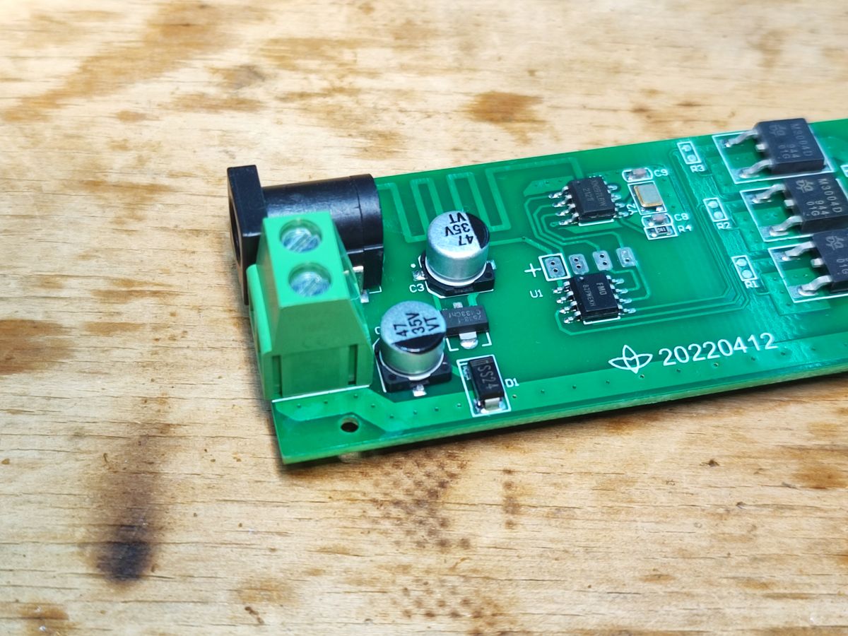

    And now we're looking inside, what's that thing in there going to pull those alleged 216W? That 216W is for the three channels together probably, 72W per channel?

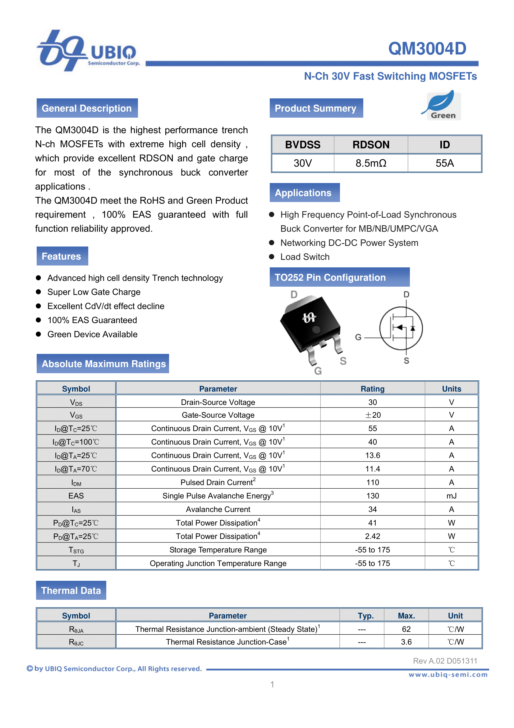

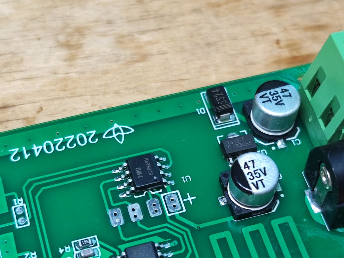

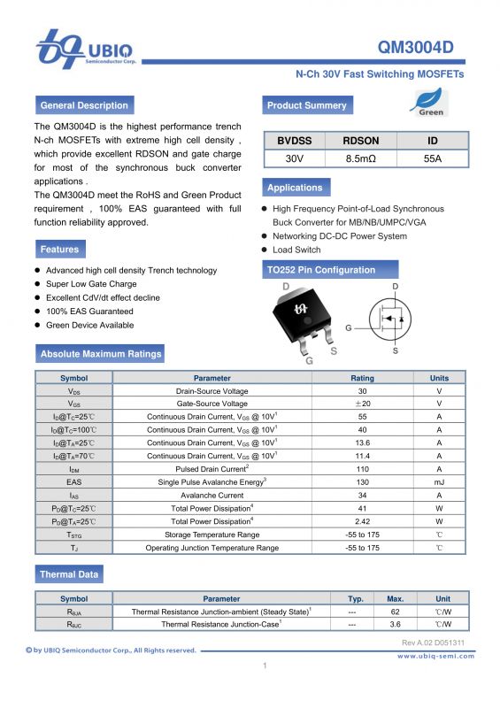

    In the power block is an LDO 7533 (3.3V?), not very efficient, I would prefer a step down inverter. XN297LBW is responsible for the RF, it controls the B2PWEKH. M3004D transistors used.
    RGB RGB LED strip 18A 216W driver EC79777 EC Light - interior, standby current consumption RGB RGB LED strip 18A 216W driver EC79777 EC Light - interior, standby current consumption RGB RGB LED strip 18A 216W driver EC79777 EC Light - interior, standby current consumption RGB RGB LED strip 18A 216W driver EC79777 EC Light - interior, standby current consumption RGB RGB LED strip 18A 216W driver EC79777 EC Light - interior, standby current consumption RGB RGB LED strip 18A 216W driver EC79777 EC Light - interior, standby current consumption .
    Indeed, not a bad MOSFET, only the heat dissipation in this product limps along.
    According to the instructions, this receiver is supposed to handle up to 6A per channel (18A from the title divided by 3). If so, with this drain current this controller can handle such a load.

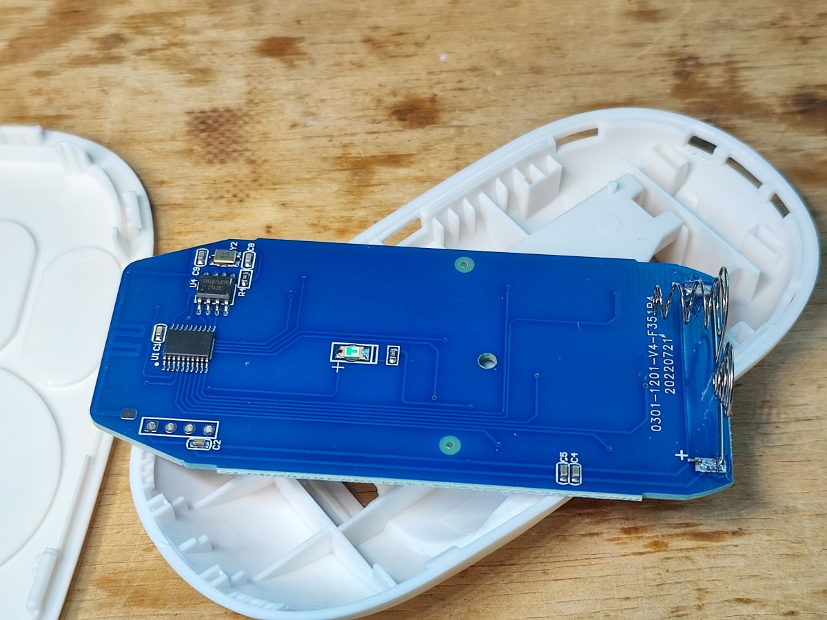

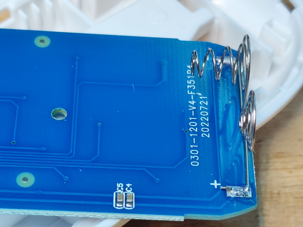

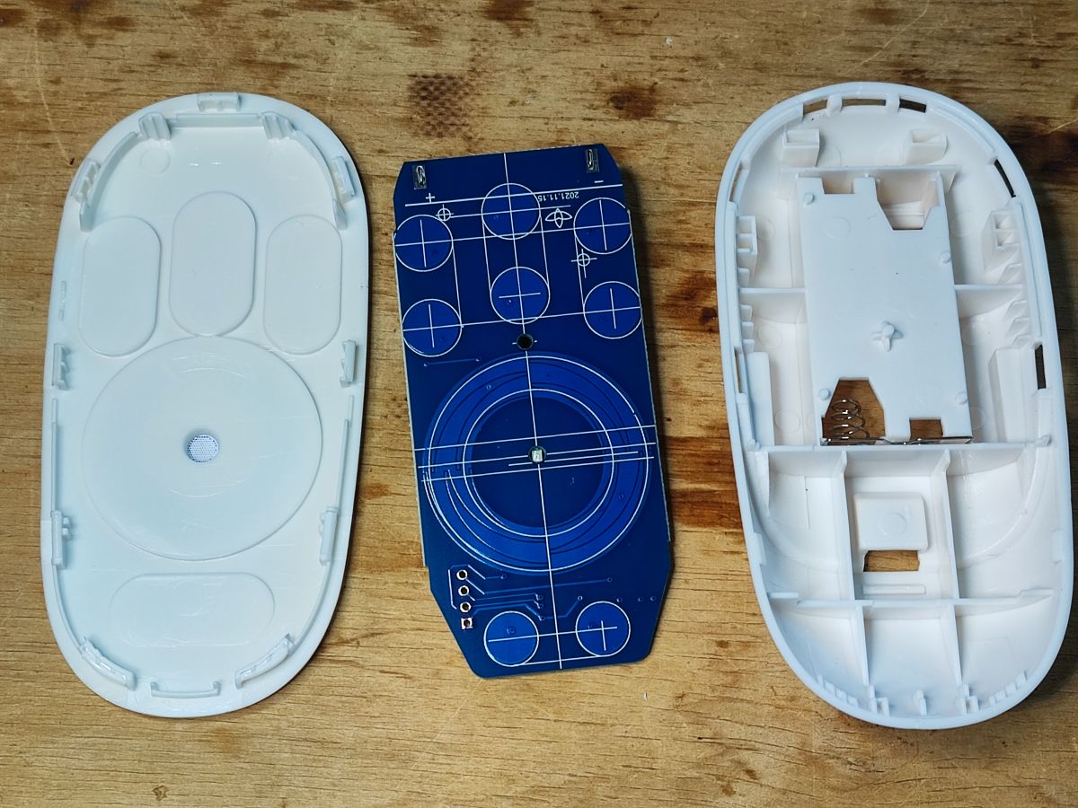

    Now, for the sake of principle, the inside of the remote control:
    PCB removal:

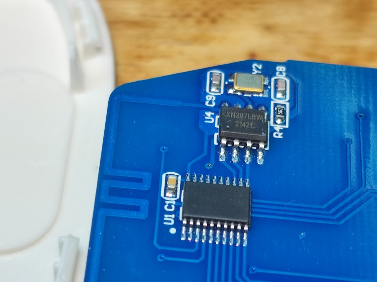

    The MCU in the remote control is not marked, but the RF transmitter is XN297LBW.
    As far as I can see the XN297LBW mentioned has already been discussed with us on the forum:
    2.4GHz RF modules on XN297LBW by piotr_go .
