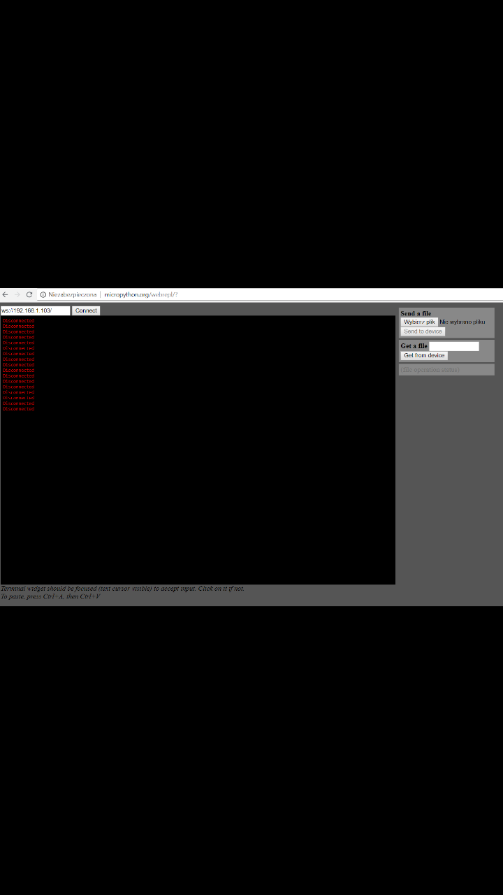

    Hello, I would like to program the esp8266 using micropython. I have uploaded the firmware, connected to my wifi network. I encountered a problem when trying to connect to the webrepl. I swapped the IP address to the one esp8266 has, the effects can be seen in the picture below. I would be grateful if someone could assist me with advice.
    • [ESP8266] I can't connect to WebREPL, what to do? Screenshot_2018-07-16-18-20-03-938_android.png (29.08 KB) You must be logged in to download this attachment.

    I'd start by adding the port to the IP address, as it shows up in the address bar when you enable this site. ws://192.168.1.103:8266/ if you haven't changed anything. I don't know exactly what principle this page works on, but since you used a network internal address as a suggestion, it should interact with one as I wrote without any problem. Well, unless you changed the port on which ESP communicates, but I don't think so.

    Thanks for the feedback. I have not changed anything. So will try to assign a port to the IP address.
