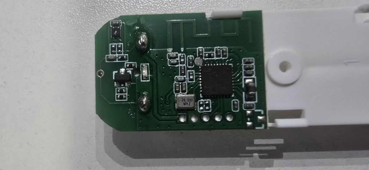

    Hey guys I receive 2 of them but the chineses they erase the chip info
    I have no ideia wich one is that
    I check the point with the pinout of the chip and I have it.
    PCB with labeled pins 3.3V, GND, guessed RX, TX, and CEN connections
    I cannot find ground at the chip, just on the battery

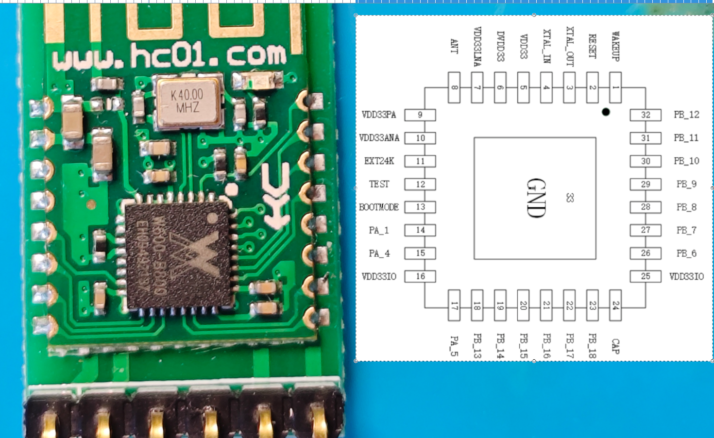

    Both Beken and ESP seems to have UART in the same pins row as crystal (oscillator), so probably it's not them... have you tried to receive anything from UART via USB to UART converter?
    This is also not T34, as T34 has built-in crystal.
    Also not W600, crystal does not match...
    Bluetooth module HC with Beken BK8000L chip and microcontroller pinout diagram
    I would suggest looking at crystal pins (XO, XI) and checking pinouts of known chips one by one

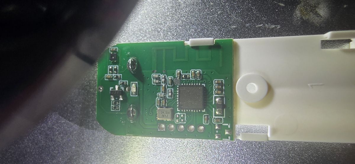

    Can you make a better picture, without the lines ab that reflection? preferably on a darker surface as not all the pins are visible?
    What I can say with certainty this is not TRS6260 or ECR6600, one potential candidate is W800 or BL602 but I need some better pictures to confirm (maybe multiple pictures would be best)

    Hey buddy, it's enough?
    I also try to use bl to read fw no success

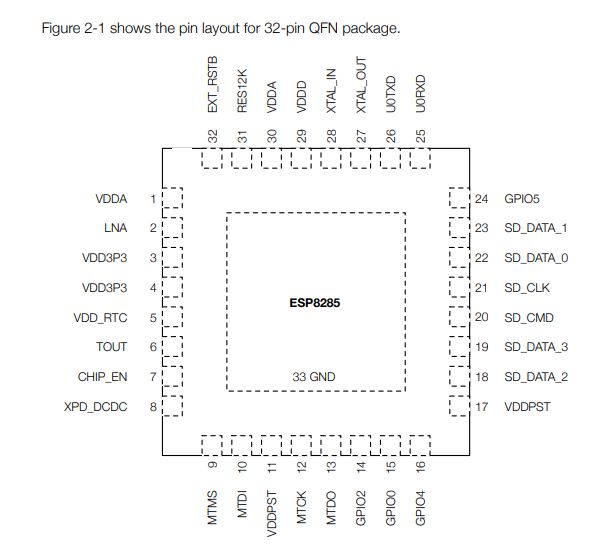

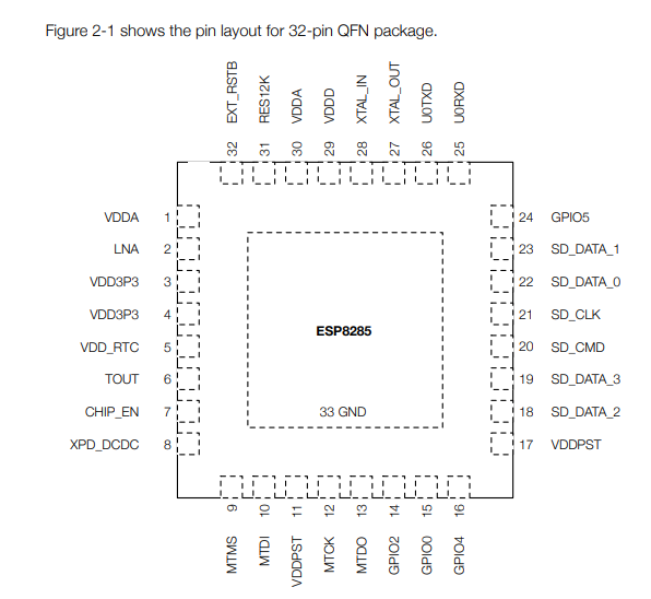

    ESP8285?
  • #6 21819045
    Posts: 14771
    Rate: 12914

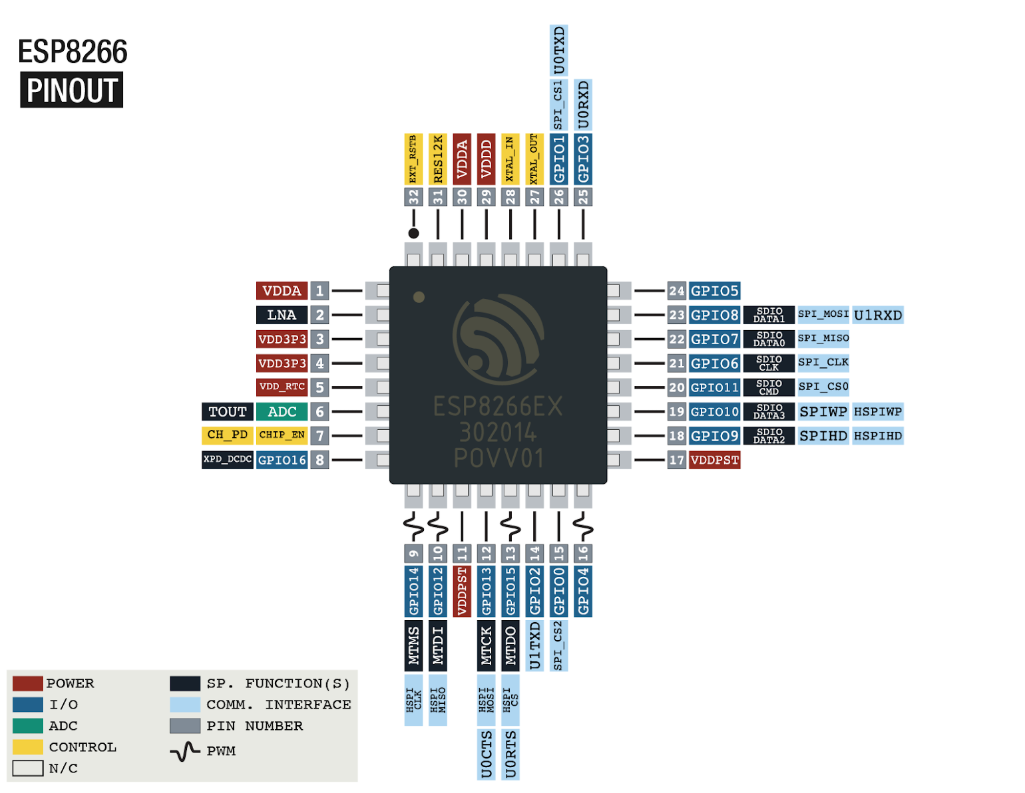

    ESP8285 has same pinout as ESP8266?
    ESP8285 QFN-32 pinout diagram with labeled pins and pin numbers around the package outline
    ESP8266EX pinout diagram with labeled functions and pin numbers
    XTAL does not match.

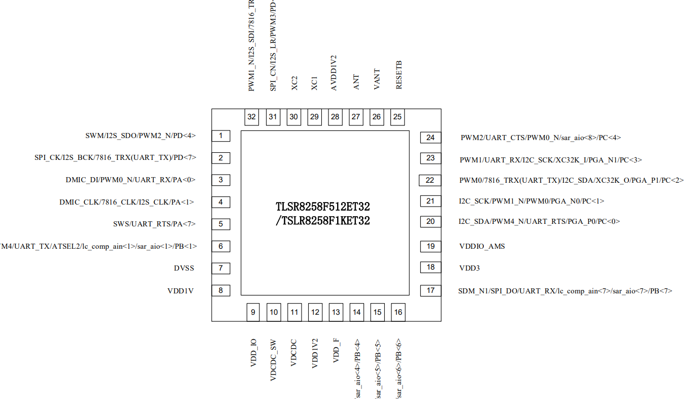

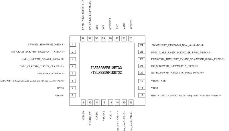

    Hey, ,maybe TLSR8258?
    Pinout diagram of TLSR8258F512ET32 microcontroller in 32-pin package.

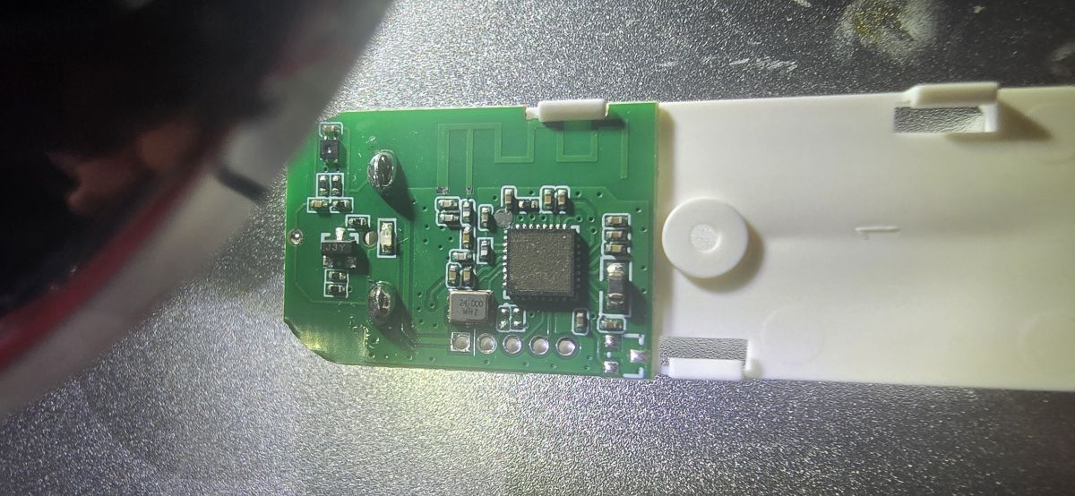

    Looks like the pin 1 it's close the cristal. I just wake up now. I'll check more pins to map it. Why this fck guys erase this cheap stuffs.
  • #8 21819134
    Posts: 14771
    Rate: 12914
    There are two pins befor crystal, so TLSR8258 matches in that regard.

    Gosh I bought wifi, they send me zigbee. I just recheck aliexpress. It's wifi there, but you are true, came zigbee. Gosh. I need to start use zigbee
