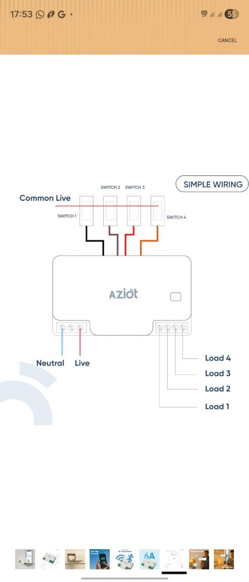

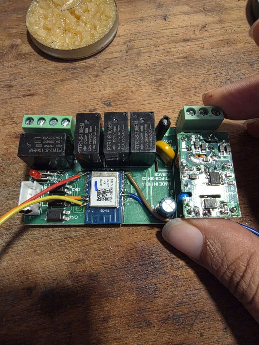

    I am using a Tuya T1-3S 4-gang switch module with BK7238 and flashed OpenBeken 1.18.247.
    Relay control via UI/MQTT works correctly, but physical wall switches do not work.
    Hardware details:
    Module: T1-3S
    MCU: BK7238
    Switch wiring: Common LIVE (active-HIGH)
    Original Tuya firmware worked fine with this wiring.

    My switches are wired as Active-HIGH (LIVE → switch → GPIO).
    BK7238 seems to only support internal pull-UP, not pull-DOWN.
    Because of this:
    GPIO idle state floats or stays HIGH
    No stable LOW state exists
    Long-press condition is triggered permanently

    AZIoT electric module in compact casing with labeled terminals and size 91x50x22 mm Wiring diagram of AZIOT controller with 4 switches and 4 loads connected

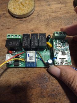

    Managed to flash it
    Electronic board with relays and Wi-Fi module on a wooden surface

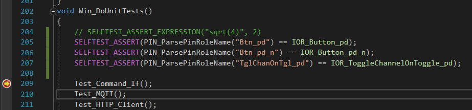

    Are you sure? It passes self test for me:
    C code fragment with unit test function and SELFTEST_ASSERT calls
    I will try to investigate futher tomorrow.
    Added after 6 [hours] 16 [minutes]:
    Ahhh, I see a problem. I updated the PR.
  • #9 21817672
