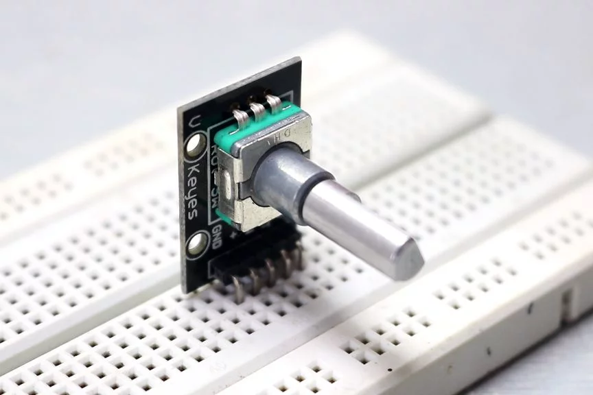

    Step 2. Introduction
    Such an encoder is an electromechanical device that translates the angular position or rotation of an axis into a digital or analog output signal. There are two types of rotary encoders:
    1) Absolute - The output state of this encoder corresponds exactly to the absolute position of the axis. Thus it is an angle converter.
    2) Incremental - the signals at the output of this encoder correspond to the axis movements, so the position calculated on their basis is relative. Processing these signals into data on position, rotational speed, etc. is always carried out remotely.
    How to use a pulser (pulse encoder) connected to an Arduino
    Step 3. What is an incremental rotary encoder
    The incremental encoder gives information about changing the position and its direction (clockwise and counterclockwise rotation). In many applications this functionality is essential, however, this element does not track the absolute position. Therefore, in some encoder applications, it may be necessary to initialize the encoder by moving it to a known, fixed position.
    Step 4. Construction and principle of operation
    An exemplary encoder that we will use in the tutorial has all the necessary resistors that pull the I / O lines. This element has five output pins:
    Clock, Data, Switch, Vcc, GND.
    Construction
    The knob we turn is internally connected to the disk inside the encoder. It will move clockwise or counterclockwise, just like the knob that the user turns. On the surface of this disk there are fields connected to the power line. The remainder of the disk is at ground potential. Above the disk there are two contacts shifted relative to each other by a certain distance - these are the outputs of the Clock and Data.
    Principle of operation
    When we turn the encoder, the state of the outputs will change with the position of the disk in the encoder. In such a situation, we can observe sequences of impulses on the Clock and Data outputs.
    If we look at these impulses, we can see that they are out of phase by 90 degrees. If the encoder turns clockwise, the clock output pulses will be first, and if the encoder turns counter-clockwise, the first pulse will be shown at the data output.
    By analyzing the state change on these two outputs, you can immediately judge which direction the encoder knob is turning. Now let's try to implement this analysis programmatically in Arduino.

    These algorithms from the article, unfortunately, are bad and would turn out to be a fraction of what's below ...
    In my project in C on Atmega32 clocked at 16MHz as of today (because the project is being developed all the time) it supports:
    - 2x 1600imp / rev encoder with a speed of max 15 rev / s,
    - 2x encoder 10imp / rev with vmax 10000 rev / min,
    - 1x encoder 25imp / rev with vmax 1000 rev / min,
    - two programmable independently regulated pulse generators,
    - buttons,
    Plus a lot of math operations, adc reading, lcd buffer support, etc.
    Nothing is lost, nothing is cut, everything counts ... Libraries, of course, their own.

    In professional devices, a preliminary filter is often used to remove the effects of vibration of the rotary encoder contacts, e.g. something like this:
    The circuit shown above was applied to each encoder in the circuit, and each four encoders were read by the HCT165 parallel-serial register, i.e. by polling. In addition, the device also detected the mere touch of the metallized encoder knob, which resulted in the highlighting of the changed size on the screen.
    Depending on the type of encoder used in the circuit, only the values of the filtering capacitors C1 and C2 (from 1n to 10n) changed.
    I don't know how often these encoders were polled, but probably 20-30 times per second (the encoders were of the 24 pulses per revolution type).
