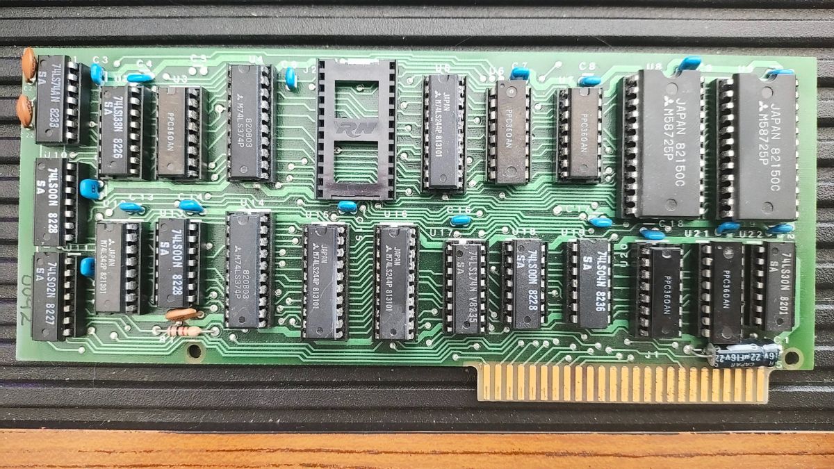

    To compile the program, all they had to do was use one of the many assemblers, or better still macro assemblers, available for that platform.
    Construct a suitable card to provide connectivity to the Atari 2600 console and create specialised software.
    A 4 kB of RAM was inserted into the card built in the Apple II, which was shared between the Atari console and the Apple II computer, whose job was to emulate the cartridge memory.
    Any change to the contents of the memory was immediately visible to both the Apple II and the Atari 2600. In addition, the card provided access to all hardware registers in the console, so that it was possible, for example, to create sprites and immediately observe their effect on the screen generated on the console, debug program memory, etc. etc.

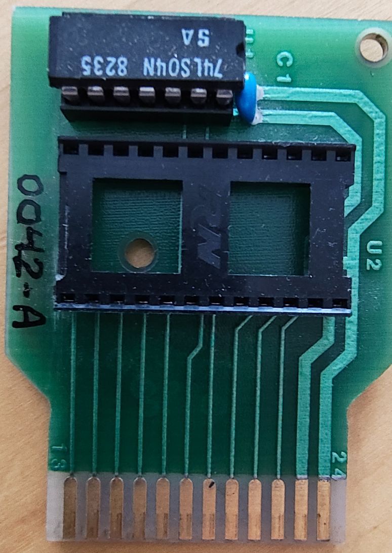

    In addition to this, ready-made cartridge circuit boards could be purchased, into which it was sufficient to insert a programmed EPROM, as well as an EPROM programmer for the Apple II.
    So that the whole system from the idea to producing your game cartridge could be had on your desk. ;) .
